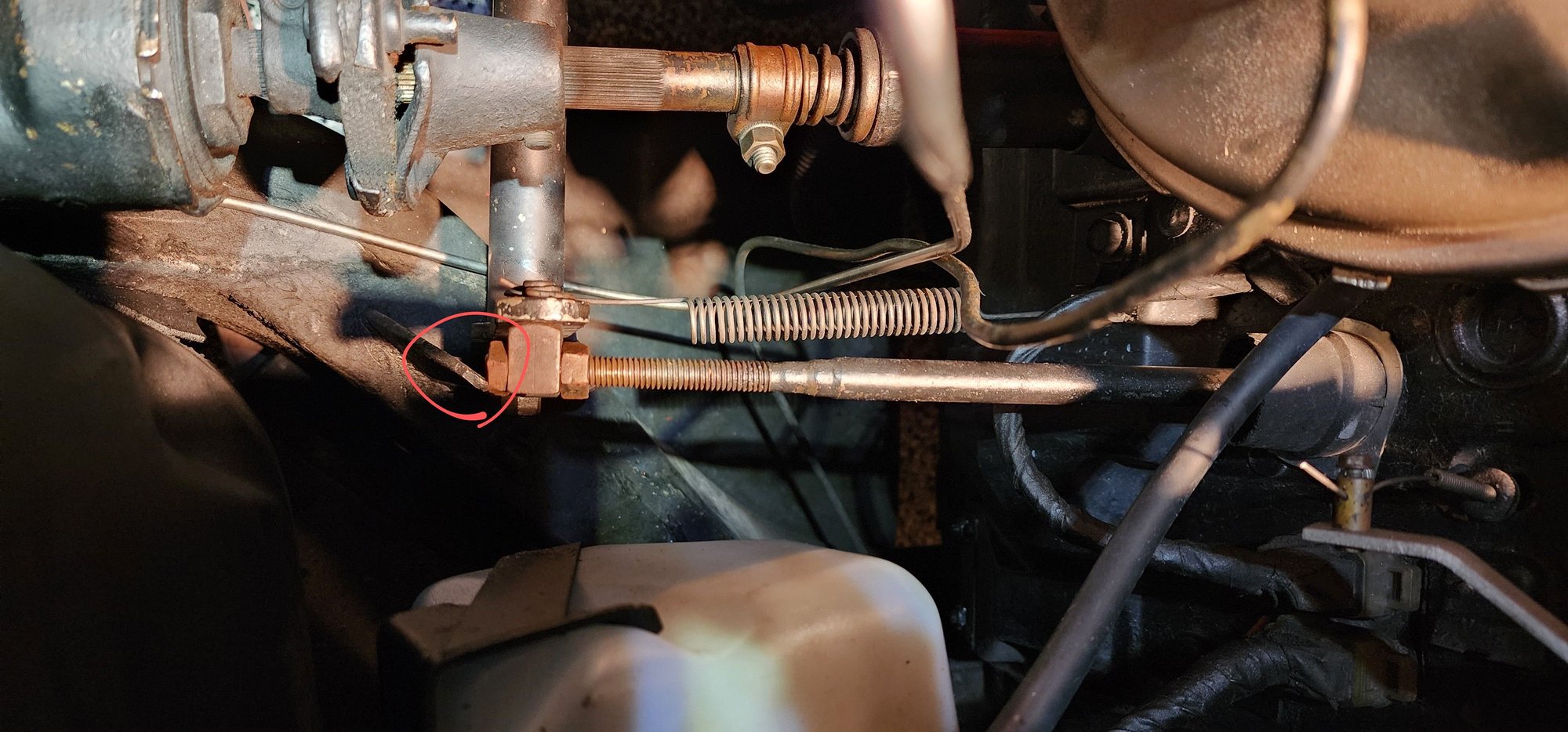

So its all together, cranked up and... its different (which is to be expected. The clutch pedal has to be on the ground for it work. A lot of play so to speak. Any tips on getting linkage tighter? Doesn't appear to be "anything left" in the linkage unless I'm thinking about this backwards.

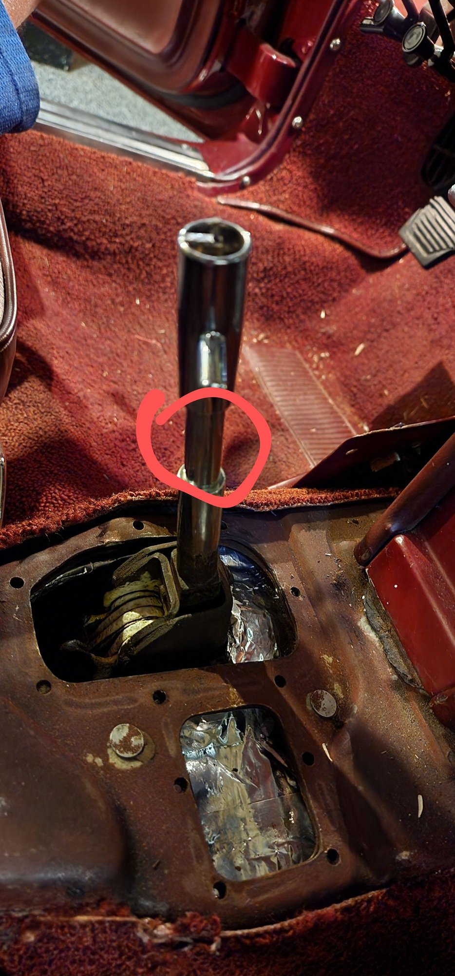

Also, how do you put this shifter back together? dang I didn't pay close enough attention I guess. The sleeve/insert wont drop down all the way.
