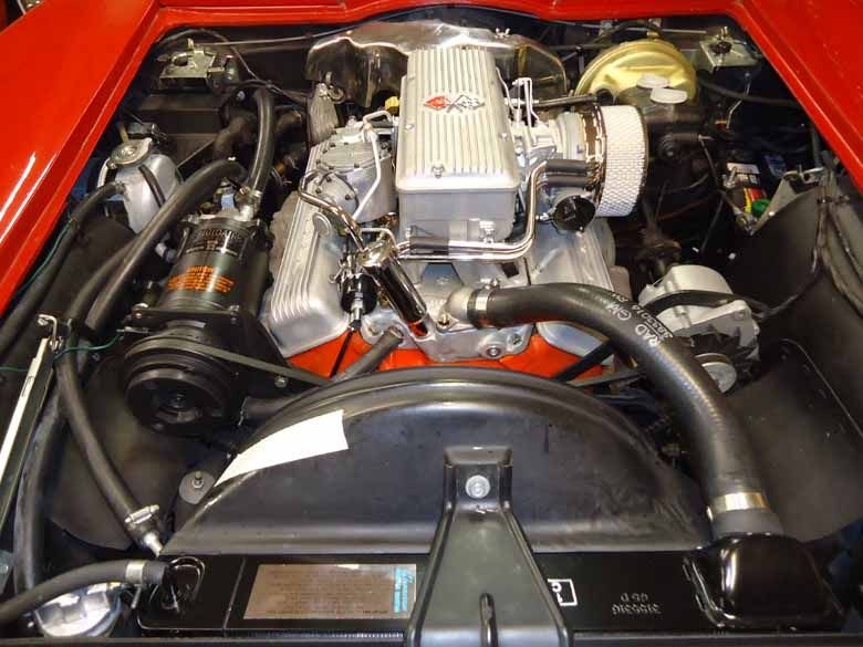

Originally Posted by Chalie M
Thanks for update. I believe this was one of the past posts I saw on this topic VERY clean set-up ….. Can the O.E. Mechanical fan still be used or is one forced to go to a electric fan..
Thanks Again
We originally had the OE fan on (as shown in the pic), but I didn’t like the way it cooled, so we took it off and went with a thermostat controlled electric puller fan. Worked great, never had a cooling problem. This car also had an in-tank mounted electric fuel pump that eliminated the need for the hot engine mounted pump, thus feeding cooler fuel to the injection. The car also has Steeroids rack and pinion power steering.
