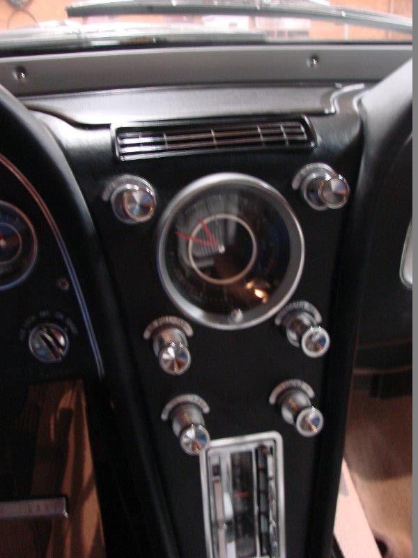

I had the center vent installed on my original dash. The installer, who has done this many times, did not even have to pull the dash out.
I also had the factory A/C controls added to the dash, so it "looks" like a factory A/C car. Yes, it was a bit expensive, but well worth it in my opinion.
We also modified the Vintage Air controls so that the dash switches controlled the A/C system. One of the controls was added just for looks, as it does nothing.
One thing that got my attention when I was deciding how to install this system was the comments by other users about how the Vintage Air lower dash vents blew cold air directly onto the legs of the driver and passenger. Some people even modified the vents to redirect the air more toward the body.
I decided that I wanted it to look as factory correct as possible, and also give me some cold air directed at my body.
But it is not exactly cheap. I am thinking, without actually checking the receipts, that adding the center vent cost my in the neighborhood of an additional $700 - $800 (parts and labor). Repo center vents are not exactly cheap.
It will work fine without the center vent, but I personally think that it adds to the overall appearance of the car. And the center vent definitely adds cold air directed where I want it to go.
Best of luck in whatever direction you decide to go. Let me know if I can assist in any way.

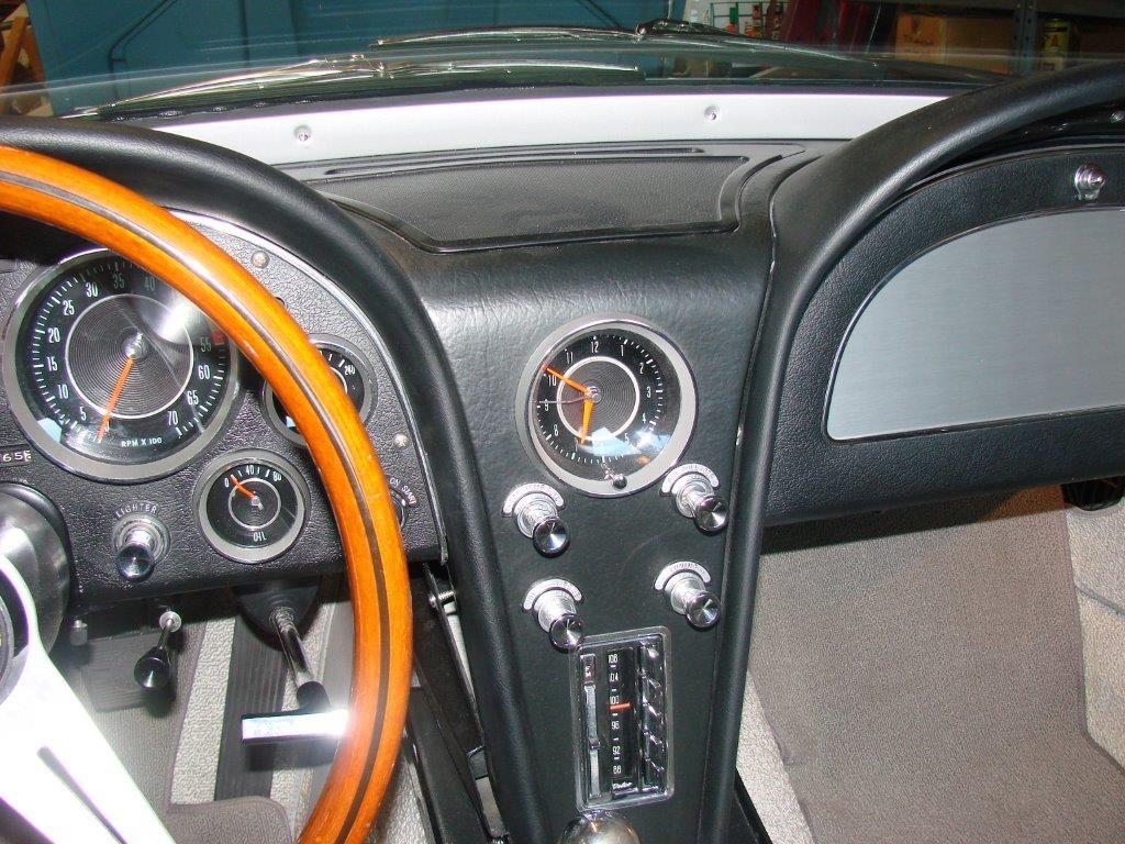

Before the conversion on my 64 coupe
Before Vintage Air installation
After photo
