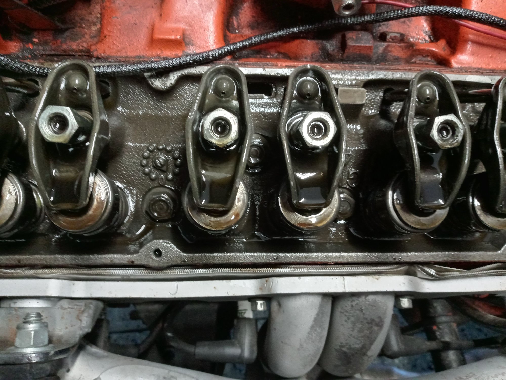

well after removing my valve covers it appears that i have solid lifters or someone put poly locks on on the rockers-it also looks like i have different heads on this #3917291-d77 is stamped.
with out any info on what settings this needs what do you recommend?

PolyLoks can be used with either solid or hydraulic lifters. So their presence doesn't signify anything in particular.

Based on the intake and heads, highly doubtful it has solid lifters. Easy enough to test though and you can usually hear the difference.

Being 77 heads they have to be one of the worst heads GM ever casted. So really is your engine
77 heads? He has 291s that were cast on April 7, 1967. 64 cc chambers. Either 1.94 or 2.02 valves. Pretty decent heads, I would say.

291 heads were GM parts replacements for just about any of the early 2.02/1.60 units.
You should pull the Manifold and see what you have, 695 top oiling type solid lifters or 585 top limited oiling type solid lifers. As you have roller tip type rockers, I would run the 695 or comparable type lifters as they aren't full rollers. The adjustments are more determined by the camshaft, so you will need to ID that.

Measure the current lash adjustments both intake and exhaust, Then maintain that lash setting….. (if you find a few that are looser than most, just adjust them to the “majority”). Who knows what’s in the engine? Could be a 097 cam, could be a 30-30, could be some aftermarket thing.

Think the "adjusting them all the time" came from one of two things
-Not being adjusted properly in the first place
-Using the factory nuts over and over..you can ( Ihave) but they are supposedly 1 time use pieces
they can get loose over time. Probably why the guy put those polylocks on there bet that lash never budges.
Like adjusting solids with the engine stone cold, 1 cyl at a time. EOIC method..takes longer but its foolproof.

If you have clearance between the rocker too and the valve stem you may have solids. If not you surely have hydraulics.
