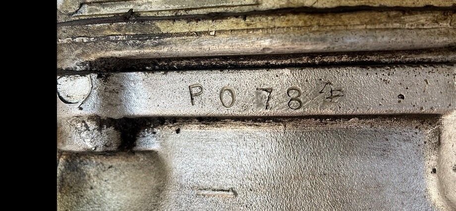

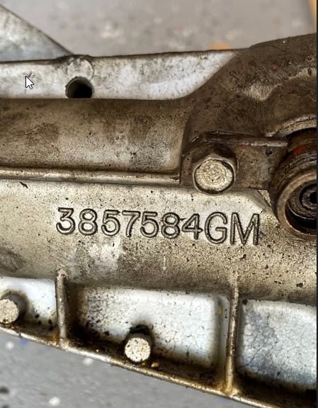

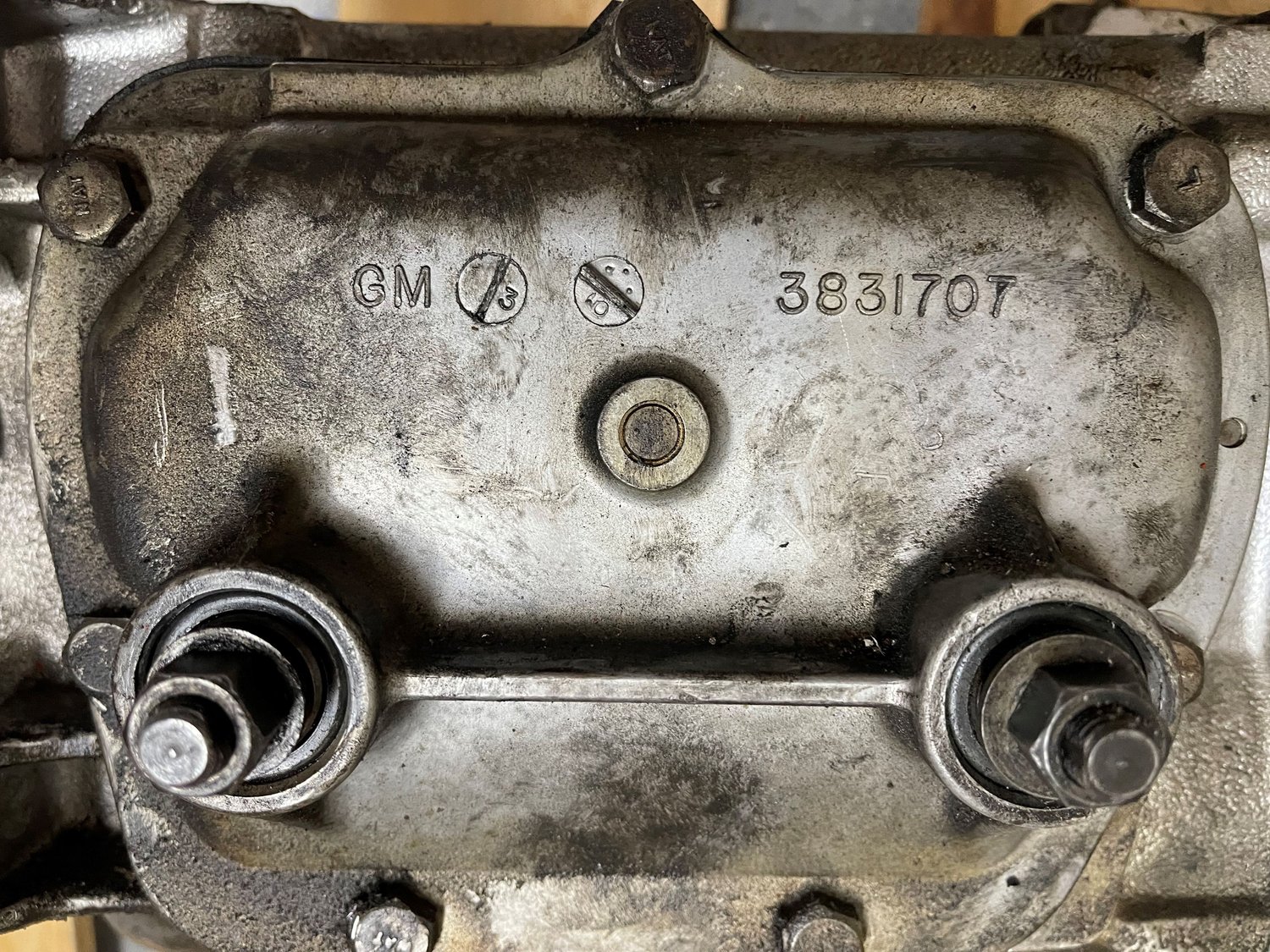

I am in the middle of a Muncie to TKX swap. My 64 is really a Frankenstein for a variety of reason including a 68 327 Vette motor and I was always curious about the transmission. It was really great the whole time, I just wanted the 5th gear.
I looked on line and there is a bunch of conflicting things that I read so I will ask you guys.....It seems to be an original 64, but what say you? The date code really throws me for a loop.

Sorry, there ain't enough info and pictures.
The 325 main case is 64-65.
The 584 tail housing is a mid-65/70.
The STAMPED code is of no help.

I’ll only ad a guess that the case is a 65 because of where the assembly date is stamped.

The serial number is really strange. I can't tell if it's a "D" or what. That seems consistent with the 67-68's from what I read. Is there anything else I should be looking at on the transmission casting/stamping-wise?

jkuzzy,
I have a 50" monitor on my home computer so I can really zoom in on this stuff. On high magnification the third digit looks quite clearly like a "7" (correct for July) that has either deliberately or accidentally been altered. I've tried to clean it up in this pic so you can see what I see. The font and size of the "7" look correct and it's much easier to see without the extra markings:
Trouble is the last digit looks like a "4" and no matter which Muncie format you use, the early or the later one, "84" just will not come up as a day of the month. My guess? Probably a genuine mis-stamp.
Jeff,
That's not the serial number...that looks like a poor attempt at an assembly date and it makes no sense to me, either. Below is a pic of what an assembly date should look like. Look, also, for the partial VIN stamped on the driver's side of the case just aft of the side cover.

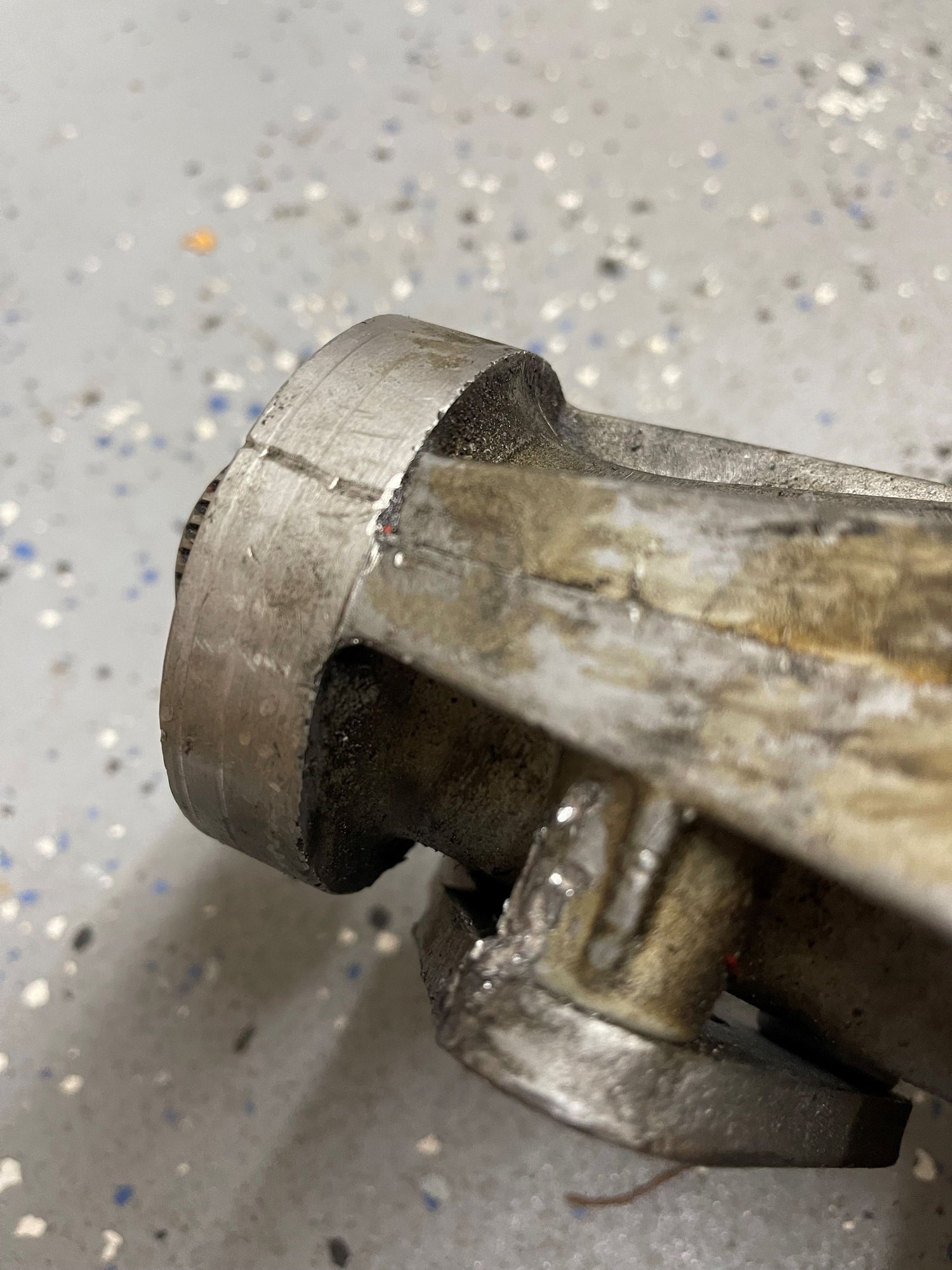

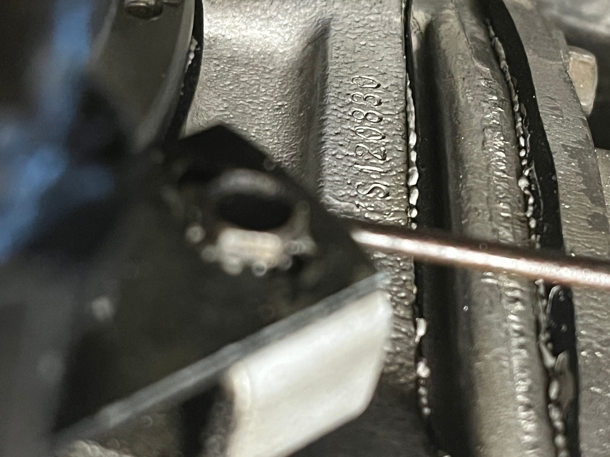

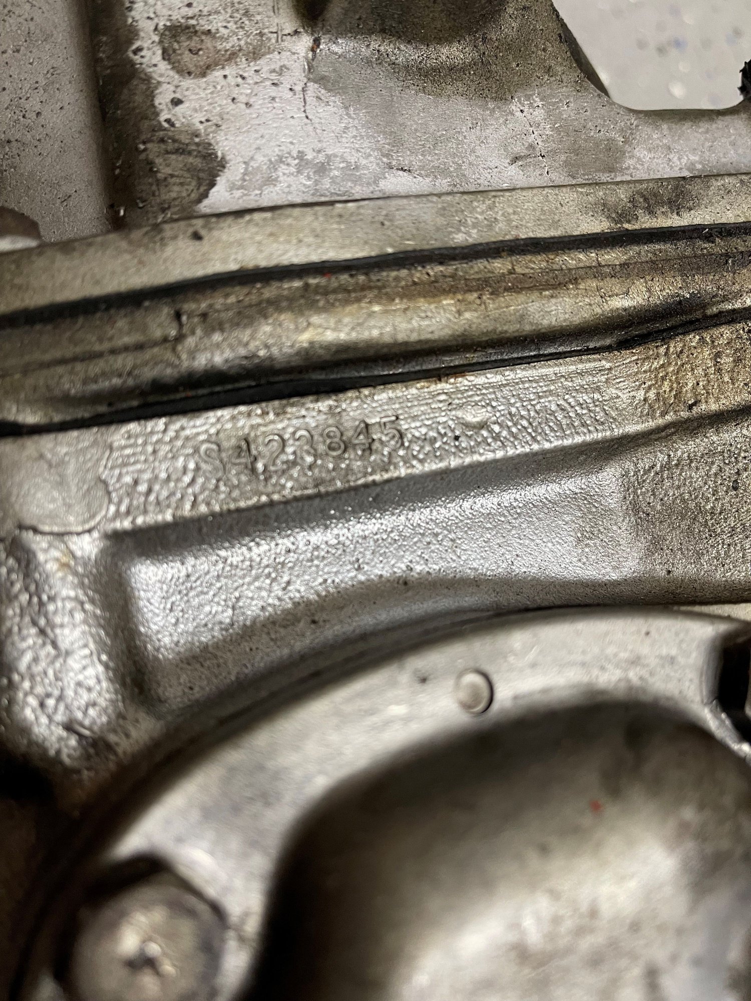

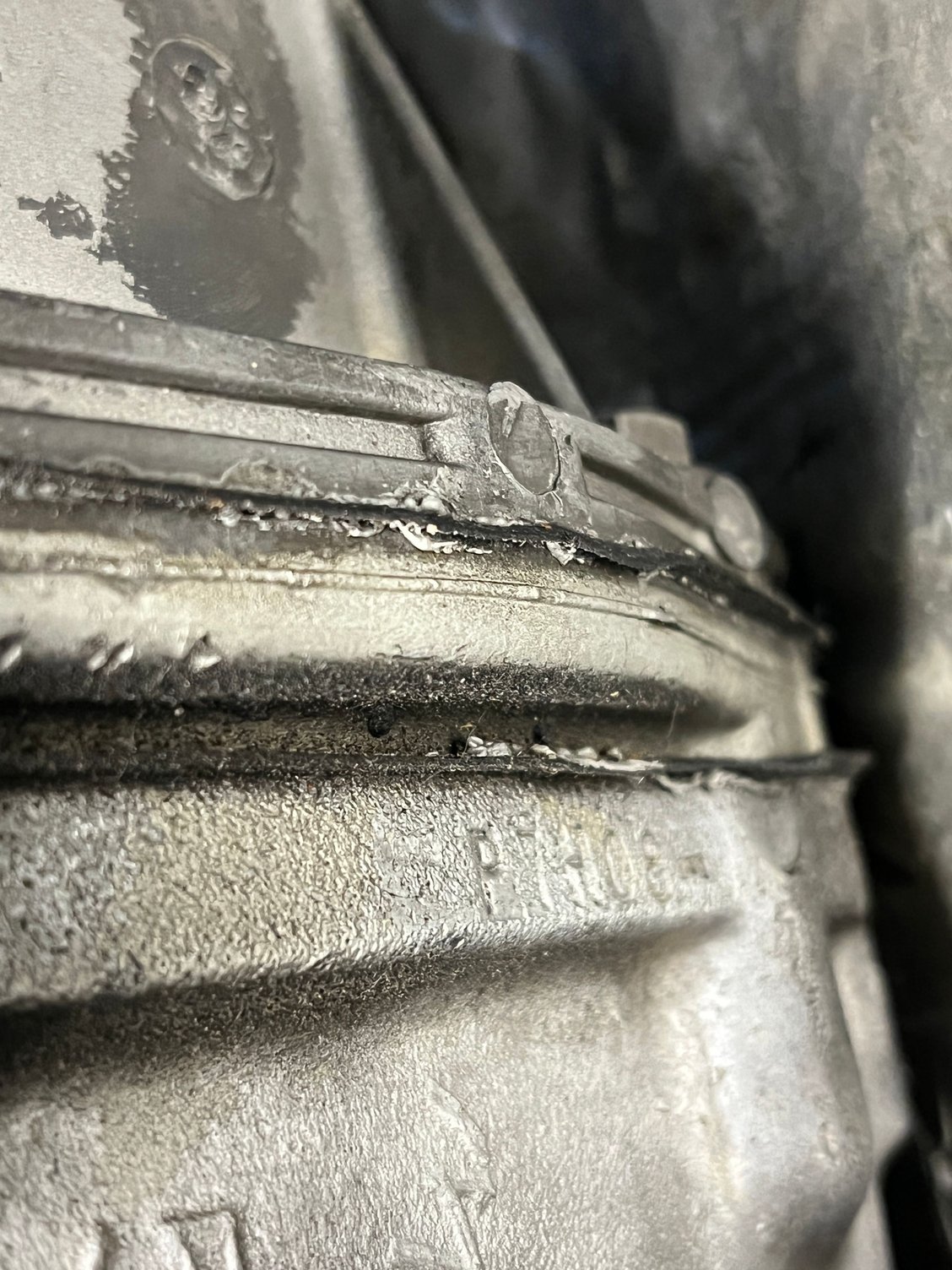

OK, got some more number and notes....I see two rings on the end of the transmission. According to my research, this is a 66-70 Muncie. All along I was curious about the VIN which it seems that I found. It doesn't match the VIN on the motor which wasn't original anyway.

The housing is not a 66, a 66 housing casting number ends in 010. Also as I understand it the partial VIN in 66 starts with 1S, in 65 it starts with S. The tail housing is a late 65 model year. The side cover is 64- 65. So I would say that this is a 1965 trans with a fair degree of confidence.

We’ll, the main case is from a St. Louis vehicle, just not a Corvette.
That is EXACTLY my assessment. As i mentioned above, a 325 case is 64-65 ONLY.
