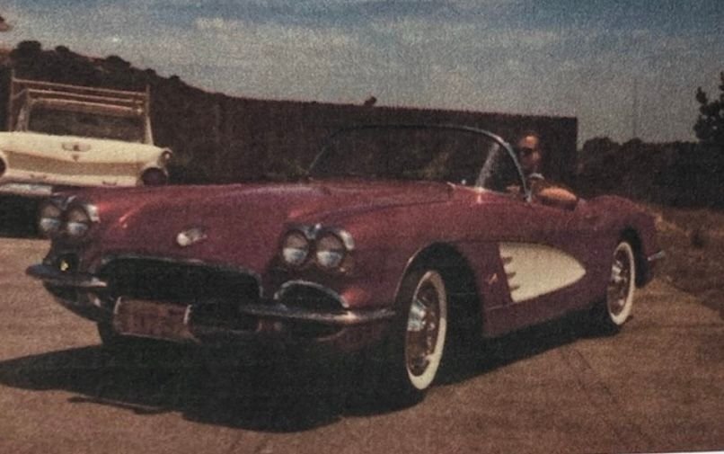

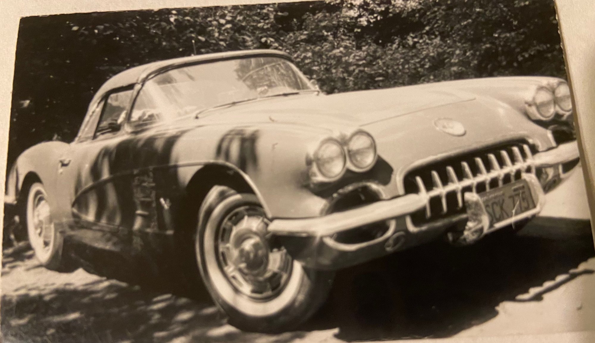

I was just looking at some old photos.
my dad had both a 59 and a 60 corvette that he purchase brand new.
Mom says they were both Red, but doesn’t know what other differences, and can’t remember why he traded in one for the other…
The first appears to be a 59 by the grill (Mom knows it wasn’t a 58 with the washboard hood and rear trunk chrome)…
the second looks like a 60, and I have an owners manual for the 60, as well as a “Corvette Owners” card with the VIN and Dads name.
not sure where the 57 manual came from…
is the cove paint correct on the 60? Because I have only seen all or nothing, but dad’s has a white cove on the door, but red on the fender forward portion…
Thanks

59 and 60 grills were the same. Stitching in seat pattern went the opposite direction. And there was a red white and blue symbol (small) in the grab bar hole cove on a 60. After December 1959 (60 model) vin tag moved to the steering column and the Vin stamped on the engine pad, other than that they’re the same. No visible exterior differences

Externally, the 59-60 are completely the same.
The differences are extremely minimal. As mentioned, the 60 had added, painted rectangles above/below the Corvette in the grab bar area. Seat patterns were different.
The most significant difference/upgrade for 60, was UNnoticeable and quite subtle. There were suspension upgrades to the 60 which carried over to the 62 models. Mainly, the upgrades were a larger front sway bar and an added rear sway bar. Otherwise, visually, for those who are not familiar with these minimal differences (and a few misc others), it is nearly impossible to spot a 59 from a 60.

Though I am certainly NOT an expert on the 1960 (nor any other model year) Corvette, it is my considered opinion that all painted cove area from the factory on the '60 model would have included the forward area. Certainly many coves were painted after leaving the factory, including at the dealers, so different patterns will be seen. However, from the "factory" (St. Louis) the cove area, when optioned as contrasting color, should be all inclusive to the wheel well.

The entire cove was either body color or if owner ordered painted cove, the entire cove was painted one color.
The VIN tag moved to the steering column in early Dec. 1959. My 1960 is VIN 1651, built first to second week in Dec 1959, and tag is spot welded to steering column.

Thanks everyone…. All I have are these two pictures.
it’s possible my dad did some mods (looks like the grill teeth are missing on the 60).
I know in later years he did some subtle paint mods on some other cars, so perhaps he painted the coves.
During this period, he only kept the cars for a year, trading in for the next hot model. He also usually bought the most powerful, carbureted cars…
Mom was dating him, and he taught her to drive on the 59 (4-speed), but she doesn’t recall why he traded the 59 for the 60.
was teaching his sister to drive on the 60, and she almost crashed into the hedge in the driveway…. My aunt found that picture of the 60 a few months ago

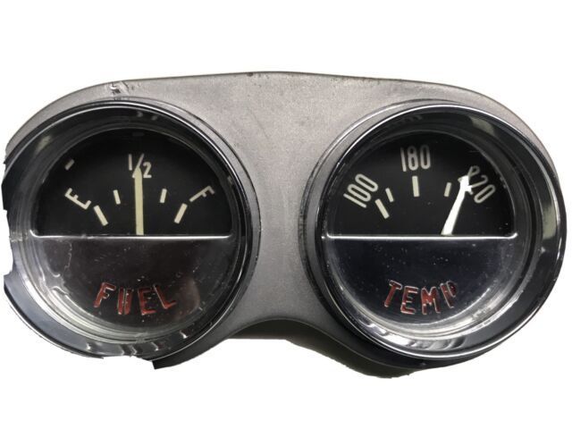

The gauge needles are a different shape and the 60's had traction bars on the rear suspension. I'm not an originality expert, but I had a '59 ex FI 290hp car and a good friend a'60 FI (which he still has after some 50 years). We were schooled by a late friend who was ahead of his time as far as originality, options, etc., so we were "into" odd details and such way back when.
The gauges are the same part number, do you have any pictures of the differences you mentioned?

'59 and earlier gauge needles constant width with a rounded tip while '60 and later needles are tapered, almost to a point.
'59 and earlier:
'60 and later:
That must be another of those little changes they made during the production of the 60 (like the vin tag placement). I have a very early 60 (#202) and its original gauges have the more rounded tip like your picture shows in the 59.
Well, that's new news! I didn't know that was a running change. I thought it was a MY change.
My April '60 car has the tapered gauge needles.
Thanks!
Edit: Given that yours is an early '60, I totally believe that your gauges are original to the car. However, it's interesting to note that the most recent NCRS judging manual shows no awareness of '59 gauges being carried over into early '60 production.
