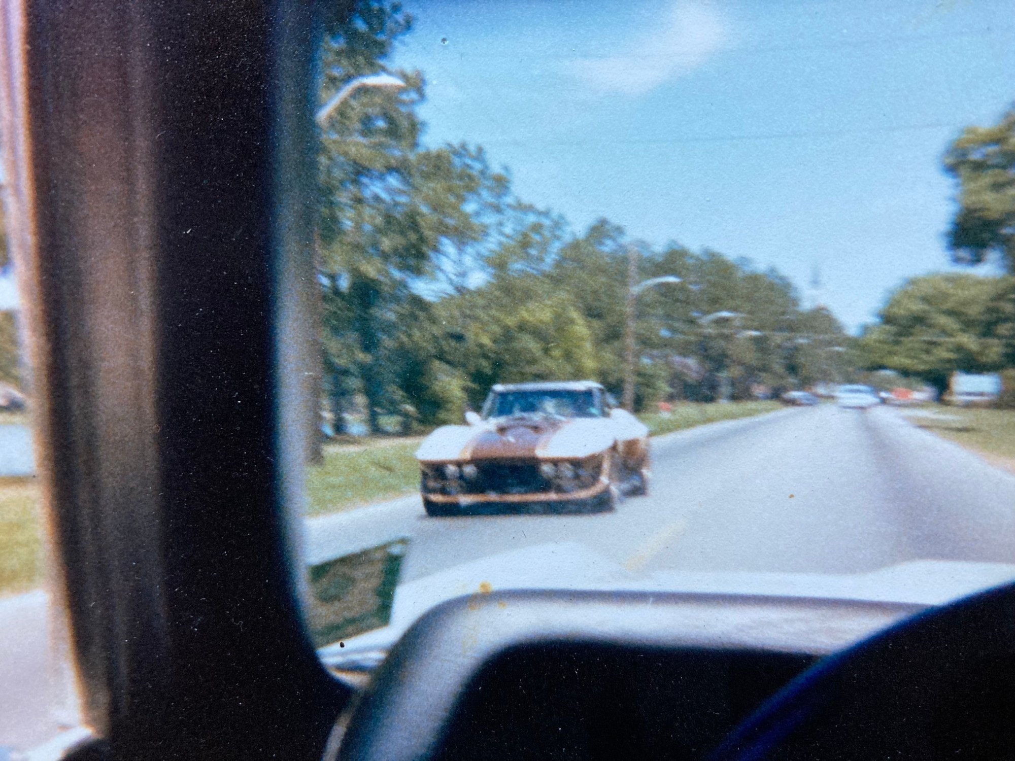

Below is a pic I took in 1975 I was 15 saw this vette at my friends neighbors house, ran home grabbed my camera and before I got back it was driving at me in my Chevelle snapped the shot and drove straight to the drug store to drop off the film. This is the day the C2 was put at the top of my car bucket list.

TR64 - Sharp looking 64 Roadster. And I can relate to that other pic due to my neighbor in the 60's who was the last owner of Half Moon Bay Dragstrip and one day when I got home with my folks, maybe 1966/1967, my neighbors friend was parked in his driveway with a Black on Black 66 L72 Coupe. My folks car had barely stopped when I jumped out to take it all in. I can still see that car in my memory.

I was 12 when an older cousin, staying with us, came home with a brand new '57 Venetian Red vette. It was another 9 years before I bought my first Corvette.

Vet65te- I would like to think that pretty much most of us over 55 or so have that deep rooted interest in not only in the Corvette but just about any of the muscle pre 1973 or so. I was born and raised west of Flint and had many relatives working for GM back then all of our families owned many cars that today are considered collector vehicles, too bad we cant get those cars back. Today I cringe when I see a heavily modified C2 like the one in my pic but in the mid 70s it was cool and a C2 was just another used car and living in southern Michigan at that time every big block Chevy, hemi Dodge and big block Ford all were just daily drivers .
