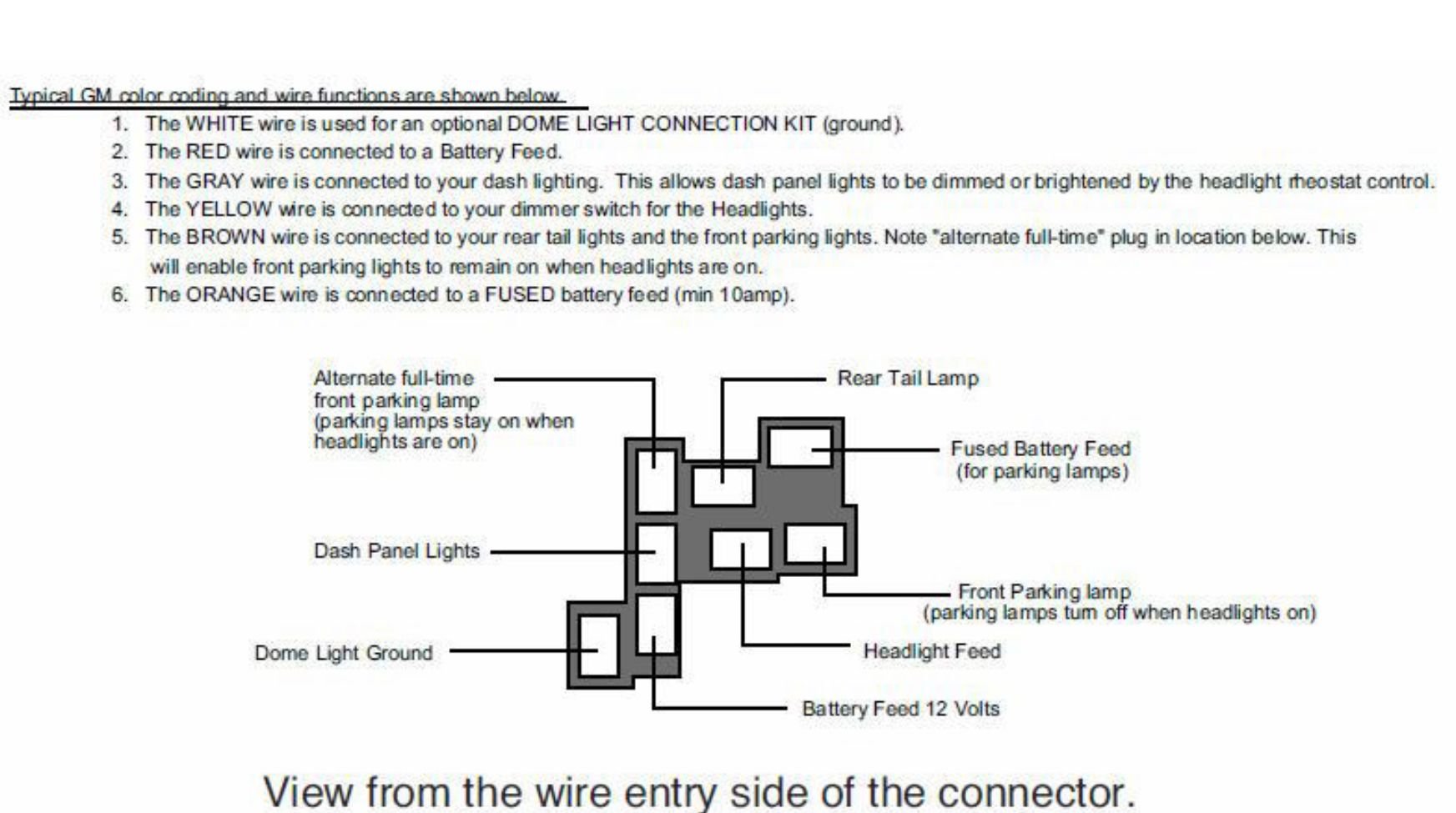

If the parking lights going off when the headlights are on bothers you, there is an easy fix. Just pull the connector off the switch and move the parking light wire to the alternate spot.

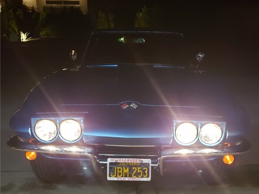

I did this to my '65. Happy with the look.

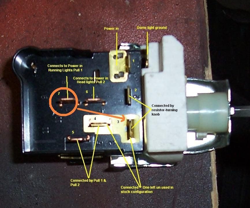

A note: The wire that goes to the front parking lights on a C2 is PURPLE. To do the change to parking lights staying on with headlamps you have to remove the purple wire from the connector and move it to the open space in the connector to attach to the terminal on the switch that is unused in stock configuration. See the picture to visualize the from and to locations.
Simple answer is, move the purple wire from the circled in orange connection to the indicated by arrow open connection on switch connector if you feel you want both parking and tail lights with headlights. It will be obvious that no wire is in the hole for the stock unused one. The important note is move the PURPLE wire.
Follow the yellow brick road:
