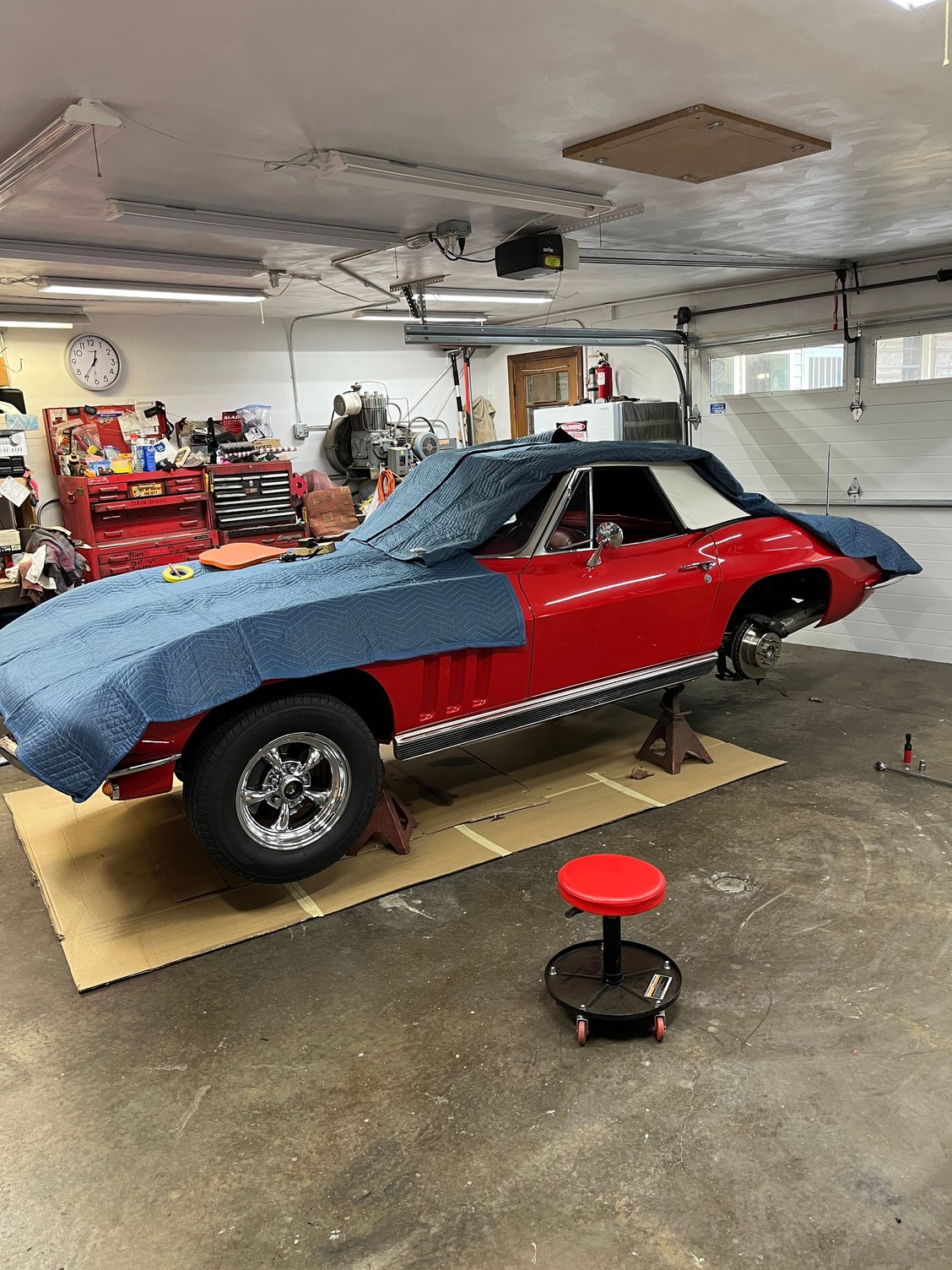

Number 1 Find a shop that has long time experience with the old cars and an older alignment rack that can be custom configured. Have them check all your bushings, rear trailing arms and front-end parts for wear. A 4-wheel alignment will cost about 200-300.00. A start from scratch after a restoration may cost 300.00 and up. I had my car done here in Ohio last spring after a full tear down. A start from scratch alignment, 3 hours shop time and the cost was 300.00 and the owner and I have a long relationship...(-: I was informed that my front upper A arm bushings will need replaced soon but would be fine for awhile until I can replace them. So, they will get replaced this winter during down time and a fresh front end alignment in the spring. Big-K
Just getting started, car is on stands
