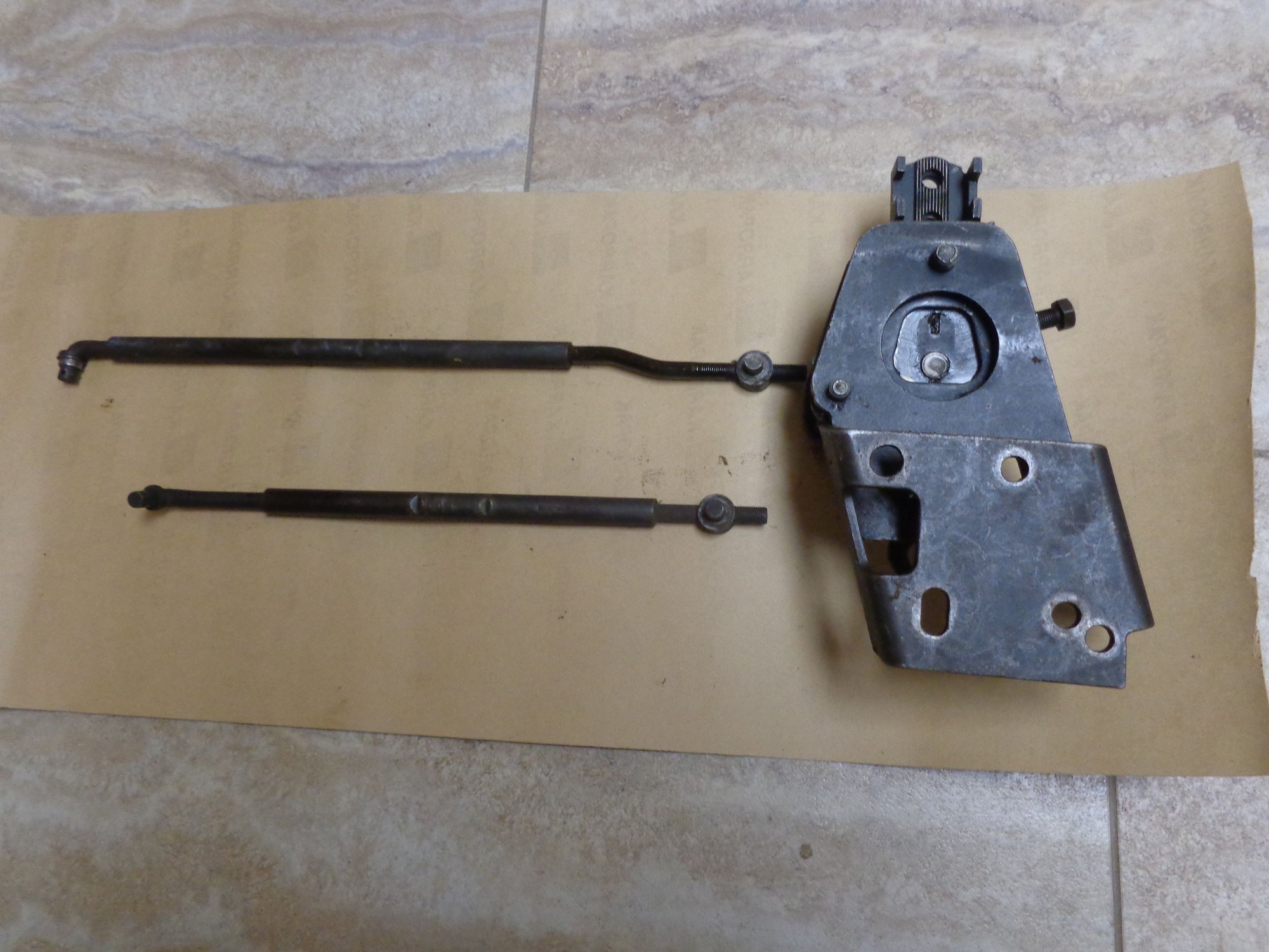

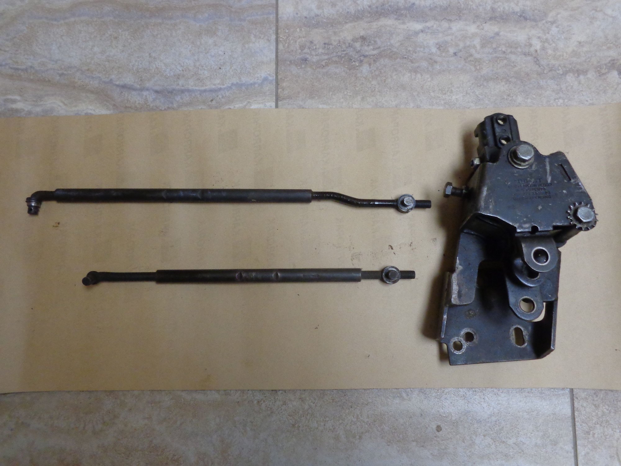

This is a Super Shifter. The shift mechanism [ Comp Plus/ Super ] is essentially the same
What turns a Comp Plus into a Super Shifter, is the elevated mount and the straight rods A Super Shifter in a C2 , requires a Big Hole and cutting away the left side of the console
