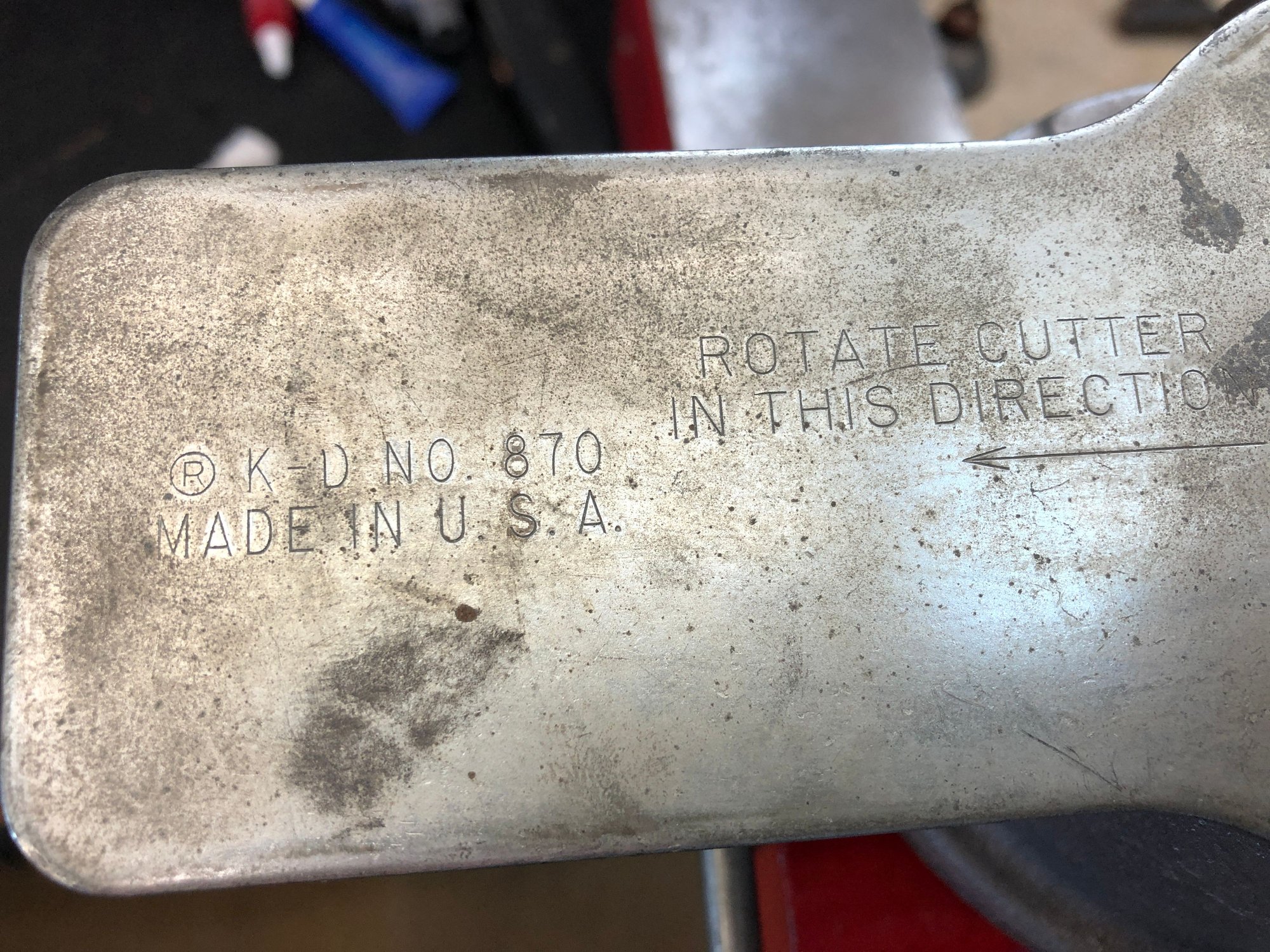

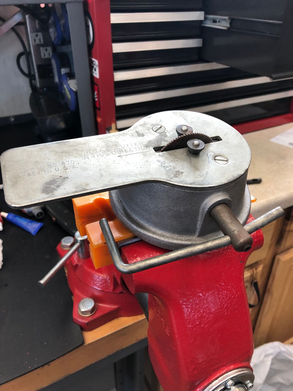

Default KD-870 Ring Filer
This is the Ring Grinder I've used for a very long time, a KD-870.
Just looked it up and get the feeling it isn't made anymore because they refer to it as 'Vintage', meaning you'd find one on eBay. Summit has an identical tool but KD is not listed as the mfr.

The one I use came from Summit and looks just like yours, Mike. It works fine.

I've had the same one shown above for so many years that I cannot when or where I got it. But I've done rings for many engines for many years with no noticeable wear. One of the cheapest and best tool investments I've ever made. Oh ya, it also came with an extra grinding disc which I've never needed.
