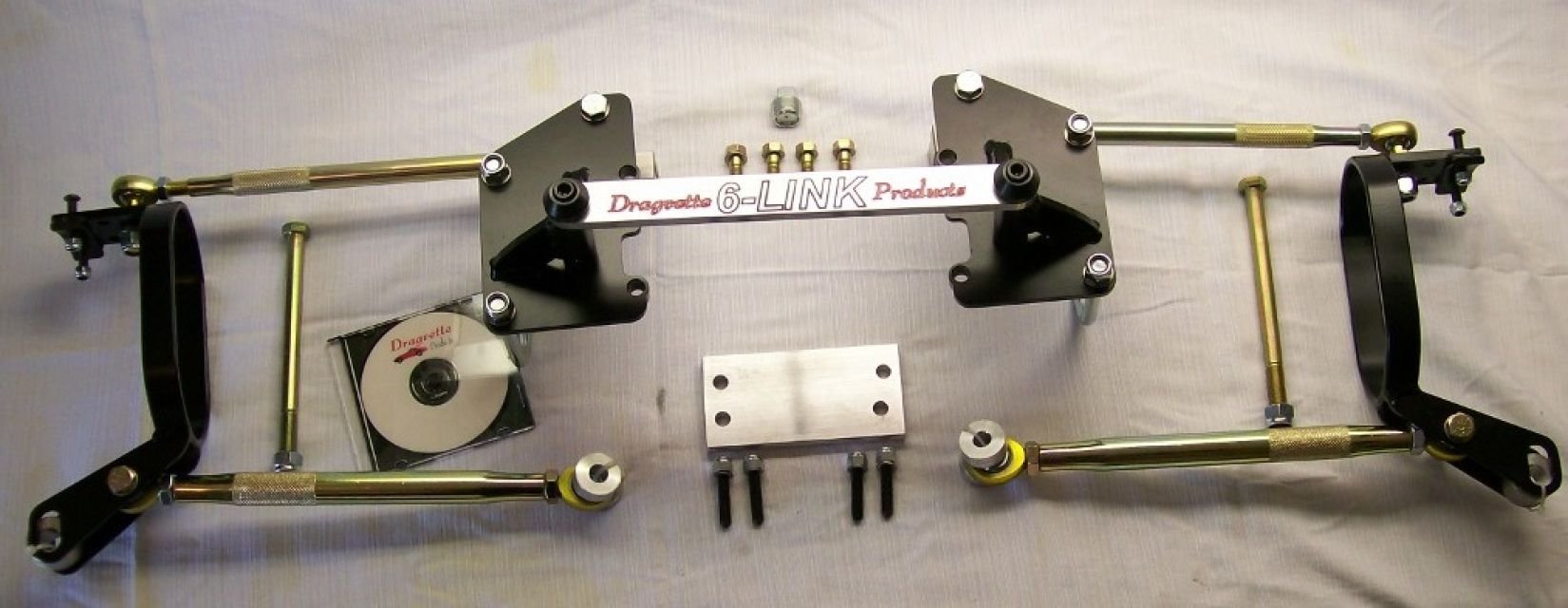

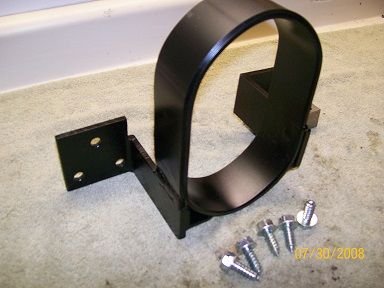

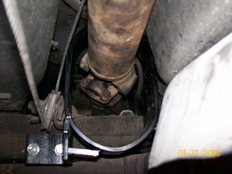

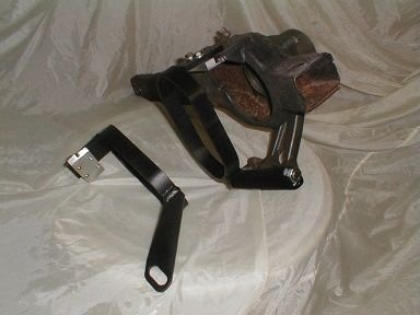

Old Dec 4, 2022 | 07:09 PM
4 Speed Dave's Avatar
4 Speed Dave
Joined: Dec 2010
Posts: 1,223
Likes: 360
From: Southington CT

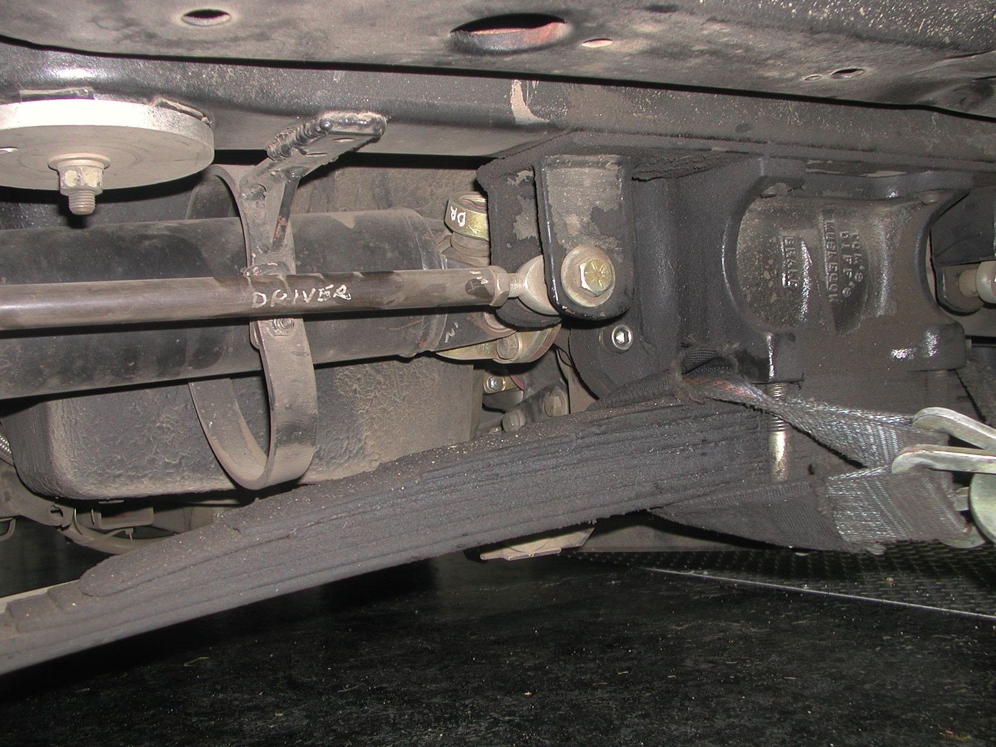

See photos below:

Old Dec 4, 2022 | 09:17 PM
GTR1999's Avatar
GTR1999
Joined: Aug 1999
Posts: 15,173
Likes: 3,982
From: Connecticut, USA
Originally Posted by 4 Speed Dave
See photos below:
perfect example
Tom’s loop,upper link kit for keeping the wheel on the car in case of a break, and HD cover.
I’m going to guess there’s some more of Tom’s stuff in the differential

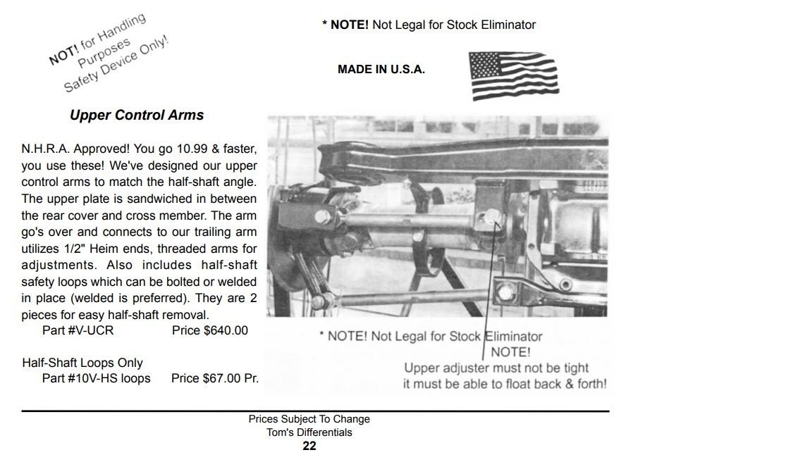

I dont have either of their products-Shark Bite or Drag Vette, but Drag Vette is probably the one I m thinking about. They had just hoops, then they have another integrated to their multi-lnk. Since it was my mistake, let me grab a picture.
But First my friend Tom was a real Corvette Drag racer- back in the day, so tested everything as GTR Gary will attest. Gary you are one of the knowledgeable guys who helps everyone! 👍

I found this on Racevette site, who lists Drag Vette, but don't know if they are one and the same.

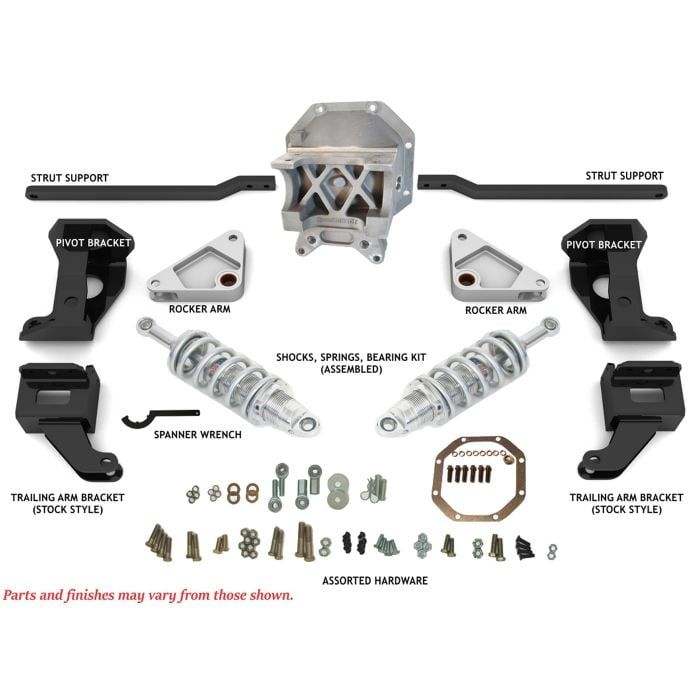

One the Shark Bite, I just looked and the part I remember seeing is a Pivot bracket, not a hoop design- at least from what shows.
