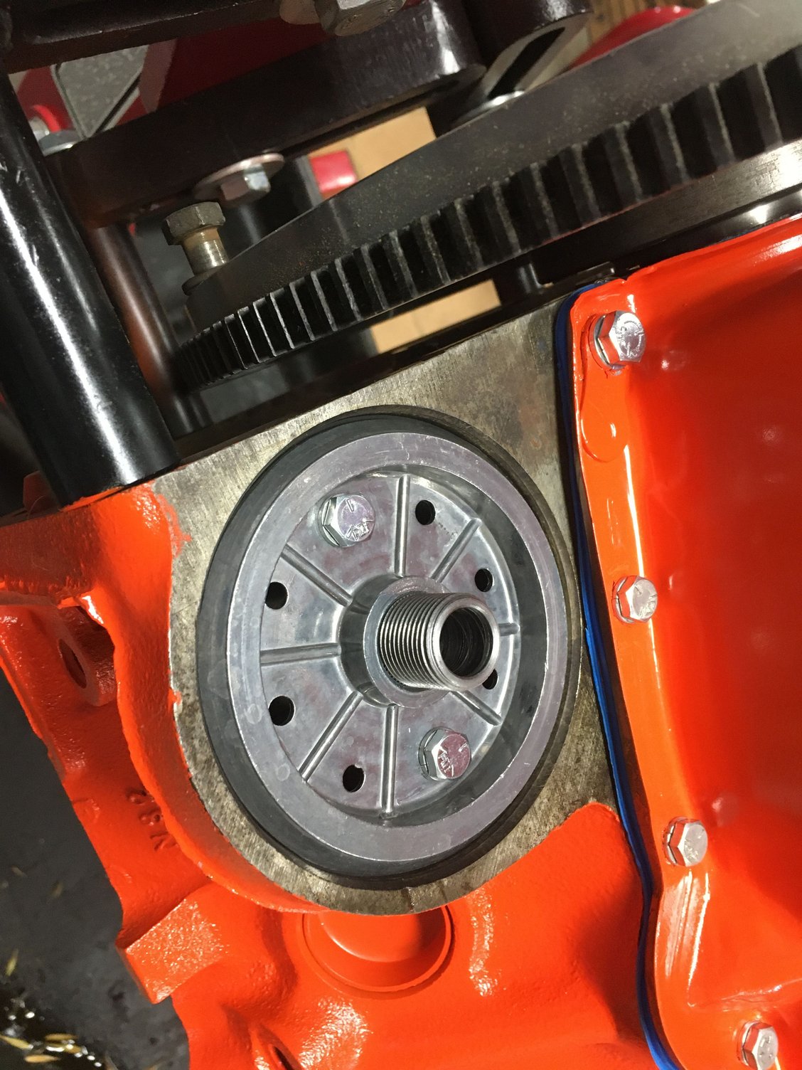

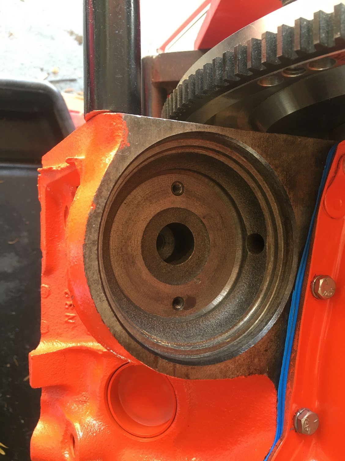

Todays challenge. 1965 sbc 327/300 oil filter.
I want to eliminate the canister oil filter. The block does not accept the later bypass adapter, doesn’t sit flat and bolts are to big.
I have looked at the adapter that is 2 piece with the bypass in the upper part and than the 2 piece lower that has the center pipe for the screw on for the filter. There is a large hole in the block that appears to line up with the upper adapter for the bypass . This configuration seems to have a lot of potential for leaks.
I have also seen an adapter with no bypass and you use a filter with a built in bypass, but not sure it will work because of large hole in block. (Picture)
My question is, are there any other options than the conventional 2 piece adapter conversion or is that what I’m forced to use?

I started a thread on this subject over the summer. The two piece adapter you mentioned is from Mr. Gasket and uses the canister filter bypass valve plate from the factory. It's a bother to mount correctly and does indeed invite leaks.
The single piece unit you mentioned is PermaCool number 1134. It doesn't have a filter bypass. The bypass is not needed, but ad you noted, there are spin on filters with internal bypass if it concerns you.
I'm not aware of other options.

Perma Cool #1134 is what I use along with a Wix 51061 oil filter.
https://www.summitracing.com/parts/prm-1134?rrec=true

Forgot to mention that the thread was started because I installed the PermaCool 1134 and found a gasket mess on the Mr. Gasket adapter I pulled out. NAPA Gold 1061 is the same filter as Wix 51061, if you're looking for it.
There is also Trans-dapt number 1324 but it looks really flimsy. The PermaCool adapter is a much better choice.

Just a follow up: perma cool 1134 installed and fit perfectly. K&N filter is 3003, extra tall with by pass valve in the filter.
