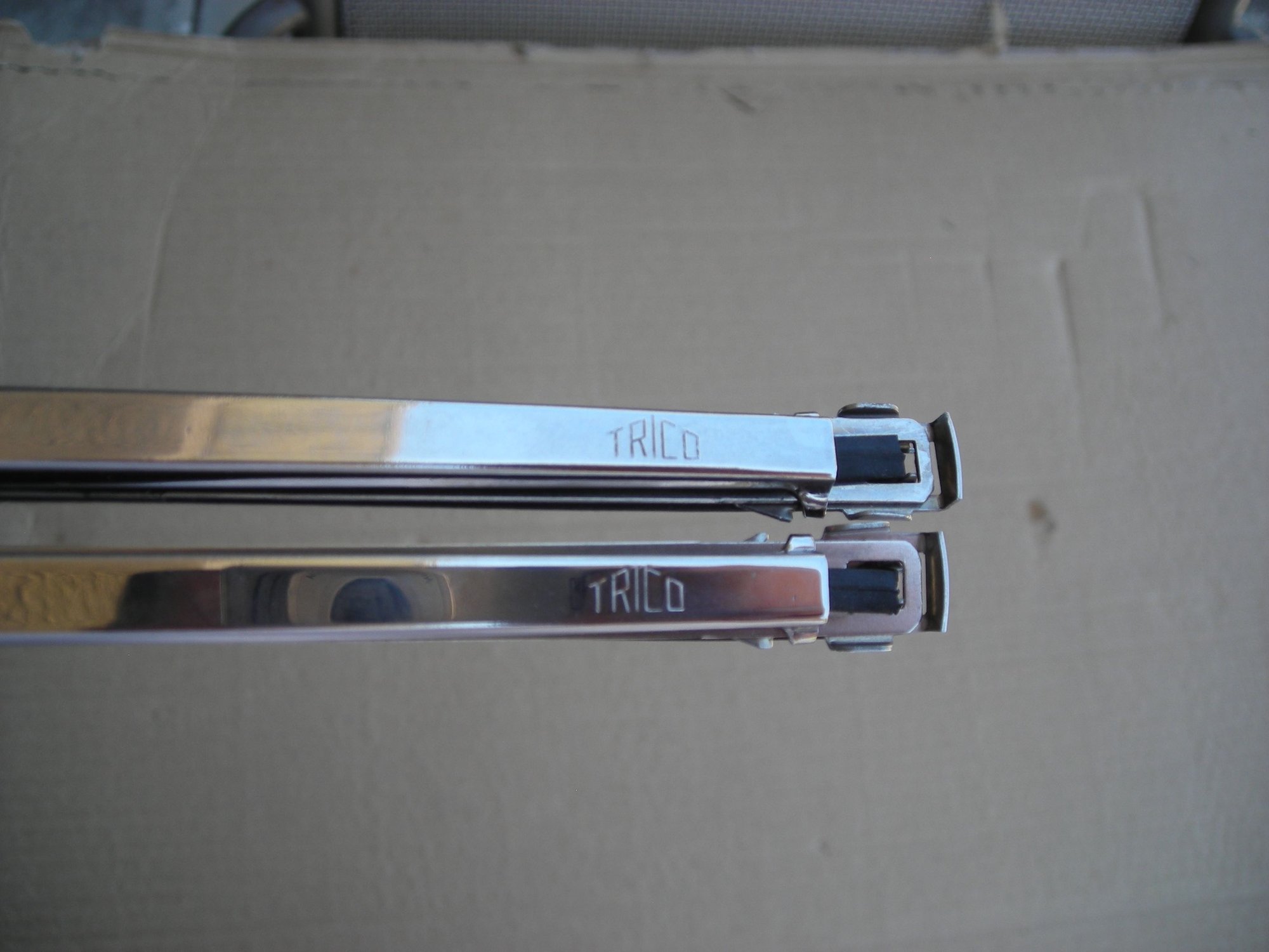

Here you go Jay, hope it helps. begee22

Those aren't original holders. OEM Trico had flat front and back halves not arched front halves like yours.

Well then, NCRS Regional judging missed it................no deduction.

Yes, they missed it. Those things happen.. Here is what should look like.
