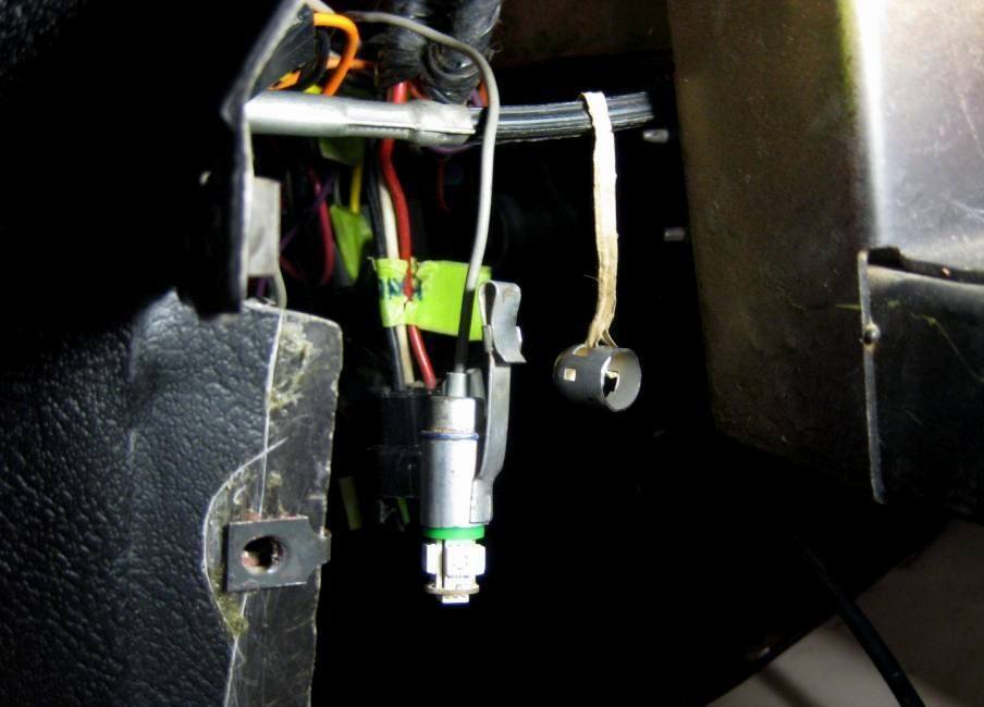

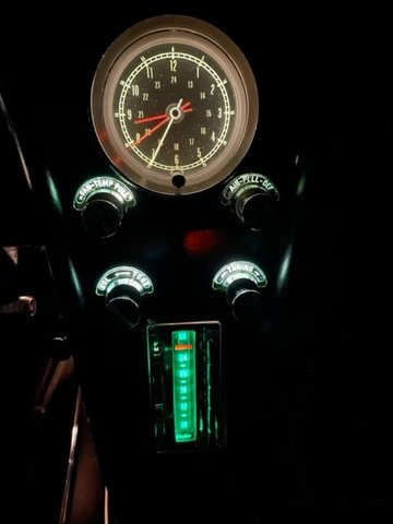

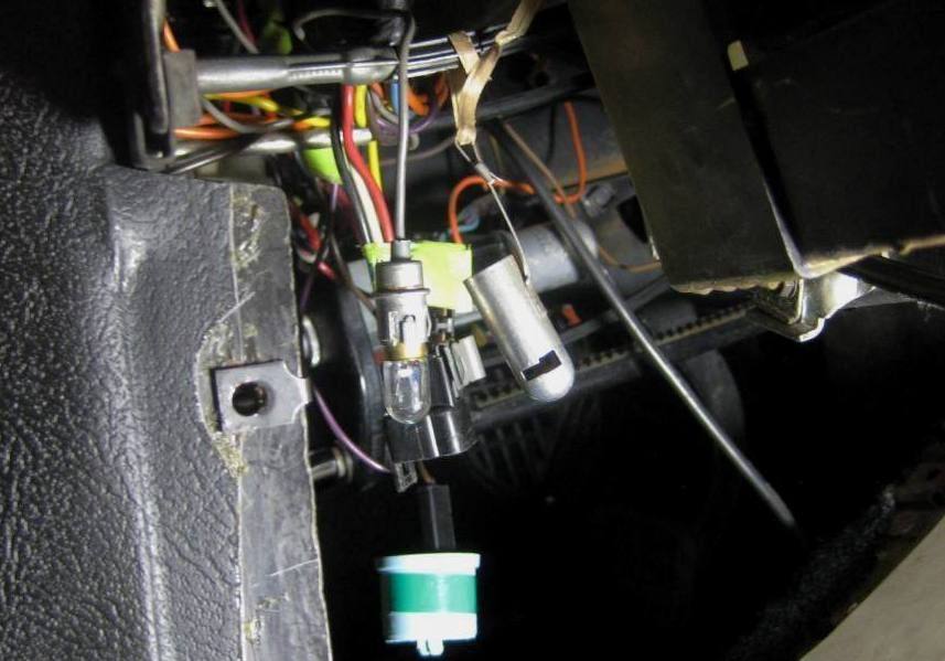

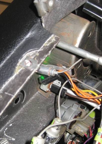

The green lens thing fits over the tip of the slotted 'torpedo' shield for green color heater control illumination; first photo, below. The torpedo shield, in turn, clips to the underside of the clock housing, 6-o'clock position slot; second photo. If you've installed a green BA9S with 5-LEDs into this socket, the tip of the shield must be cut off to accommodate same; last photo.

Wow! What LED did you get to fit in the "torpedo": for the radio/heater control bezels? That looks really bright. I made the same discovery Vark did, so I just kept the regular bulb in there. I didn't want to chop my torpedo housing.

Avispa, if I remember correctly I did not want to chop up the housing so I left an incandescent bulb in there but drilled the small square hole in the top of the housing larger.It was the lesser of two evils.
