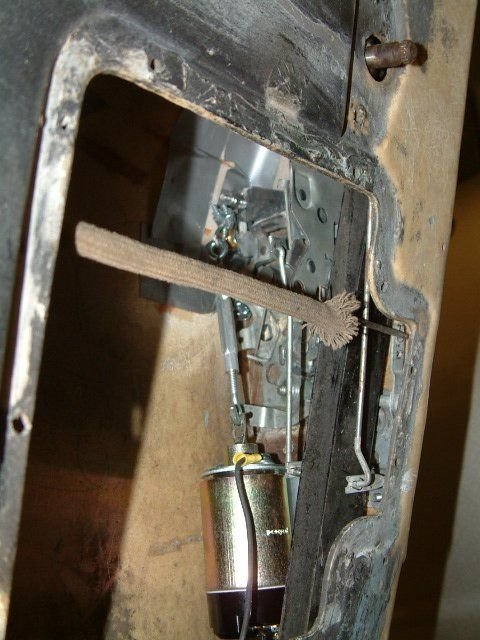

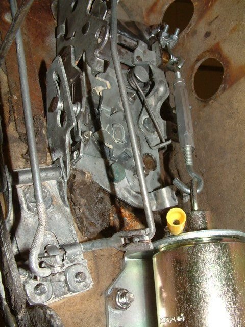

Not exactly door "locks", but I installed door "poppers" in my '59 when I first built it. Not a kit. I installed some solenoids that had a remote unit so when a button on the remote was pressed, the doors would "pop" open. I shaved the door handles, but found out later that the rules under which I was planning to race required outside handles, so I had to re-install the handles.

Here are the only pictures that I have of the solenoid that used to "pop" the doors open on my '59. There was a small pulley at the top so that the cable was pulling on the latch when the solenoid was actuated.
