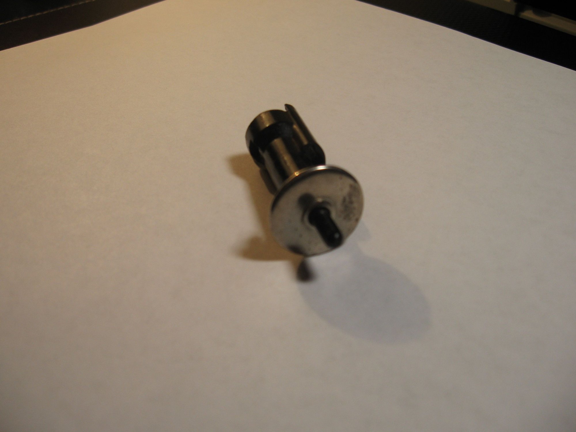

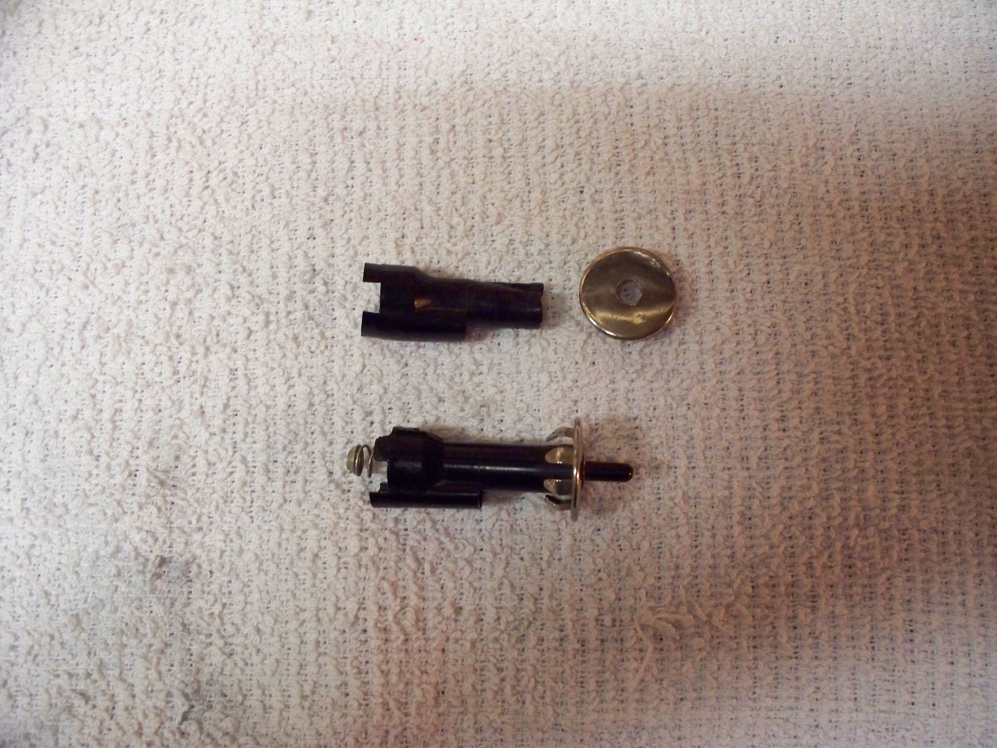

Post a picture of what you received. The 63 socket was a one year only part.
I posted a broken one and a working original.

This is the type I have received each time. https://www.zip-corvette.com/63e-glo...ht-switch.html
As you can see, the part that fits the holder is smaller than the 63 type. Who carries the correct one for the 63 only? These suppliers don't recognize that the 63 is unique.
Thanks for the picture!

No one makes them. Look for Corvette used or 57 - 63 Chevrolet.

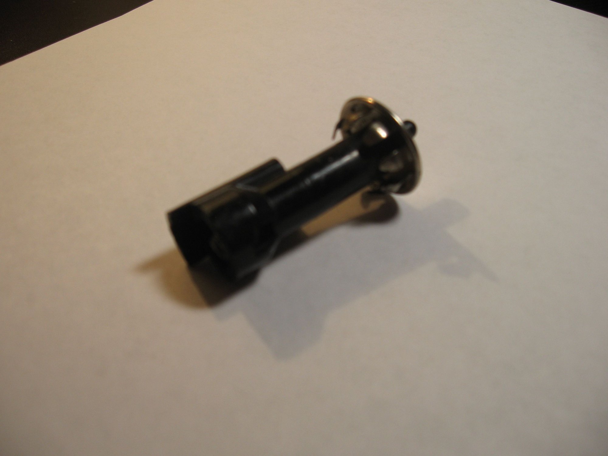

Here is an original switch I recently bought after a 10+ year search. Notice the surrounding install fingers and raised area near plunger..................prior to finding this I purchased a switch from Tracy Corvette listed currently on e/bay by vettepartsman @ $10. that worked for me. begee22

Configuration looks right, but every original I've seen has been black....not gray like the one in the photo.

As in post #6

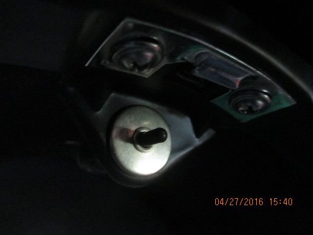

Change the bulb so the shield fits

Like this.

Got it all together and works fine. Only thing is that shield gets very hot and its touching the cardboard above. Maybe I'll get an LED bulb. It takes a 57. Thanks for all the help!
