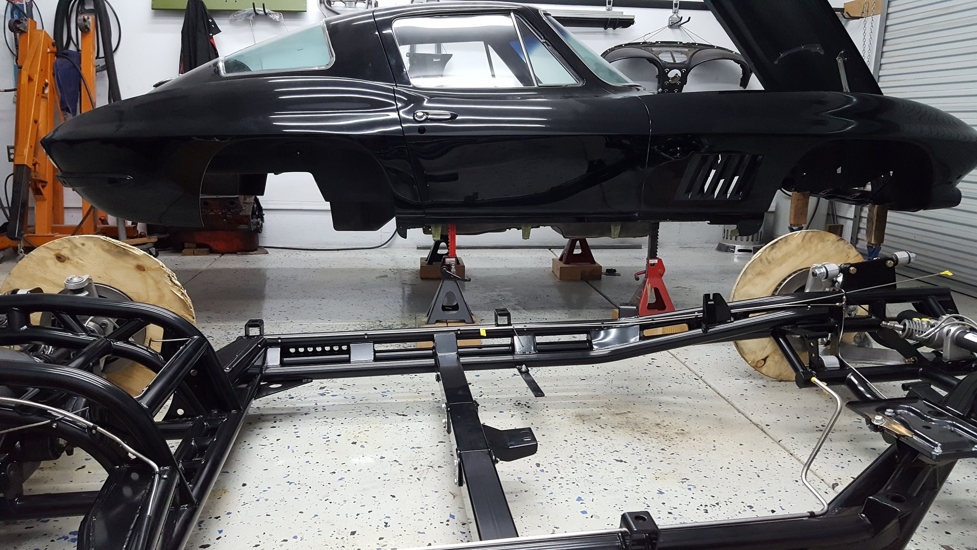

I recommend you consider whether or not you really want to do all that comes with an aftermarket chassis. I have done it, at home, pretty much by myself (a little help sometimes from my wife). Its not really hard if you're the kind of person who can pull the body off anyway, you can do it. Keep in mind, with the chassis with all components you'll easily have $25k in it. You will have to modify the rear floor area (not really "hacking" it) to accommodate the wider tires and new rear end components (it is not hard, you cut per directions and use SMC adhesive to glue in the new fender wells). You'll also have to get all new wheels (custom will likely be about $1000 a wheel), the tires (most aftermarket frame and brake set-ups have a minimum of a 18" rim). And keep in mind "mission creep"...with it all apart you will find things that need to be addressed. If you simply need to replace your existing chassis, Vette Products of Michigan might be the most economical way to do it and it won't require everything else to be new. It's been a while since I talked to them, but it seems a new complete frame, with shipping was under $9k.
Anyway, here is a picture of my SRIII frame, for consideration (it was about $24k as it sits, it was ordered with full C6 suspension and ZL1 rear end): [threw in the truck it was off loaded from, just for kicks].
