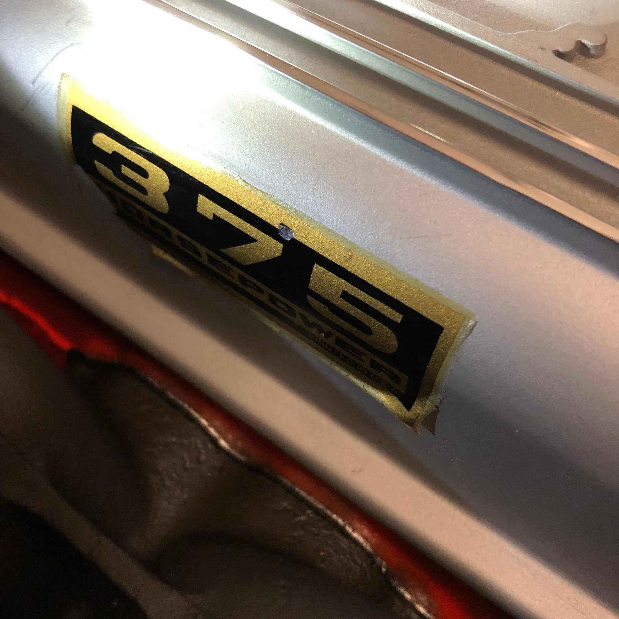

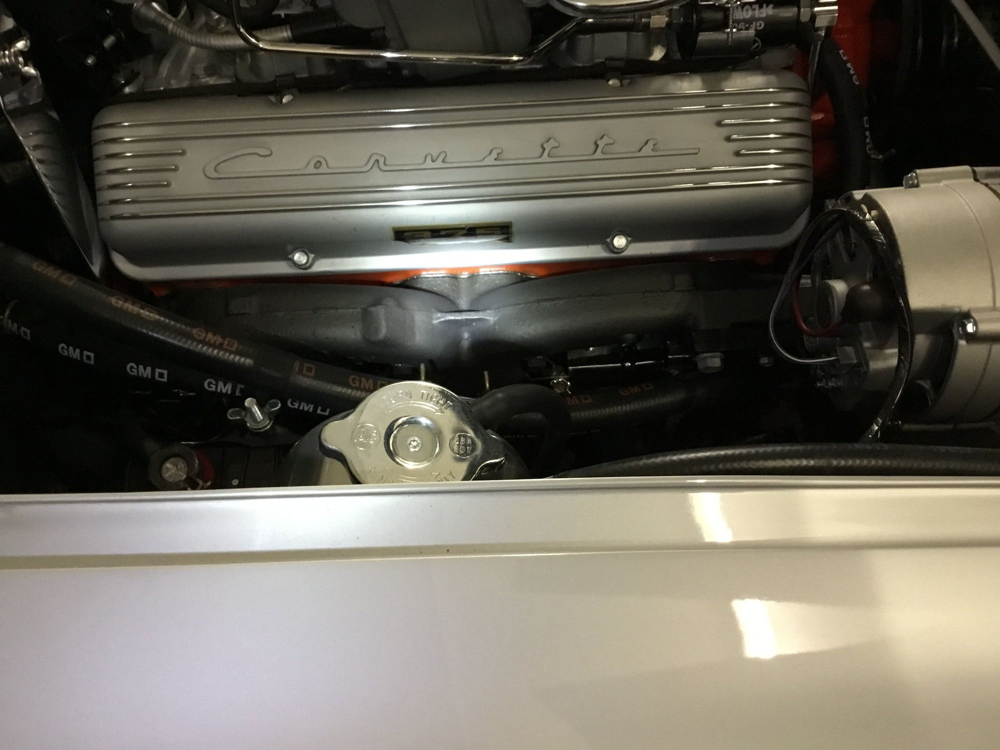

Valve covers decals lifting off ? Starts to just lift the edges off & then after a week or so starts peeling back a good portion of the decal these are the water transfer style from I believe Paragon?

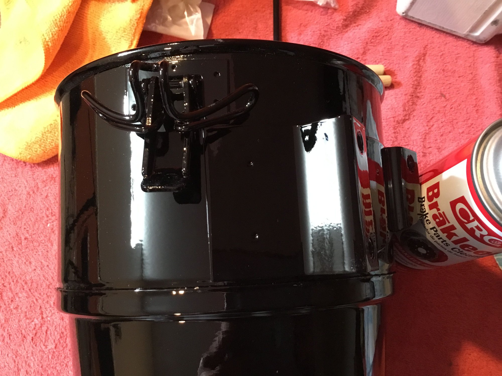

Getting ready to apply that Large air cleaner decal onto the Rochester F.I. A/C housing not sure how that interacts with that freshly painted surface ? This area may be a lot more forgiving doesn’t see the heat like the valve covers?
Early stages both covers are like this drivers side is a lot worse
Sorry So-so pic you guys get the idea:-(..
Here’s a pic of the freshly painted Air cleaner housing there’s a large decal that is originally installed onto it

I have used microsol on my freshly painted models. Never had a problem. Of course the models are not subject to any engine heat. Put a small dab of solution on a hidden area and see what happens.

Agree, I was thinking to cut a small piece & Apply it in a unseen area on the air cleaner for a test I have some old v/covers that will be my first test.

I have some reproduction Mopar decals made in Sweden that set in water. I used a quick detailer, McGuire's final wipe, Griot's detailer, anything without wax. Micro Sol softens which means weakens the decal. No denying that, and then engine heat finishes it off.

I bought the mylar decals and bent them around my index finger until they had a curve that matched the valve cover. They have been stuck in the same position ever since they were installed.
You can do the same thing with the decals before you soak them. They will be less likely to peel if the curvature matches.
