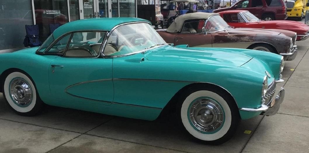

Here is my 56
Cascade green (original paint), 225 HP 265, 2x4's, automatic transmission, power top, dealer installed heater (early recirculating type) radio delete.
SC45-70

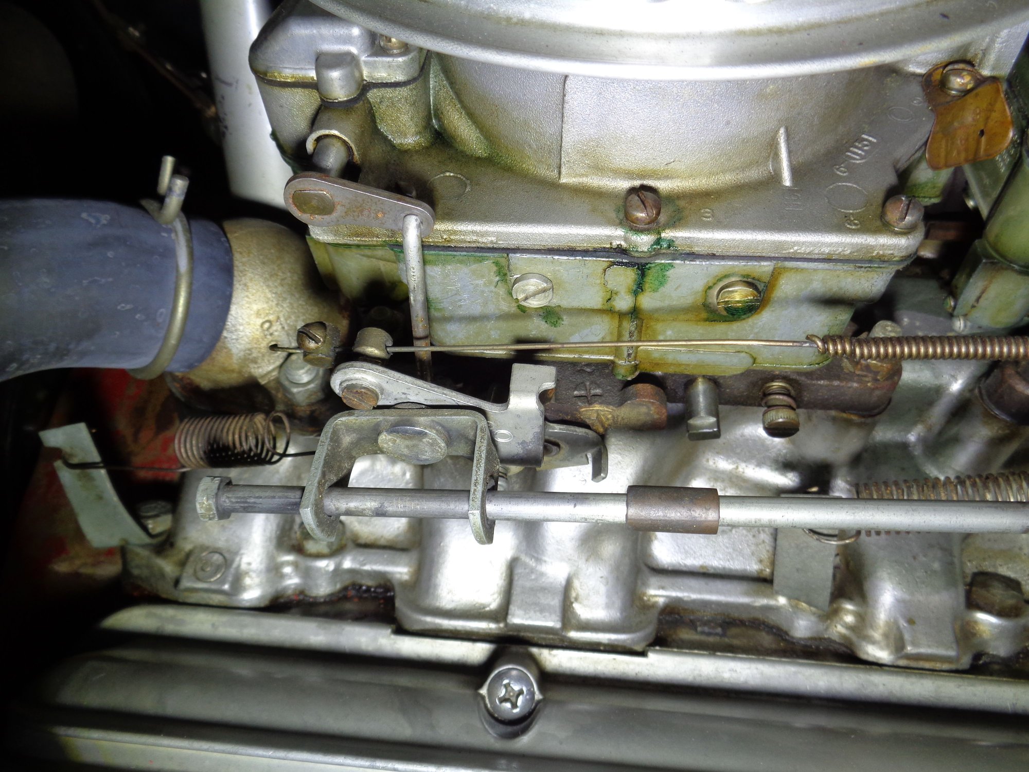

Here is a better picture of the cable and bracket on the front carb.
SC45-70

NICE '56....................I was first confused because I was thinking of my '57. The '57 283CI single four barrel carb put out 220 HP.
I currently have a 1958 Corvette dual quad with an electric choke and it runs GREAT!
Picture of my '57. Sold it November 2009 and now lives in Nice, France.
Re-living my high school days with my current 1958 Corvette. Except that my HS '58 was a four speed FUEL injected car.
LOVE THE COLOR...........................
