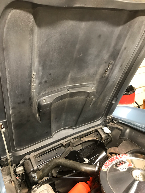

As others said, it's purely decorative. It adds just a bit of chrome dress-up contrast to the "opening". Once you get the hood, examine the opening and how it would look without anything covering the edges and inside of the hood scoop.
I think whether the hood needs to be cut for the insert depends on how accurately an aftermarket hood is reproduced. The factory hood only needed 3 holes drilled to mount the chrome insert. The added on bit where the screws come through (seen in the pic below) is a piece of fiberglass bonded to the main hood panel; the hoods were made this way at the body fabrication plant, not on the assembly line.

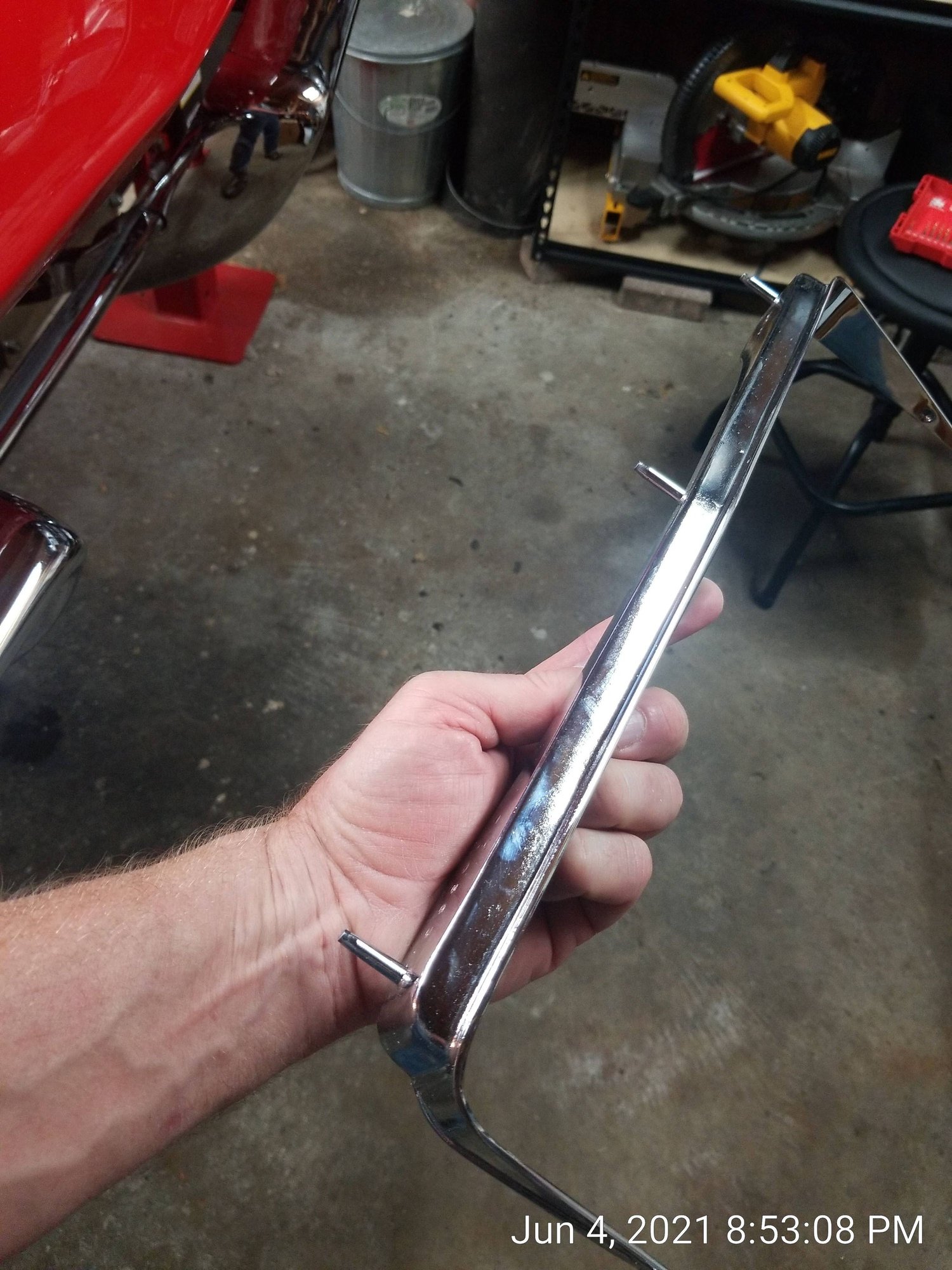

Here's what the insert looks like:
