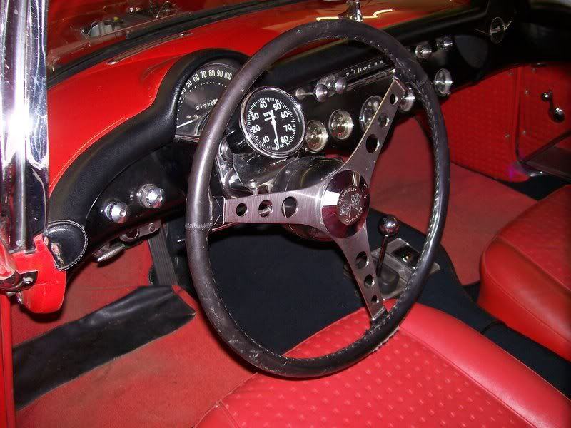

2 very basic questions. I'm reinstalling the steering column in my '61 after changing out top bearing on the shaft. Now I can't remember whether the steering wheel spokes make a "Y" or an upside down "Y" when the front wheels are pointed straight forward. Also, are the 3 screws (clutch head screws?) that hold on the horn contact suppose to be seated or are they left loose to allow more play in the horn contact?

The wheel forms a "Y", and the contact screws should be tight.

'Y' so you can see the speedo. Nothing left loose.

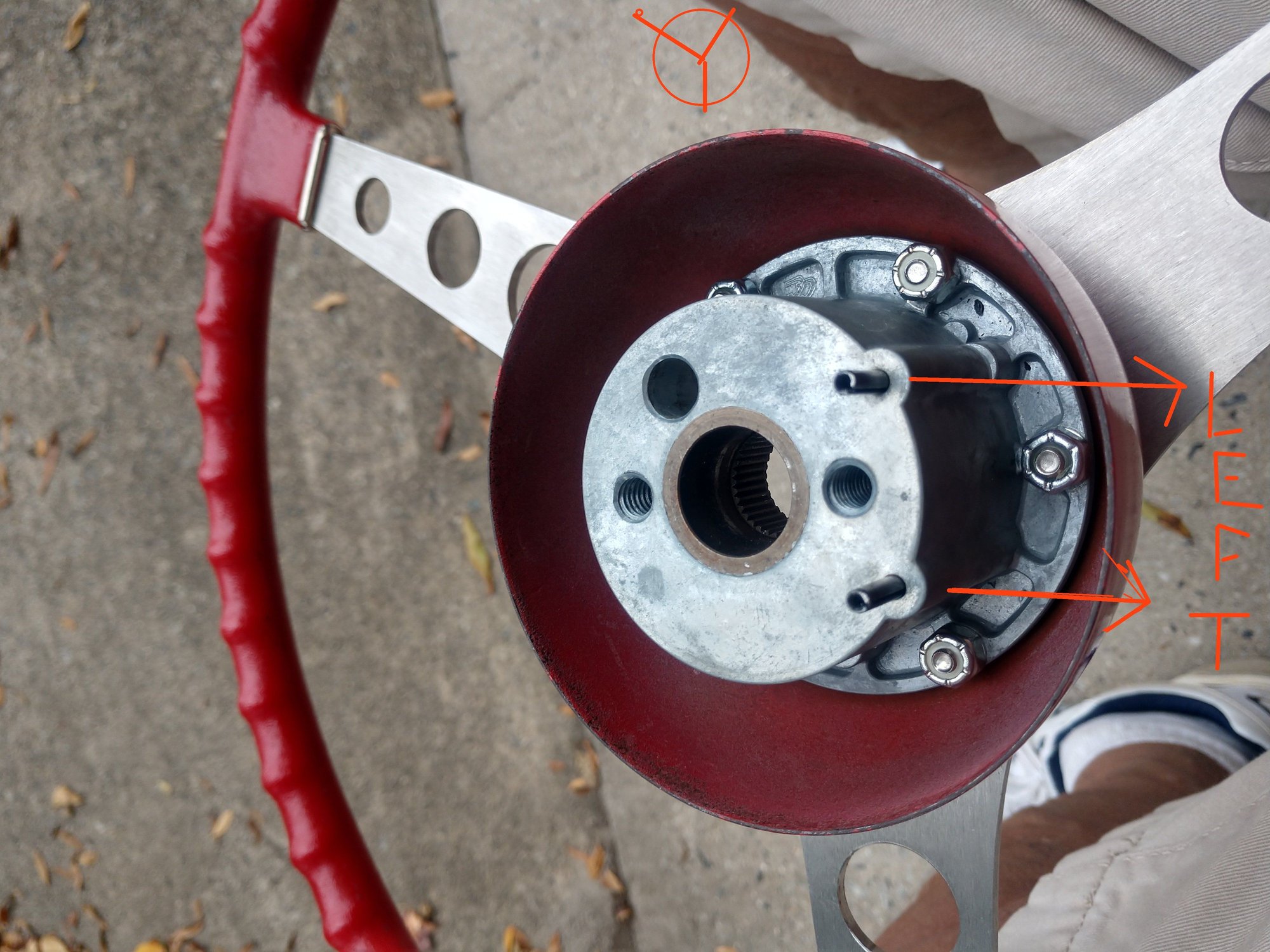

Now that I know what's up (questionable), at least with regards to the wheel, I need to confirm that the dogs on the center hub that turn off the turn indicators are facing the right direction. I had assumed that they faced towards the centerline of the car but with the spokes of the steering wheel making a "Y", I think they need to be facing towards the left side of the car. I'll attach a photo so you know what I'm referring to as "dogs".

Face driver's side

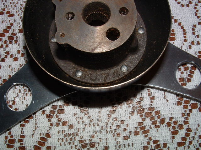

Another, showing the rivets

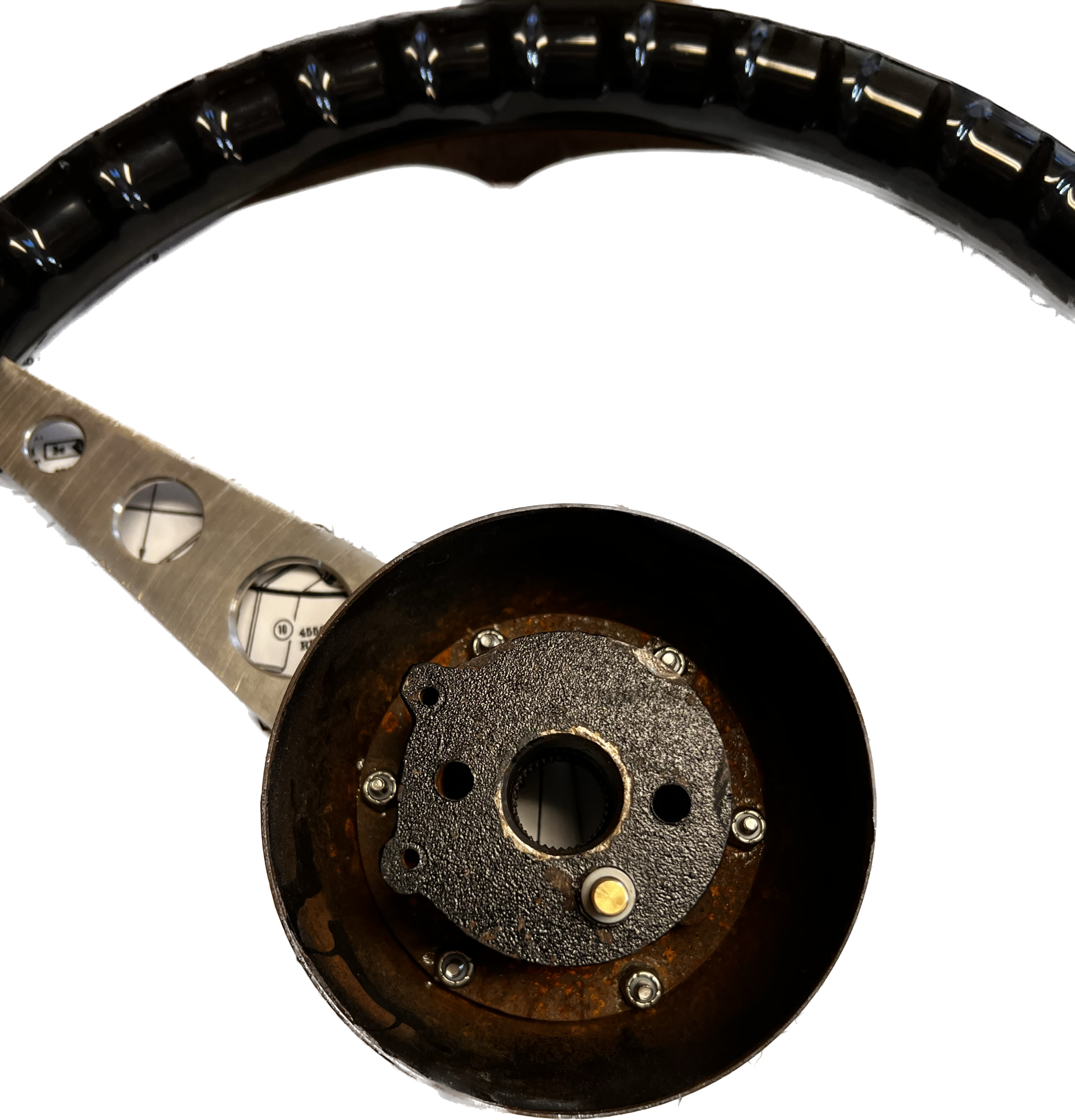

The screws should be tight.
Like this.
