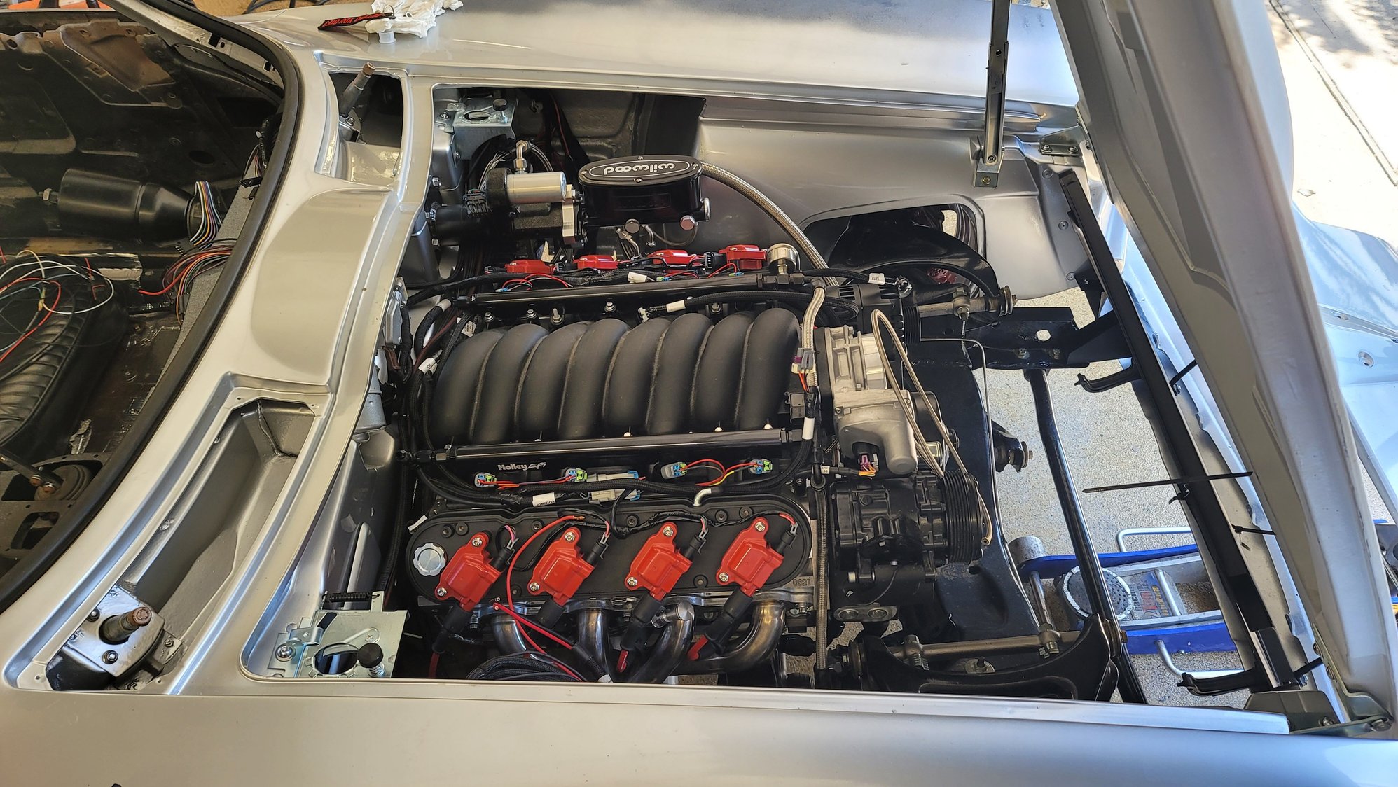

Yes, I setup a hydro-boost brake system in my 1964 roadster. I did not go with a canned system since I wanted steel braided lines and I did an LS conversion which has the Holley Mid-mount front engine accesso system and a Borgeson power steering box (no canned system for all that). There was a person on Ebay that built a mount flange and added them to new actuators (I'll put a similar link below). The gentleman worked with me since I did have a clearance issue as you will see in the pictures below. I used Russell ProFlex to makeup lines going between the components. I'm not sure about your existing master cylinder mounting to the hydro-boost.
Ebay Link for Hydro-Boost System
C2 '64 firewall
Clearance issues with firewall.
Remote reservoir by PSC
You may notice I have mine clocked an additional 90 degrees due to another clearance issue with the valve covers and the accumulator on the hydro-boost system.
