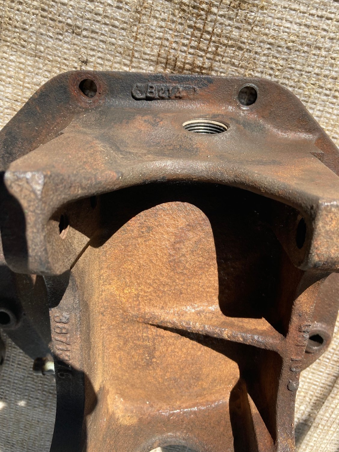

Anomaly? I thought the tapered fill plug began with the 65 model year. I just cleaned one that is cast date on the cover in March 64, assembly date May 64 that has the tapered pipe plug. When did the straight thread plug with the round metal posi flag get replaced by the tapered plug with the plastic posi flag?

Bingo! From the garage to the house, my memory shuffled from fact. Housing is 375 and dates are on diff housing. Diff is assembled 5-64, cast 3-64, but cover is later with tapered plug. The other diff is a 303 cover, but cracked from a long spring bolt and now I need 2 303 covers.

Well, not so fast . Searched my stash and found a 303 (maybe, it’s rusty) with straight threads. While removing, realized my first post is right, still. This cover is a 375 casting with plastic vent and cast date is Feb 21, 64. It came to me on the diff with a March cast date and May assembly date, all 64. Seems strange.
In my stash, I found another cover, no cast date, 303 casting with a tapered thread plug! . It has the plastic vent, GM 8 mold #.

My thoughts are the same. That’s why these 2 seem odd. Don’t fit the “rule”. Guess the dated one (B214) could be 74. Had not considered that.

The 303, tapered plug, no date, plastic vent could maybe be early 65? Maybe some left over castings without dates early in production ?

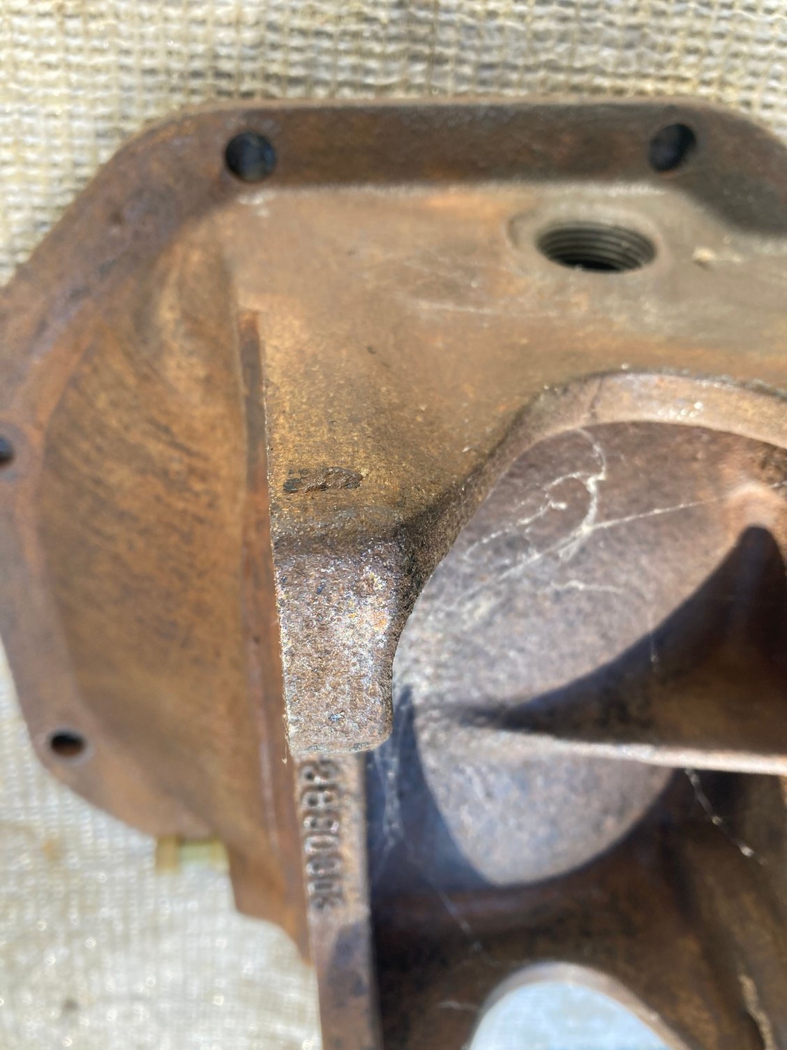

I pulled a 64 diff from my file showing the original cover. No date code, machine plug, metal vent. Now there something I did forget about these covers- look at the bottom 2 holes, the casting has a boss- a raised pad so to speak. The top 2 holes don't.

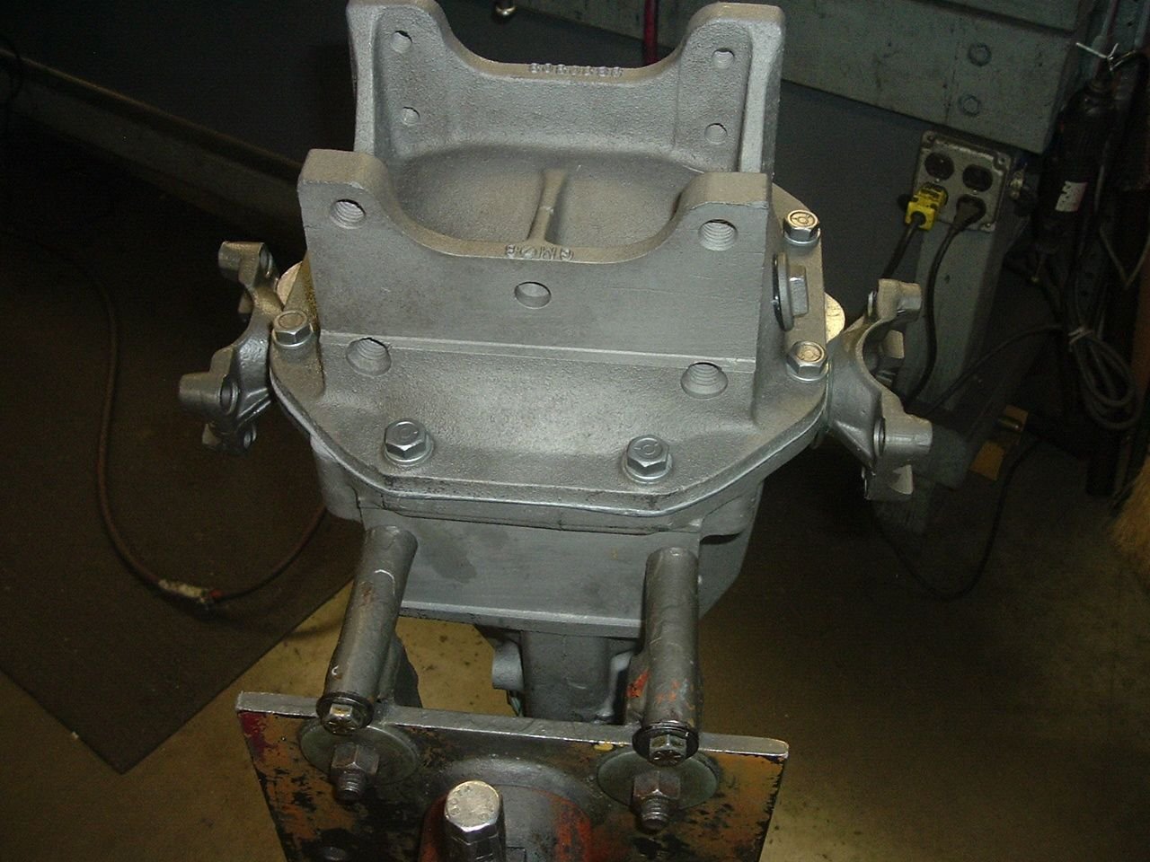

I have an original 64 in house to build as well. I didn't get to it yet so you can see the original yellow paint at the plug.

I had noticed those bumps on some / all as well. Also noticed that the casting changed on the 375 where the top two were not drilled through and tapped as on 303. Looks like more metal added there.
