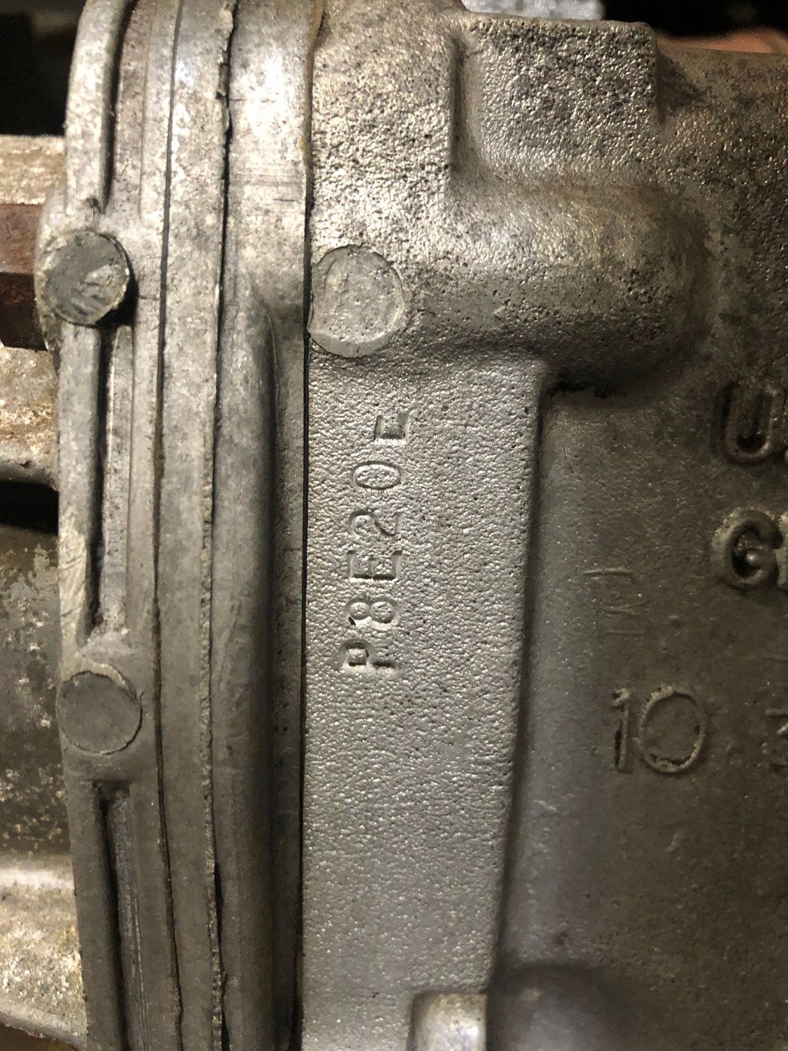

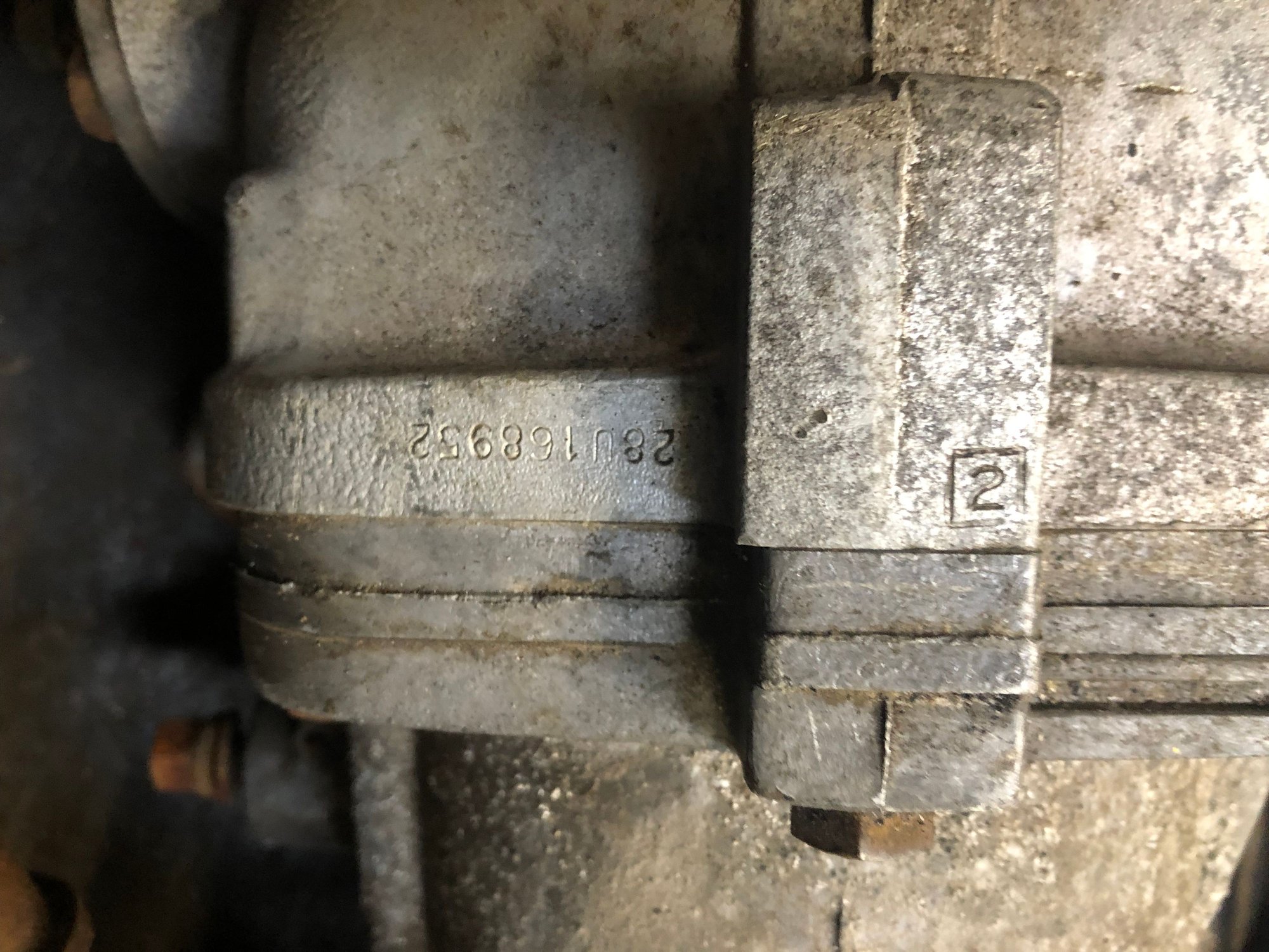

Anyone help decipher this trans code or numbers?

From a quick look, I am guessing you have a Passenger car (includes Corvettes) built in 1968, on May 20th. Are the casting numbers of the case 3925660? That would verify the 1968 build. The small C or whatever it is should be A for M20, B for M21, and C for M22, all capital letters.
I have no clue what the VIN number is for.

It's from some kind of a 1968 Pontiac.
1=Chev
2=Pont
3=Olds
4=Buick
The U is the assembly plant. I believe the Detroit/Hamtramck plant.

based on the “28U”, it looks like a 1968 Pontiac assembled in Lordstown Ohio…. They built 1st gen Firebirds here, not sure what else…

The letter in the VIN is NOT for the plant where the transmission was built ----------------------it is for the AUTOMOBILE assembly plant where the transmission was installed in the car.

I was not sure of the plant for a U. But from what I could find, it looked like the U was for the Detroit/Hamtramck plant.
The 28U is Pont-1968-Plant. What plant would the U be for?

I think “U” was Lordstown, Ohio
