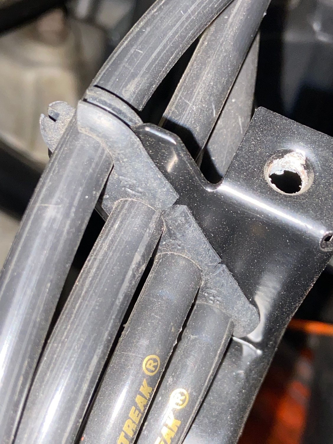

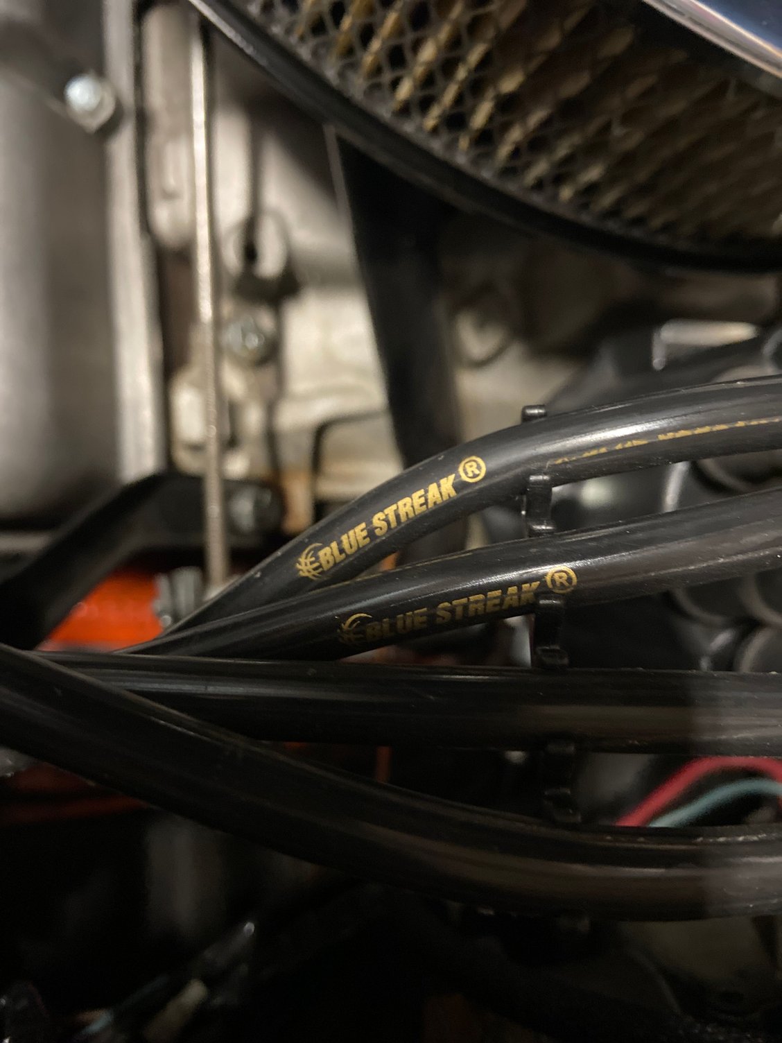

L78's Avatar
L78
Joined: Nov 2004
Posts: 1,508
Likes: 678
From: Folsom Ca
Originally Posted by mudbone64
I was doing some spark plug wire research and from what I recall found these to be of low resistance. Though I haven't purchased any wires yet I did shy away from the Bluestreak's because of their diameter but you're now making me reconsider them.
I wasn’t planning on using the stock looms, but I gave it a try. My car came with old yellow wires and no shielding…
You can see the grommets have some gaps that won’t close due to the size of the wire…. The grommets are also snug in the brackets too…
