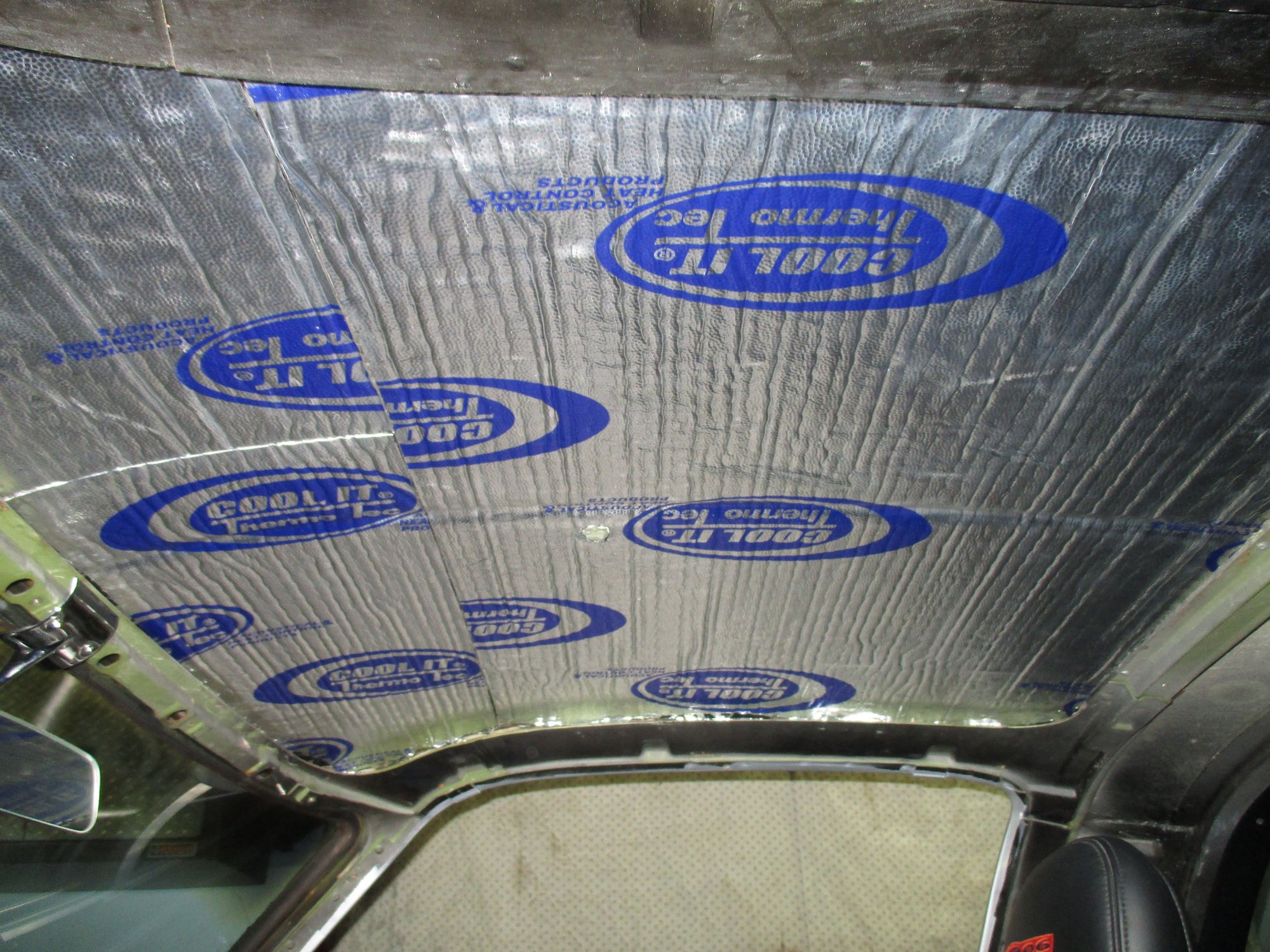

Put a thermo barrier on first. If car is left in sun heat will compromise glue on these new headliners.
