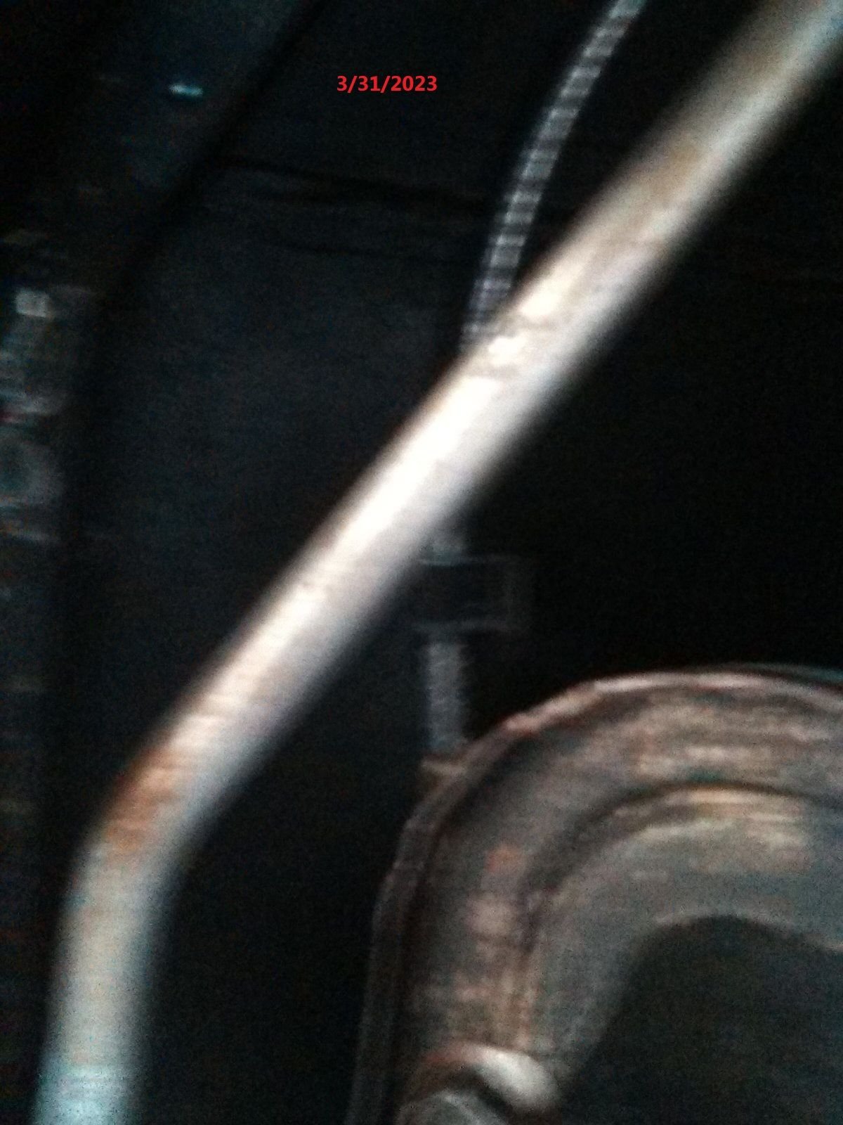

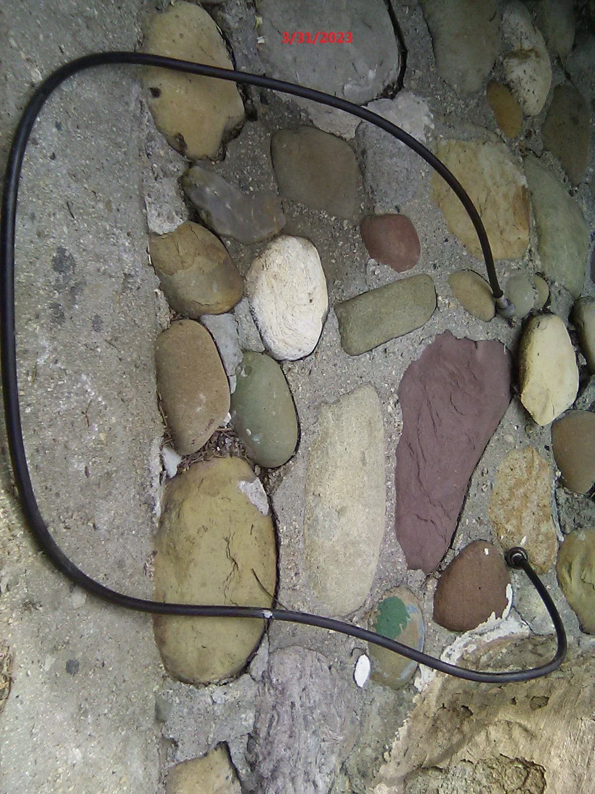

Attached are pictures of the tool and the cable removed and new one installed. I have NOT tested the car yet but would be very surprised if it does not work. If it does not work, it is something beyond the cable for sure.
LG,
Mike
New ZIP steel cased cable.
Old rubber coated cable that was removed.
The tool that made unscrewing the cable at the speedometer possible.
The new cable is supported by the two hooks designated for that purpose. The OLD cable was not and may have been too short.
