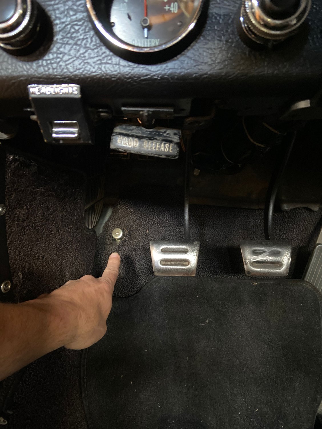

As noted previously, there should be a switch on the floor, on the left
Pull the headlight switch out fully, and then push on this switch with your foot, and each time you push it, it should cycle between high ( four lights) and low beam ( two lights). There is no “ off”, although broken switches or corroded connections can cause malfunctions.
