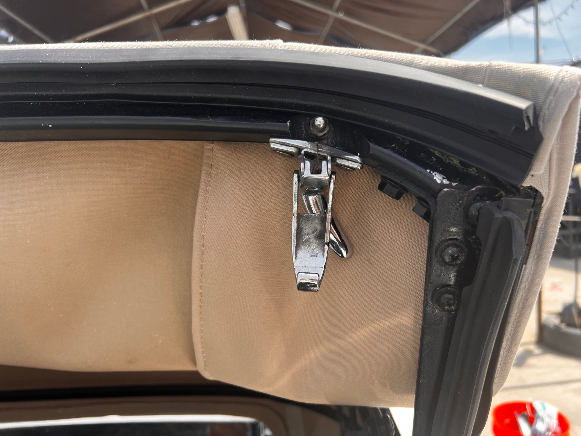

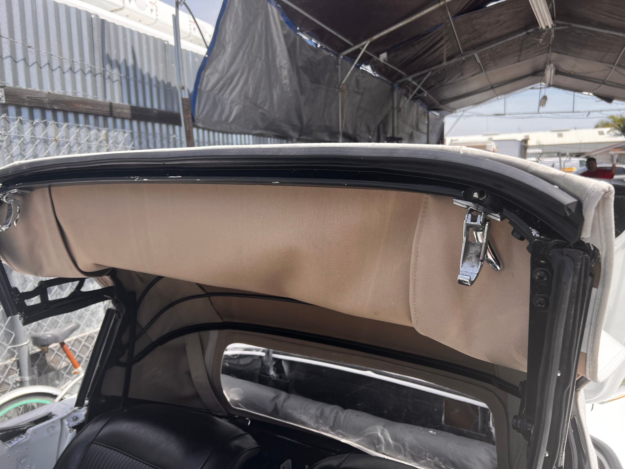

Happy Easter all. I ordered a new soft top for my '61 and had a local upholstery shop install it. The results are mixed. I was worried that they might not make the top tight enough and, of course, it's now too tight. It's VERY difficult to snap the latches once it's up and equally difficult to get the top's mechanism that spans the door openings to straighten out. The installer has promised that he can loosen it up it up a bit but says that first we need a missing a part on the forward edge of the top. I have gone through the assembly manual looking for a missing part but don't see anything. I'm hoping that by posting some pictures of the top that someone in the Forum can identify the missing part(s?) if any. Thanks as always for everyone's help.

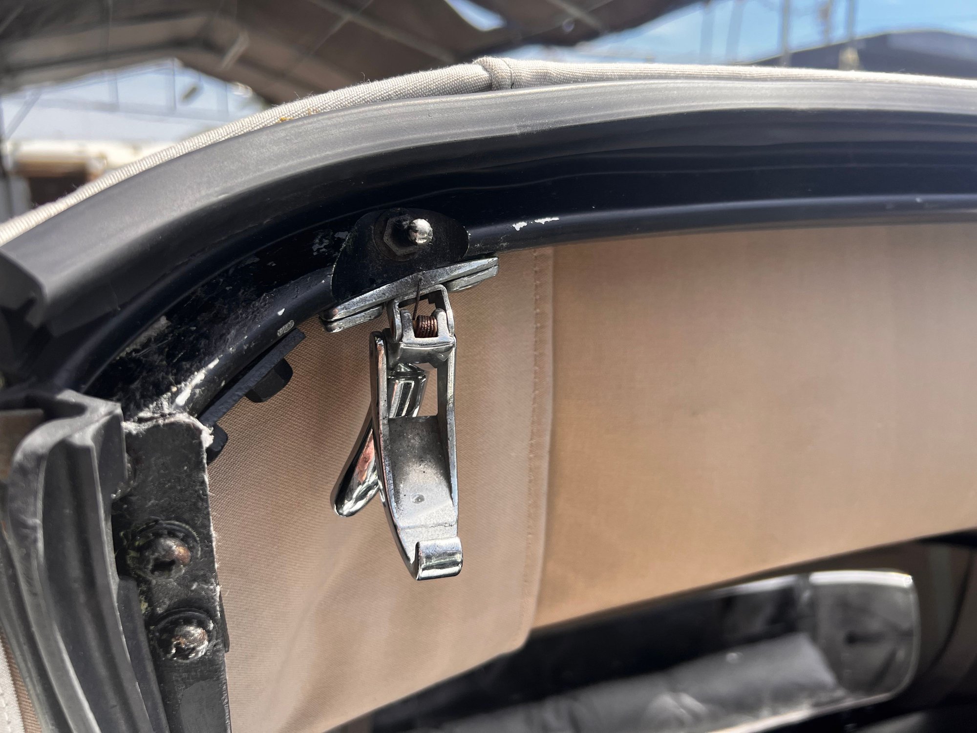

From your pictures I don't see anything missing, you have the 1 latch asm, 2 latch adjuster plate, 3 pin.
I would ask your installer what and / or where he thinks something is missing.
With the adjustment mounts behind the seats you might be able to loosen it a up?

The front header bow weatherstripping is on backwards. When that is repaired, the top is going to be even tighter. I’d find another installer if I were you. As mentioned previously in this thread, damage will occur to your windshield posts and frame if it’s not installed correctly. I don’t see anything missing.

I am by no means well versed on convertible tops,however I must agree with Mr Coletta. The top on my 61 reflects all of the parts yours does and I agree the weatherstrip is on backwards. Hope this helps, I can post some photos tomorrow if you feel that would help.

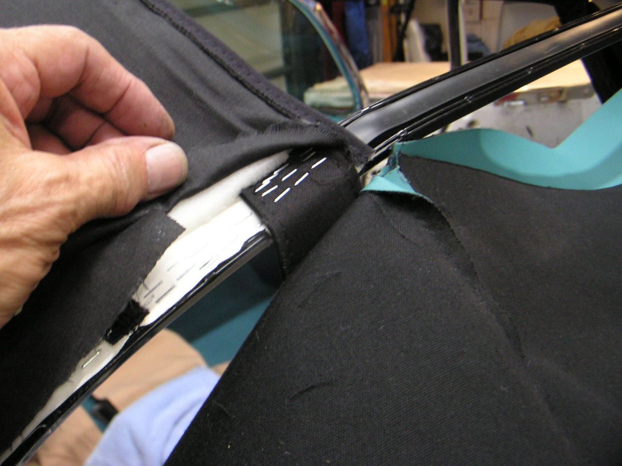

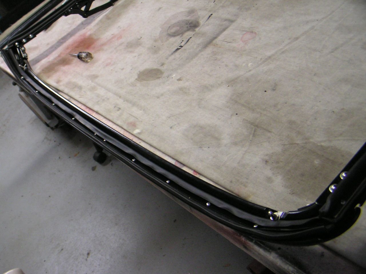

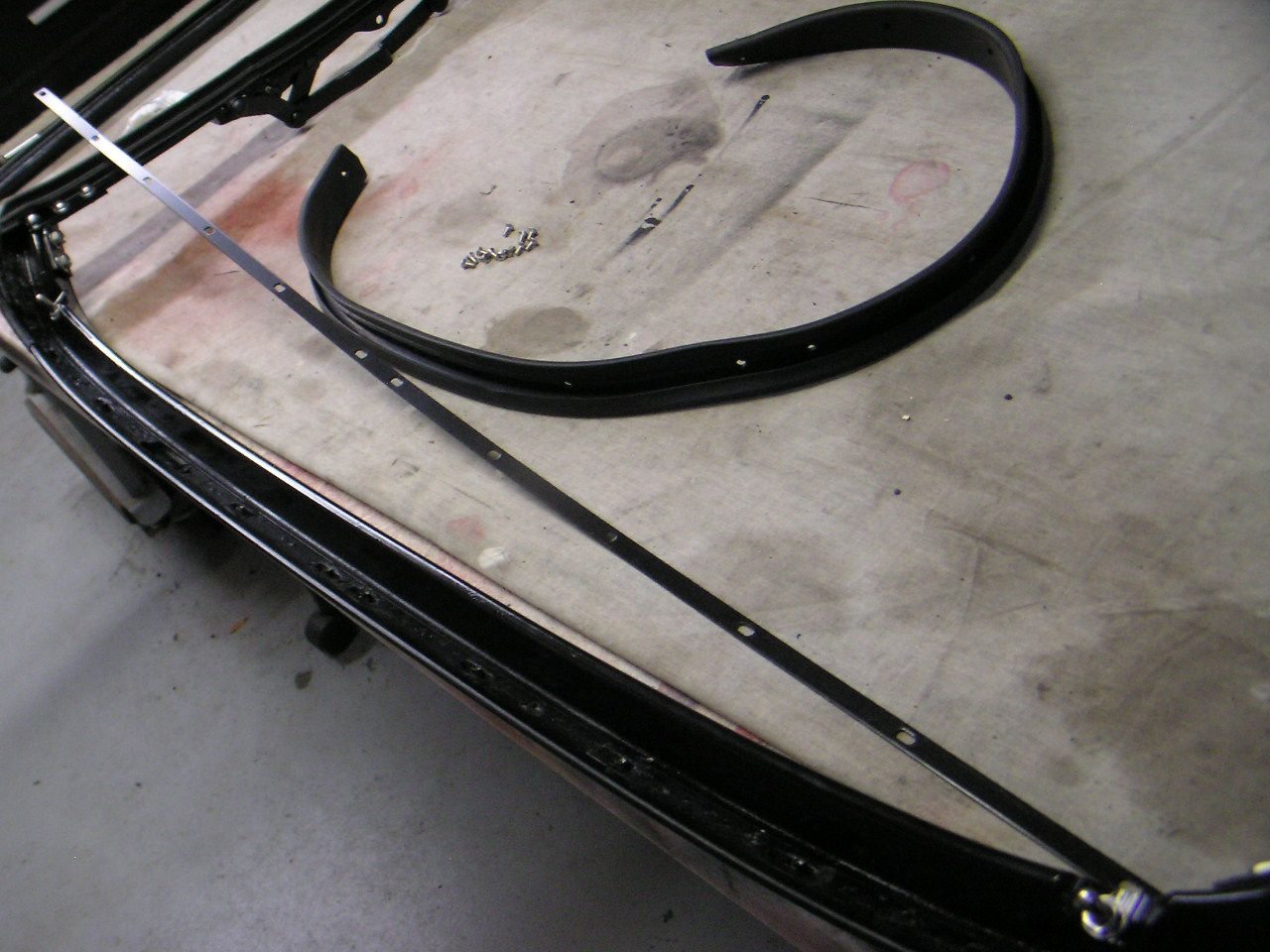

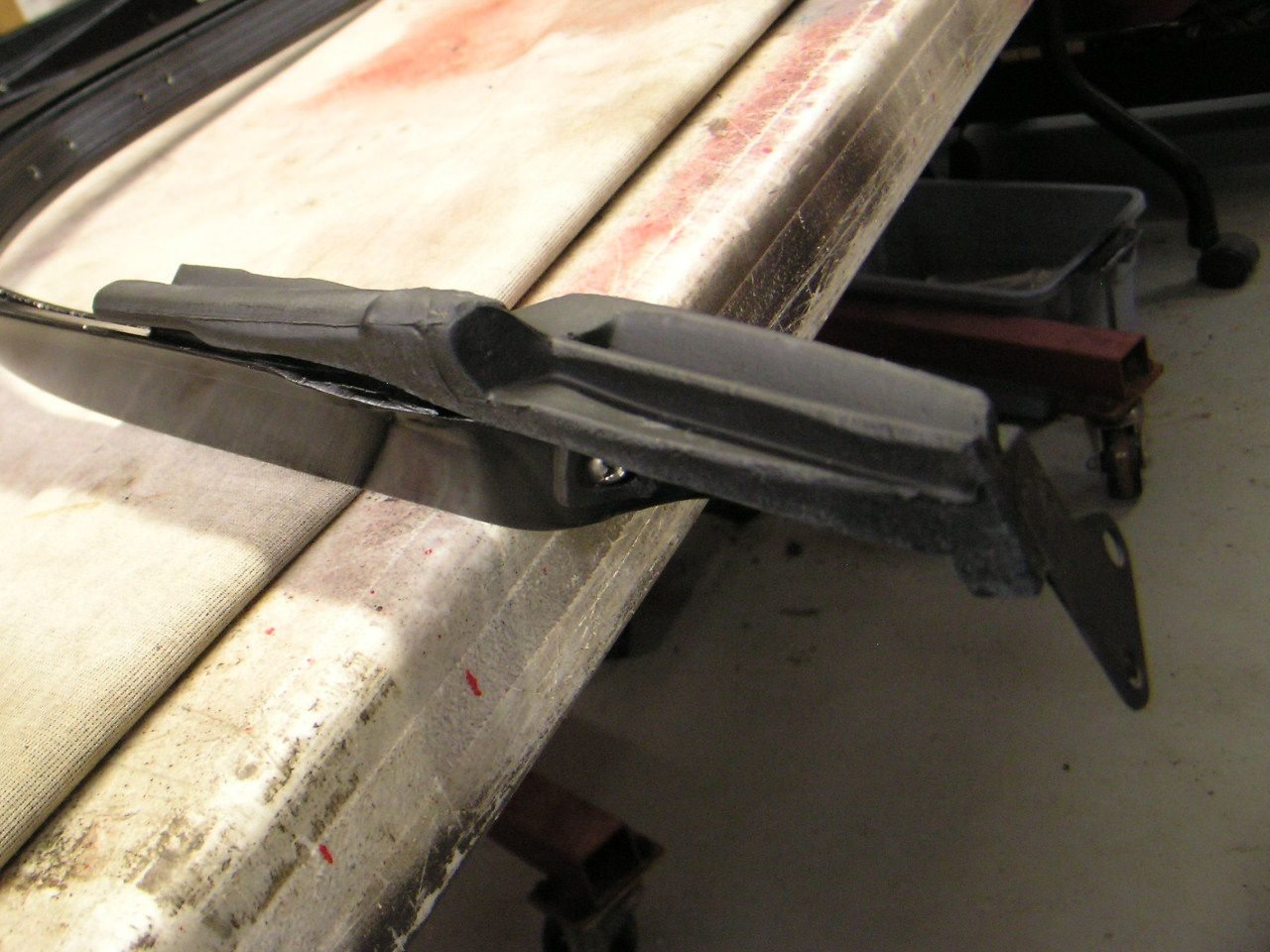

The only way they can loosen the fit is to pull all of the staples from the header and bring the top material back and re-staple. But to do that it may mean you'll see the old staple holes. It appears to be a Sta-fast top so it may not be as obvious, but no way to know until it's done.
Hard to see, but besides the header w/strip on backwards, it appears to be missing the long steel header w/strip retainer. Why didn't they ask you for that before they did the job?
It's full width on 59-62. Zip CT-62 (note they fold it for smaller shipping container) 56-58 used a 2 piece design, one on each side of center. Zip CT-368
(60 below)
Also notice your rear window side straps, where they attach to the #4 bow on yours.(white circles) They're installed wrong, in fact they're off differently on each side. There's a recess in the #4 bow on each side where they should be stapled. Appears you're missing the lower corner w/strips too.(red circle)
Here's where they get stapled. A '59 shown but same 56-62. The recess is also where the edges of the top pads fit.
A 60 for reference.
Corner w/strips.(61-62) Zip WS-344

Everything that Rich said is 'SPOT ON". I missed the rear straps in your original post. It's pretty obvious that your guys don't have a clue what they are doing. I can't even imagine what the pad alignment looks like. The sagging center (over the side glass), is a top frame adjustment that is done PRIOR to the pads being installed. Get your car away from these guys. They CAN'T fix it.

Mike, I missed his comment about the side-glass frame sagging. Now I'm wondering if they couldn't fold the top into the well and moved the arms to get it to fold down. My bet is they've never done a C1 top before. Sad to see the owner dissatisfied with the work done here.
I'd also like to see a few external photos of the top raised and latched and the side-glass areas too.
