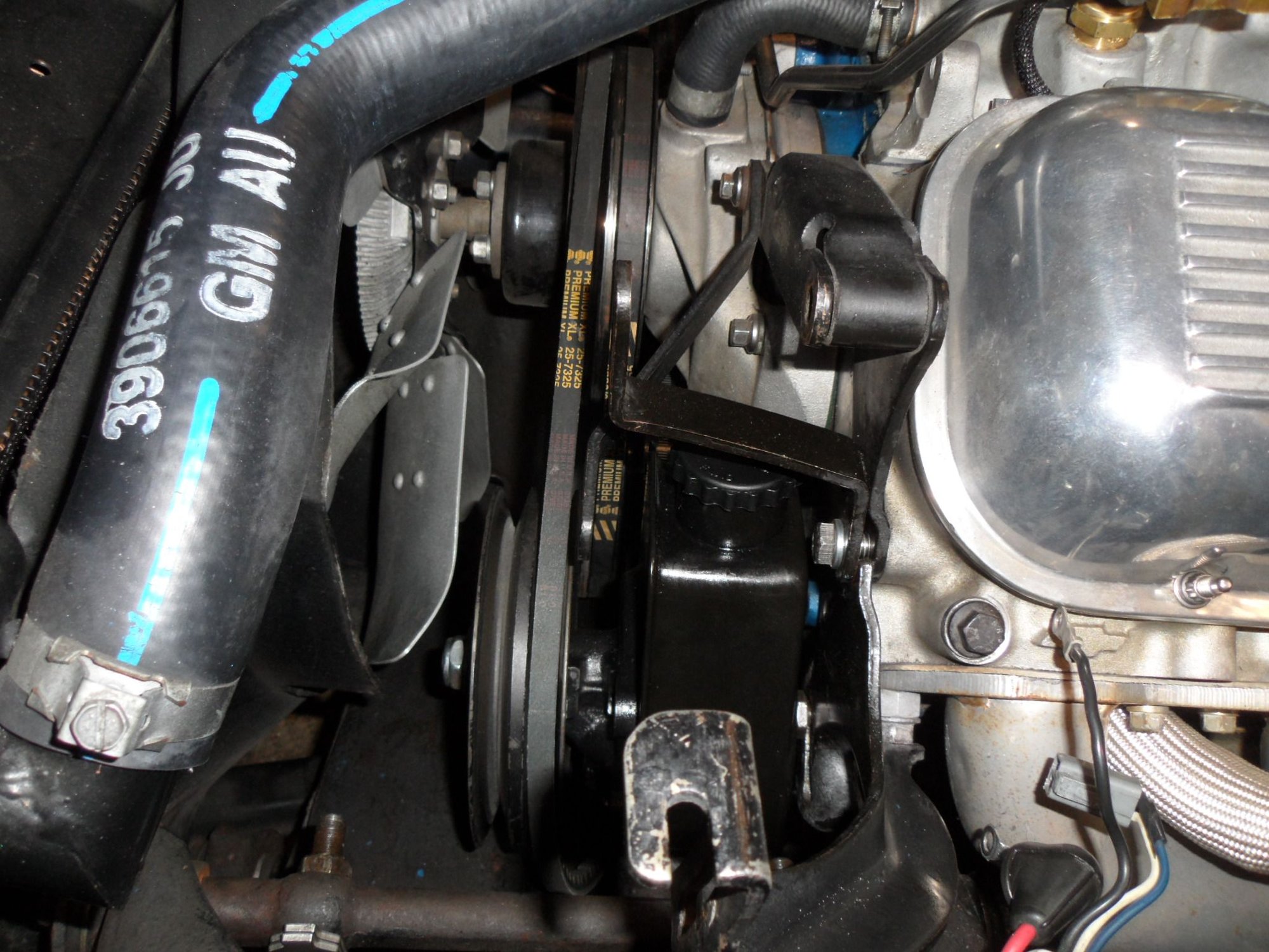

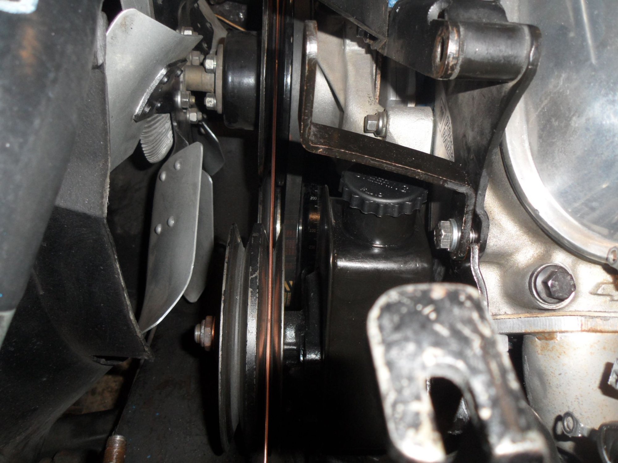

i bought a new PS pump from Borgeson , but now the pulley is to much forward , about 10 mm .
Is there a pulley that runs more inward ?
I could shim the alternator , but here "waterpump to PS pump" i cannot do anything .
Thanks for info !

There is a 7 mm high boss inside the pulley center.... i will remove that ( lathe) and see if it get's "acceptable" in line . That should be already a lot better.

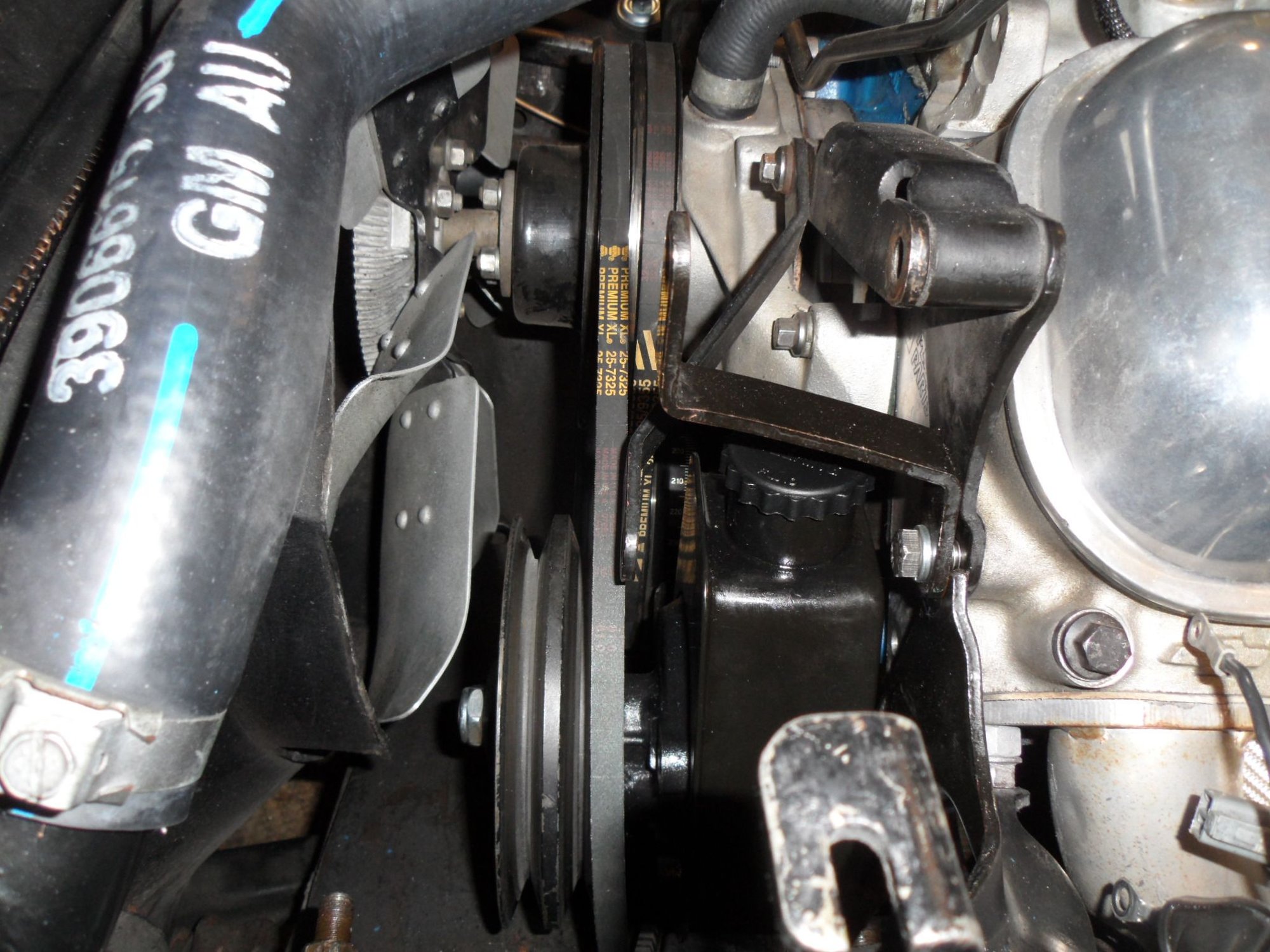

It is a GM cast iron pulley.
That way was very easy turn off the boss inside.
Must mount it now to see what i gained in belt alignment.....

i got it perfect .... think i removed 7 mm of that inside boss on the pulley.
And... the new nut delivered on the pump is really crap , nylon locking part and at max 3 steel threads ! so if you put your 7/8" wrench on it , it's already to late., don't ask me how i know....
lucky i had my original nut of course , all steel with on top a steel locking part.
Tomorrow i go for a new belt , the old one doesn't seem "fresh" to me.
I like the setup that at least the waterpump is driven with 2 belts ! one can loose PS and alternator but still on the road for a bit of time ... ignition will drain the battery in the end.
