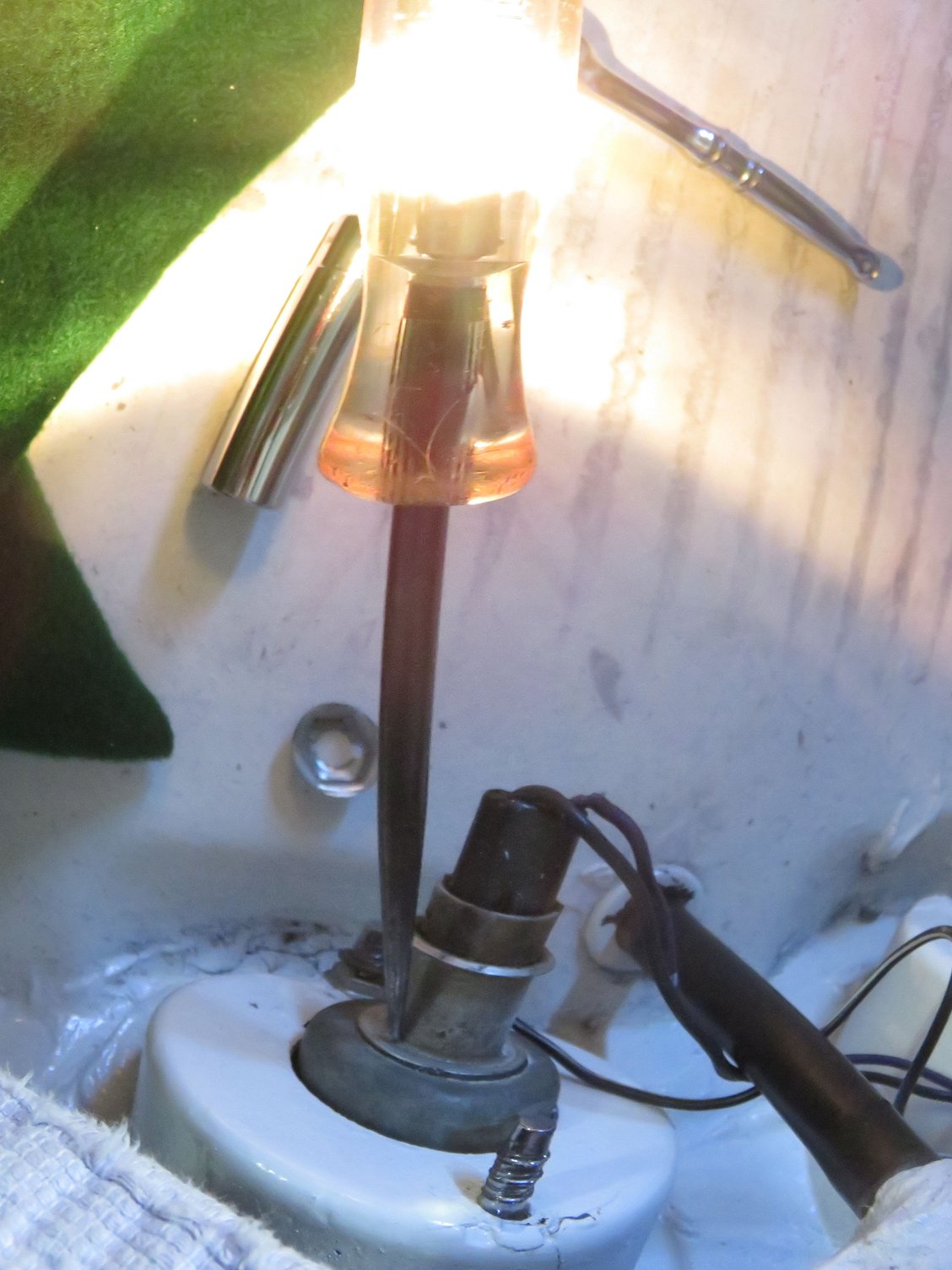

You probably have a bad ground. Remove both park/signal light lenses and using a good test light, which is grounded directly to the negative side of the battery, probe the brass part of the bulb. If the test light glows you have a bad ground on that socket. This is not a "Corvette" socket, only used as an illustration.
Or as the second pic shows, I removed the ground wire on my 61's housing to illustrate how the test light glows with no ground to the housing.
Make sure the park lights are on when doing the tests.

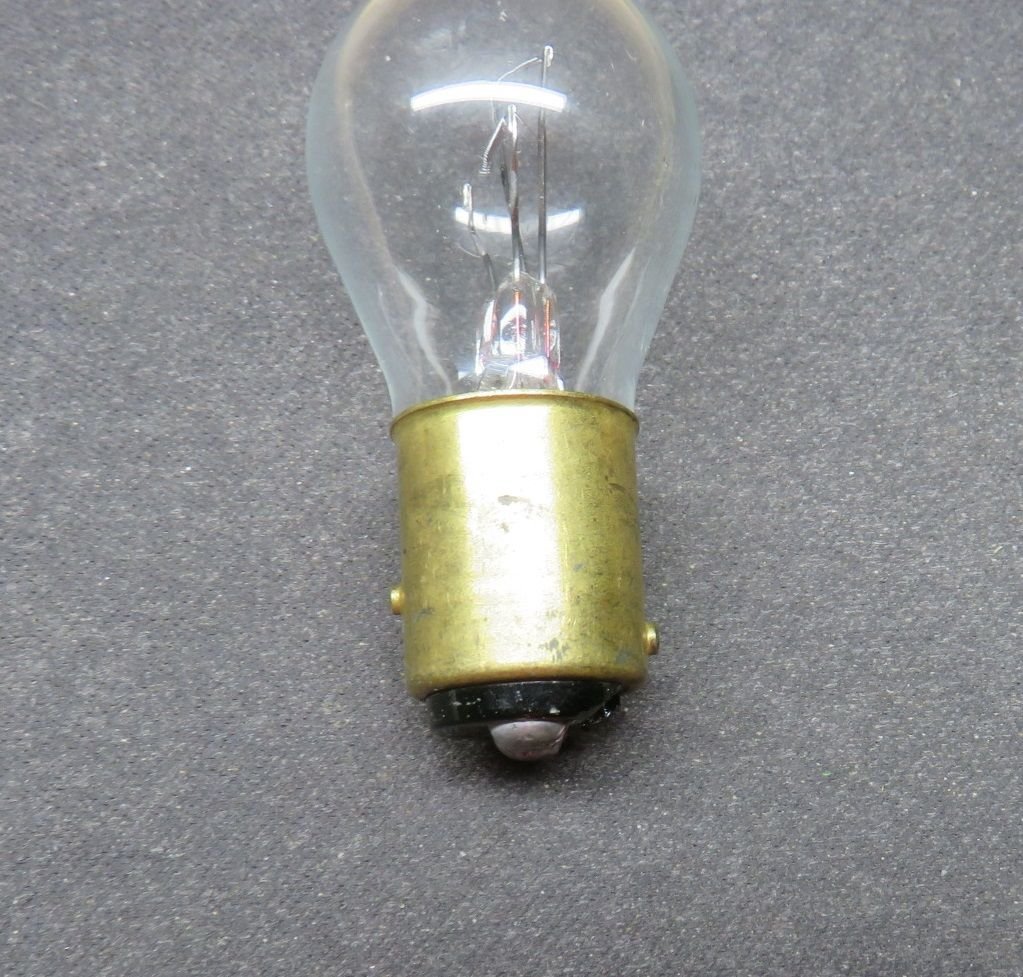

Good reply, I will preform that test. Do front parking/ts bulbs have double elements?

Yes, also when you have the lenses off check to make sure it is a double contact bulb with offset pins. Also make sure the pins are aligned with the short and long slots in the socket.
I have seen a signal contact bulb forced in and the index pin bulb put in 180^, I also seen, in rare occasions, when a non-indexed pin double contact bulb put in.

Yes it is a double and has two elements in the bulb. The pins are correctly seated. Checking all ground connections today.
