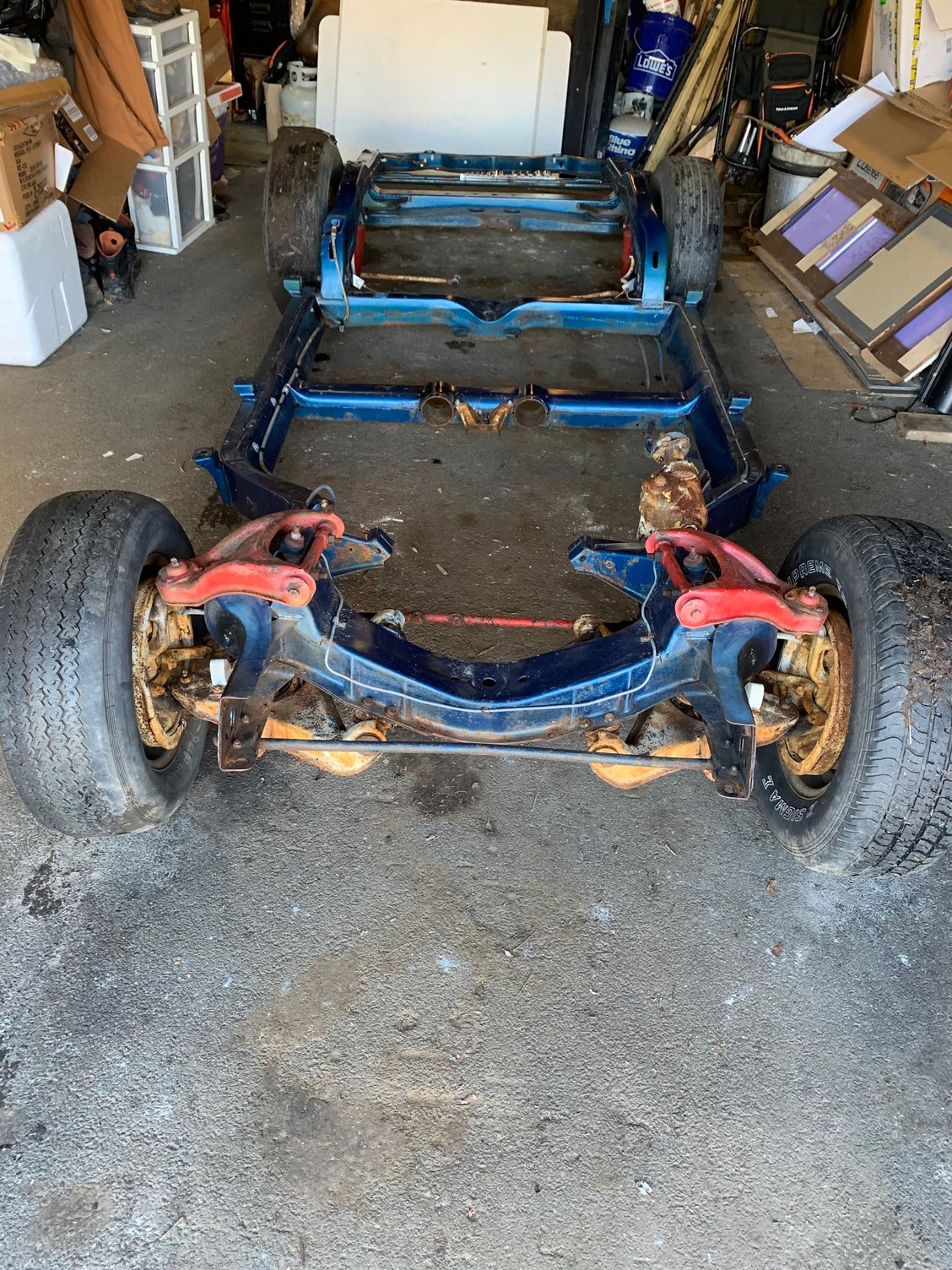

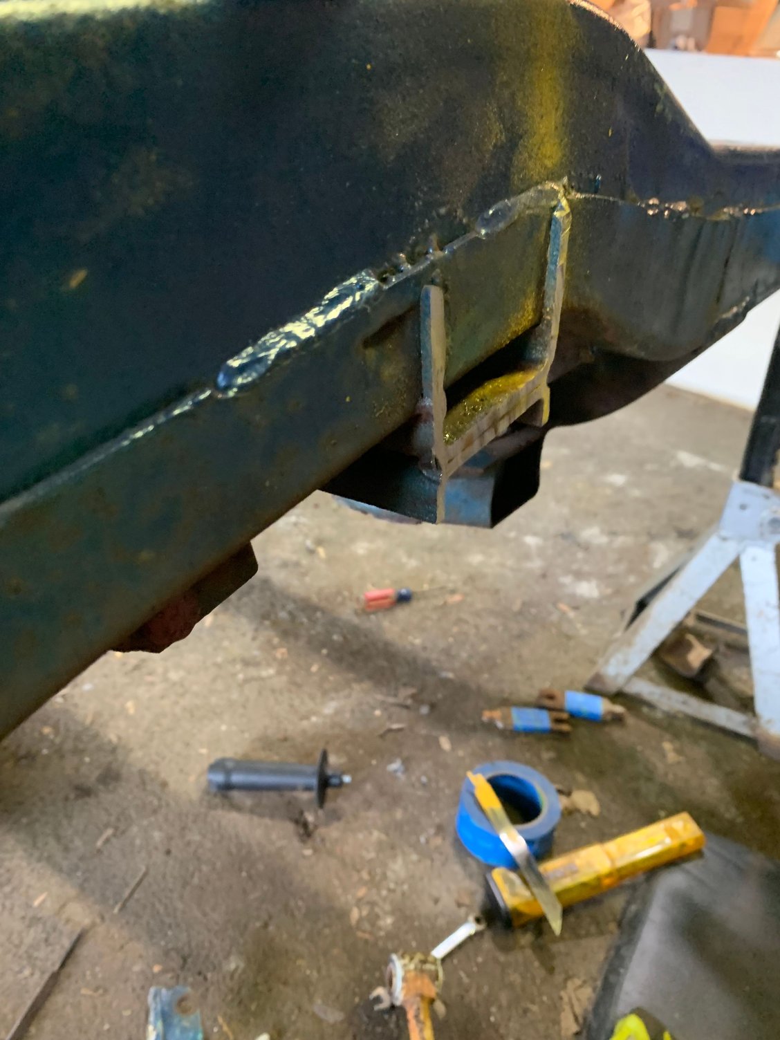

Well it’s been a while since i posted an update so I thought I would share some progress. Moved the 63 chassis in the garage displacing my wife now that we have some better weather. I removed all of the suspension, steering, and lines. I had to cut off a rear shock mount that appeared to replaced at some time which was at a bad angle. I couldn’t believe the rear TA shims. They were slotted at the pivot bolt end and were not captured by the lower pocket in the frame. Apparently just rust and the nut and bolt holding them in place. The front coil springs were not indexed in the lower control arm seat and the upper control arms had no shims. Spring removal went smoothly with a coil spring compressor. I also cut off the rear trailing arm bump stop bracket’s flush with the frame to make room for the Wilwood disc brakes and offset trailing arms.
Next steps cut the transmission crossmember and weld in the aftermarket kit to make the center removable.
