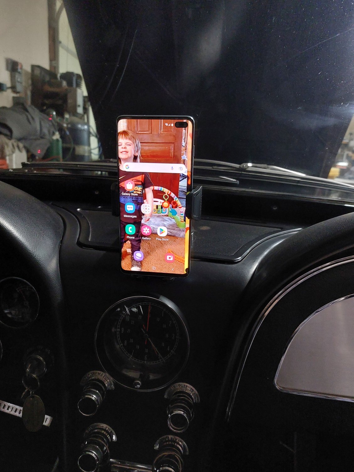

I don't use it much, but I bought a cell phone mount off of Amazon and put a magnet on it to stick to the speaker grille. Then downloaded a speedometer app. I can use it as a speedometer, trip meter, hands free phone, and GPS, as all is built into the phone. Bluetooth to the aftermarket radio can play music, etc.
It releases quickly and can charge from the cigar lighter. Cheap - about $15 or so.
Just an option.
Glued plastic under the magnet to prevent scratching the paint
Can also be used to video trips and traffic, front and rear with the top down.

I’m interested in that mount and would like to know the brand and model, please.

If you mean me,
Amazon Amazon
The price has dropped a bunch. Of course, you have to go to Harbor Freight and buy a 2" dia. =/- magnet, remove the suction cup and bolt the magnet on. I don't remember the hardware (bolt and nut) size. I used nylon sheet on the magnet, but felt or something might be better.
New cars don't have any metal in the dash, so they are SOL.
