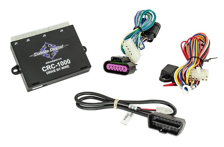

Dakota digital makes one and there are a few options for controls, turn signal, push buttons etc. I'm setting it up on a 68 Camaro LS3 very soon.
https://www.dakotadigital.com/index....od/prd1004.htm

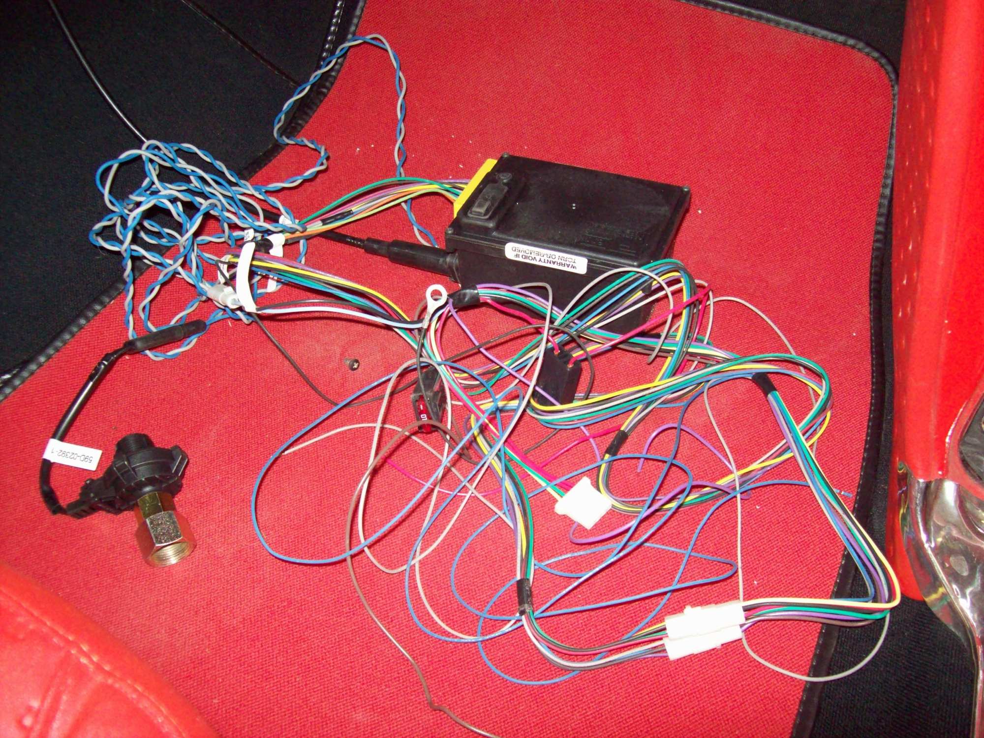

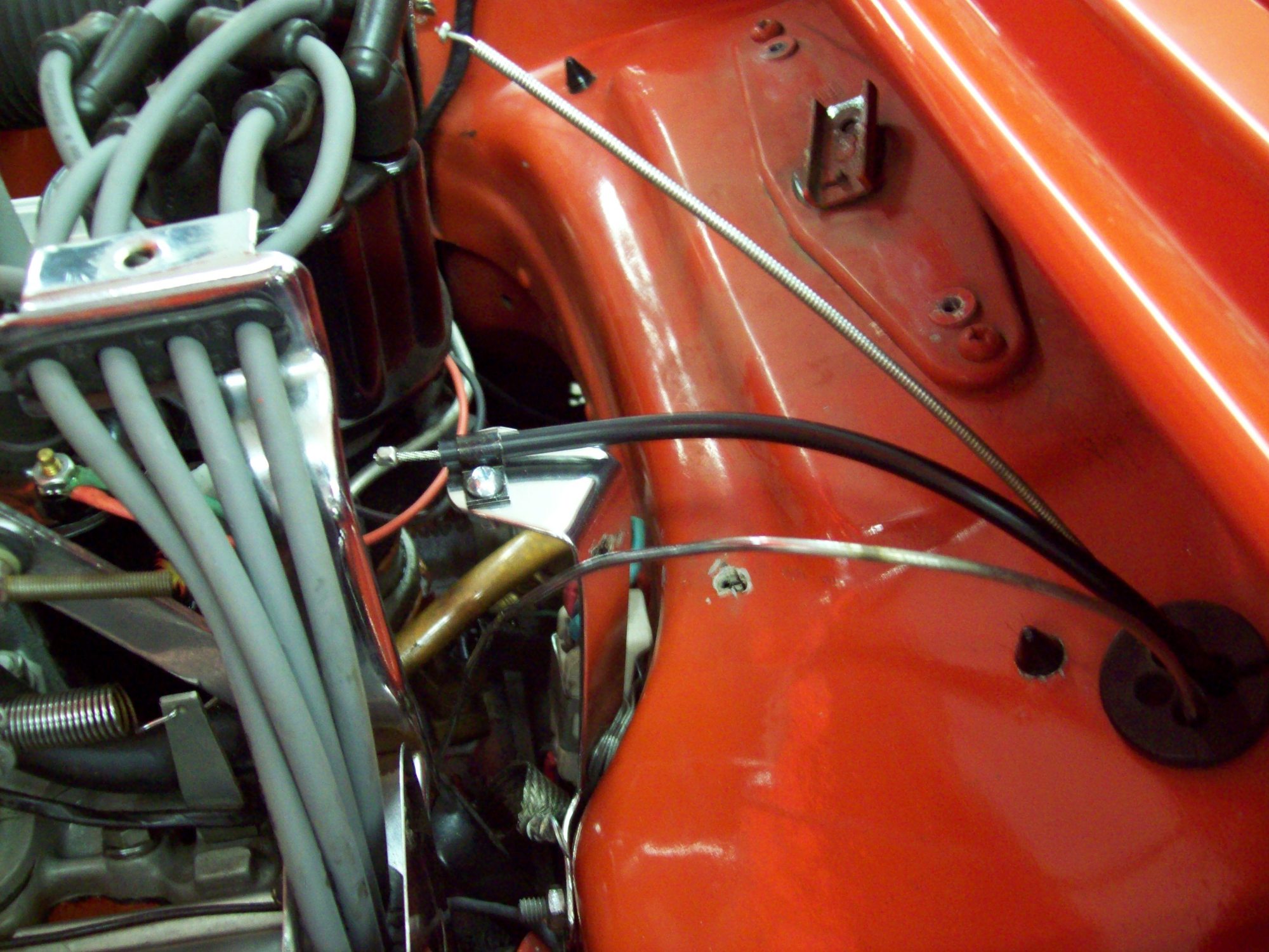

Several years ago I installed a Rostra cruise in the 56. It works so good that you would think it was factory GM.
These two pictures are everything. Looks like a rat's nest, but it is quite a straight forwared installation.

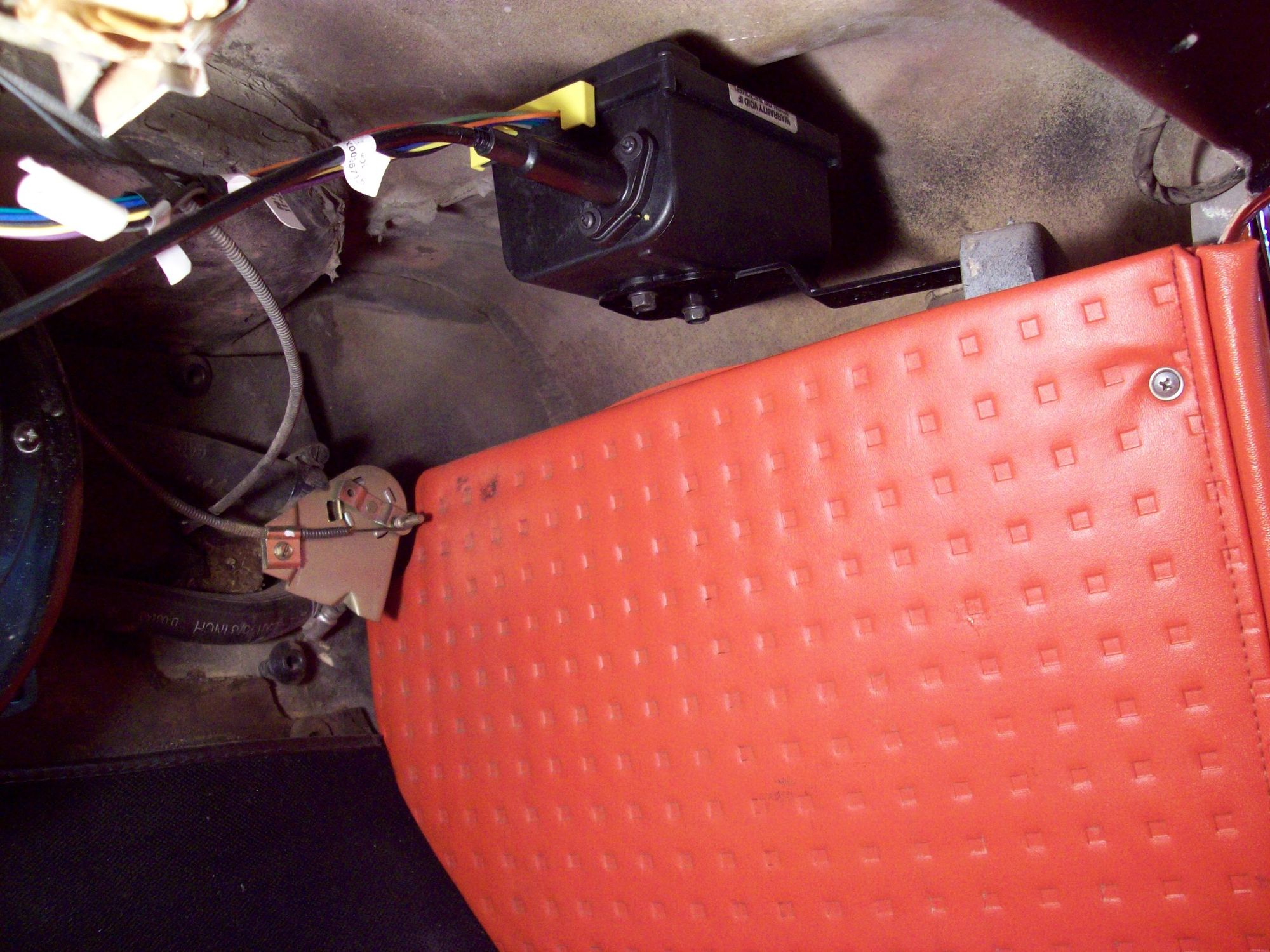

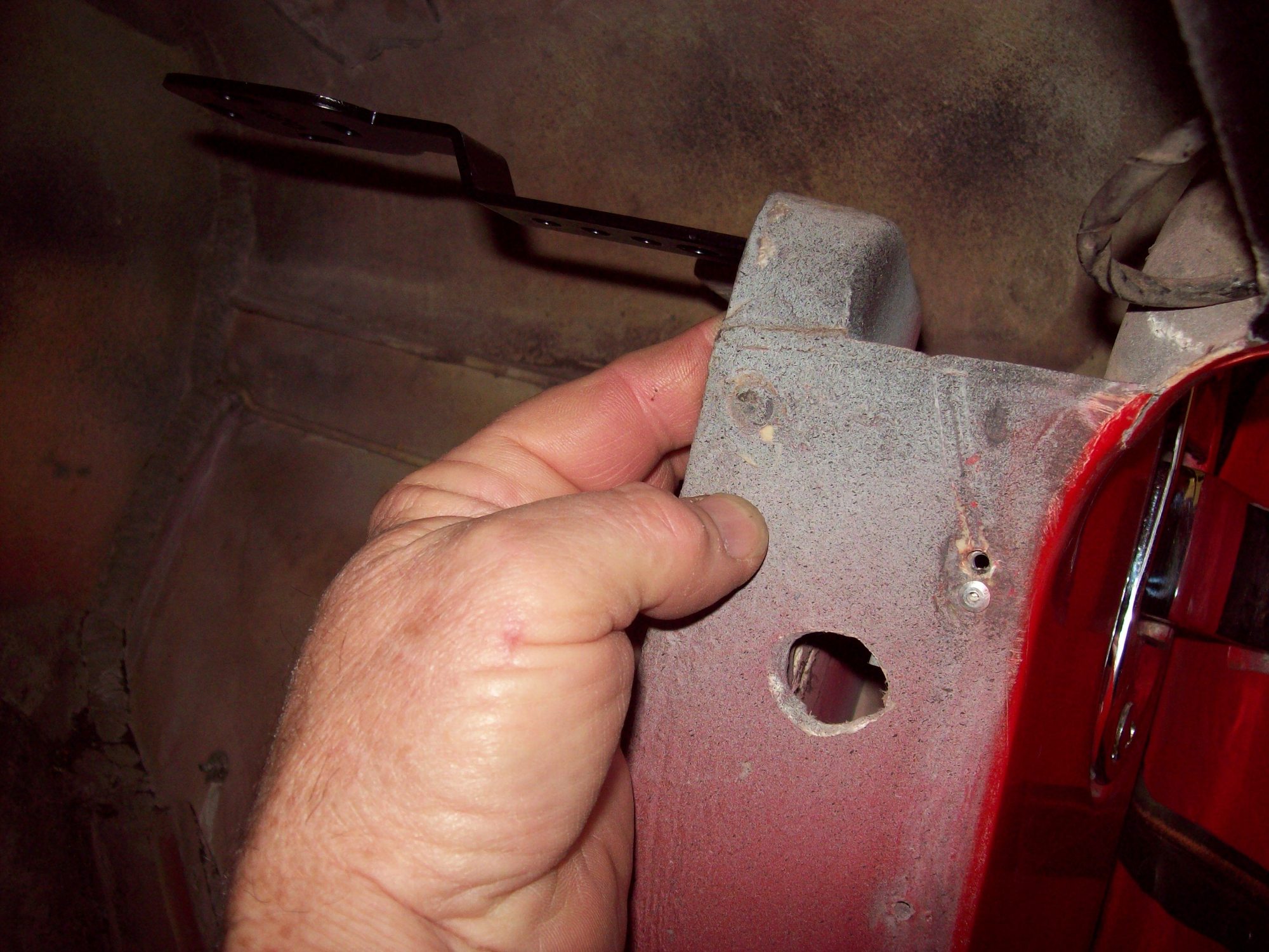

I installed the cruise module above and behind the right kick panel.

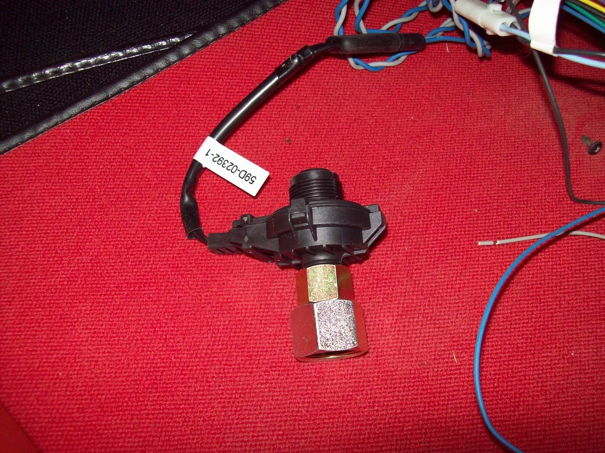

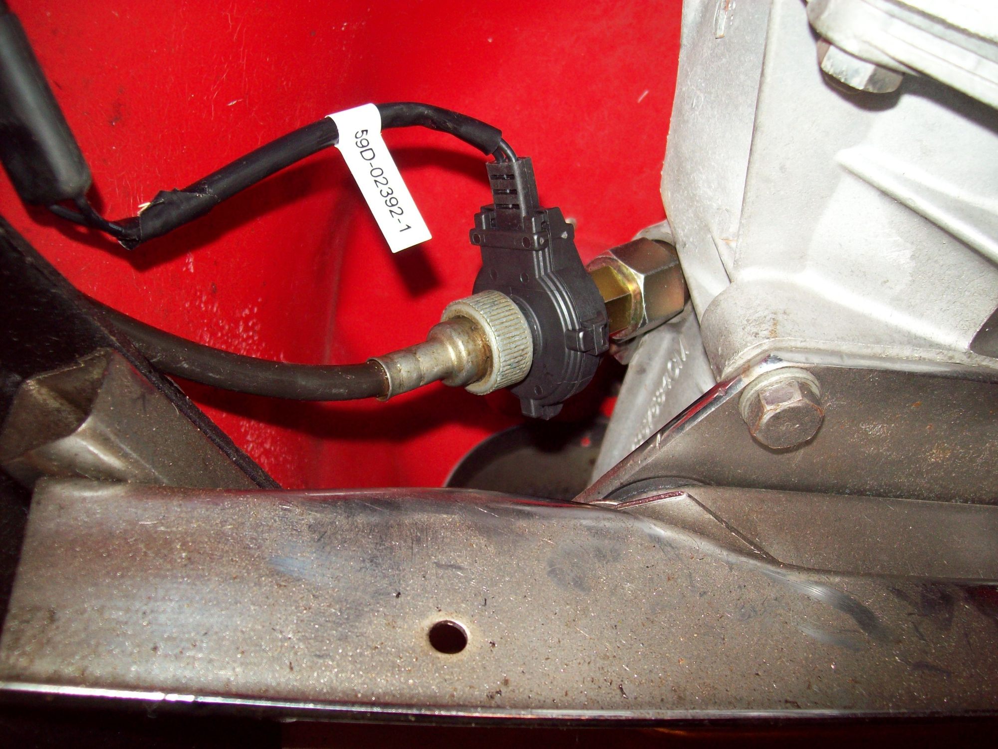

This is the speed sensor which is easily installed between the speedo fitting on the transmission and the speedo cable. Too easy!

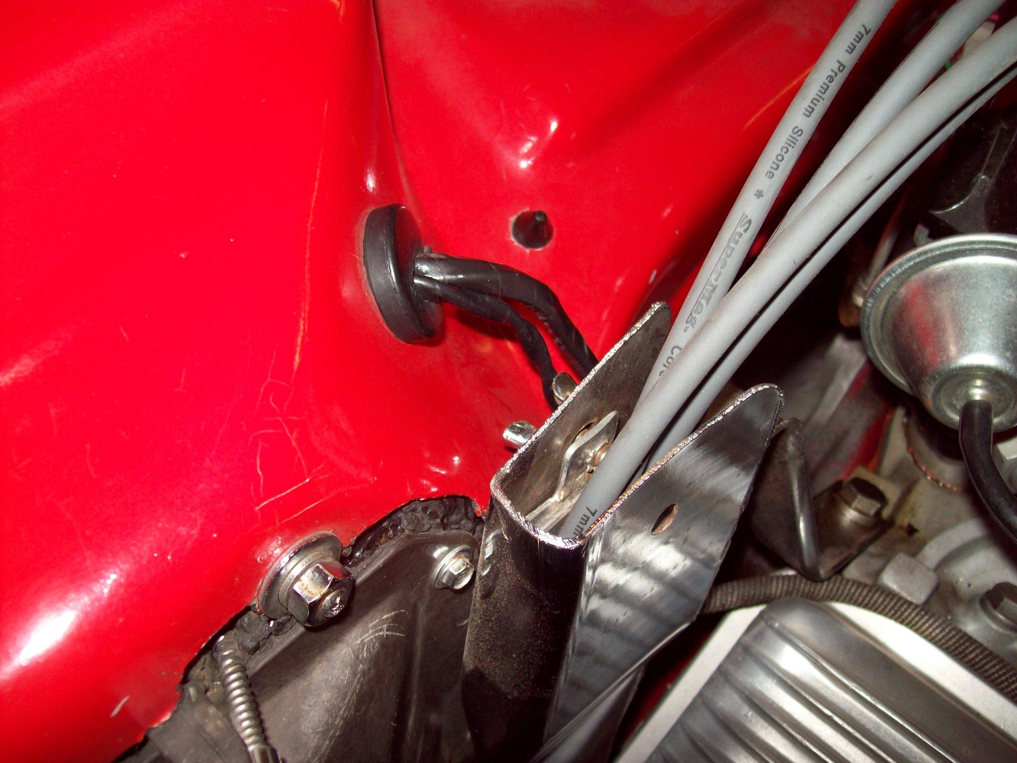

I used black elec tape on the 2 wires for the speed sensor and routed them along side and through the existing grommet for the starter wiring harness.

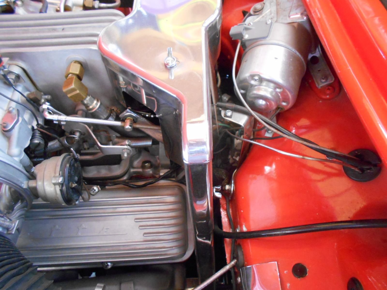

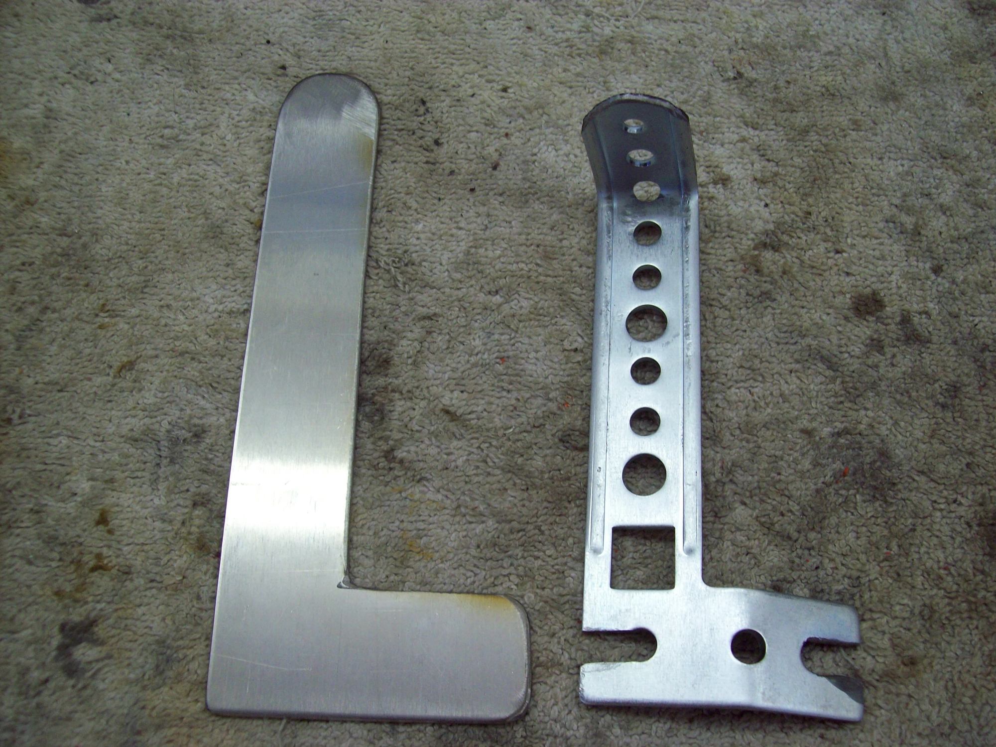

I did not like the universal bracket for the throttle cable, so I made one from some stainless sheet.

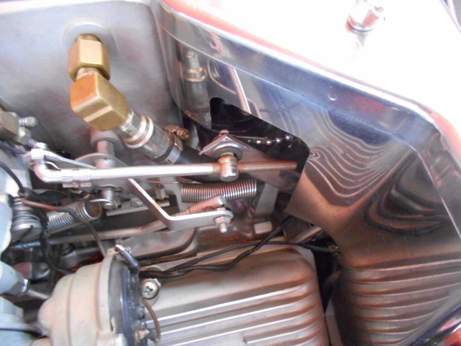

The black cable is all that shows coming through the firewall and it connects with a little chain to the throttle bell lever on the FI unit.

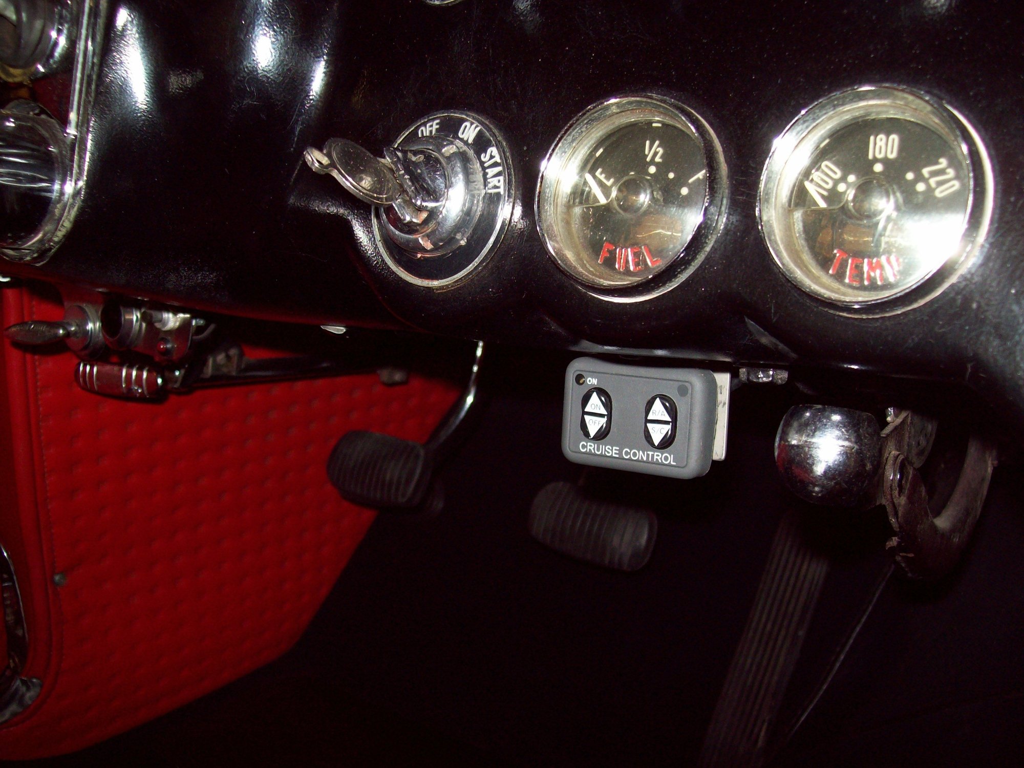

Several controllers were available. I chose this under dash controller. This is what Jack Fit had on his car when he toured all the states and spent the night with us.

DZAUTO-- that rats nest you used won't work for the OP, he is "fly by wire", no throttle cable/linkage, but the Dakota Digital setup mostly plugs in with a few connections for power, brake lights etc. Much less "stuff too" but only works with fly by wire LS swaps. (See and we can do that with saying AAALLLLLLLL LS Swaps lol)
