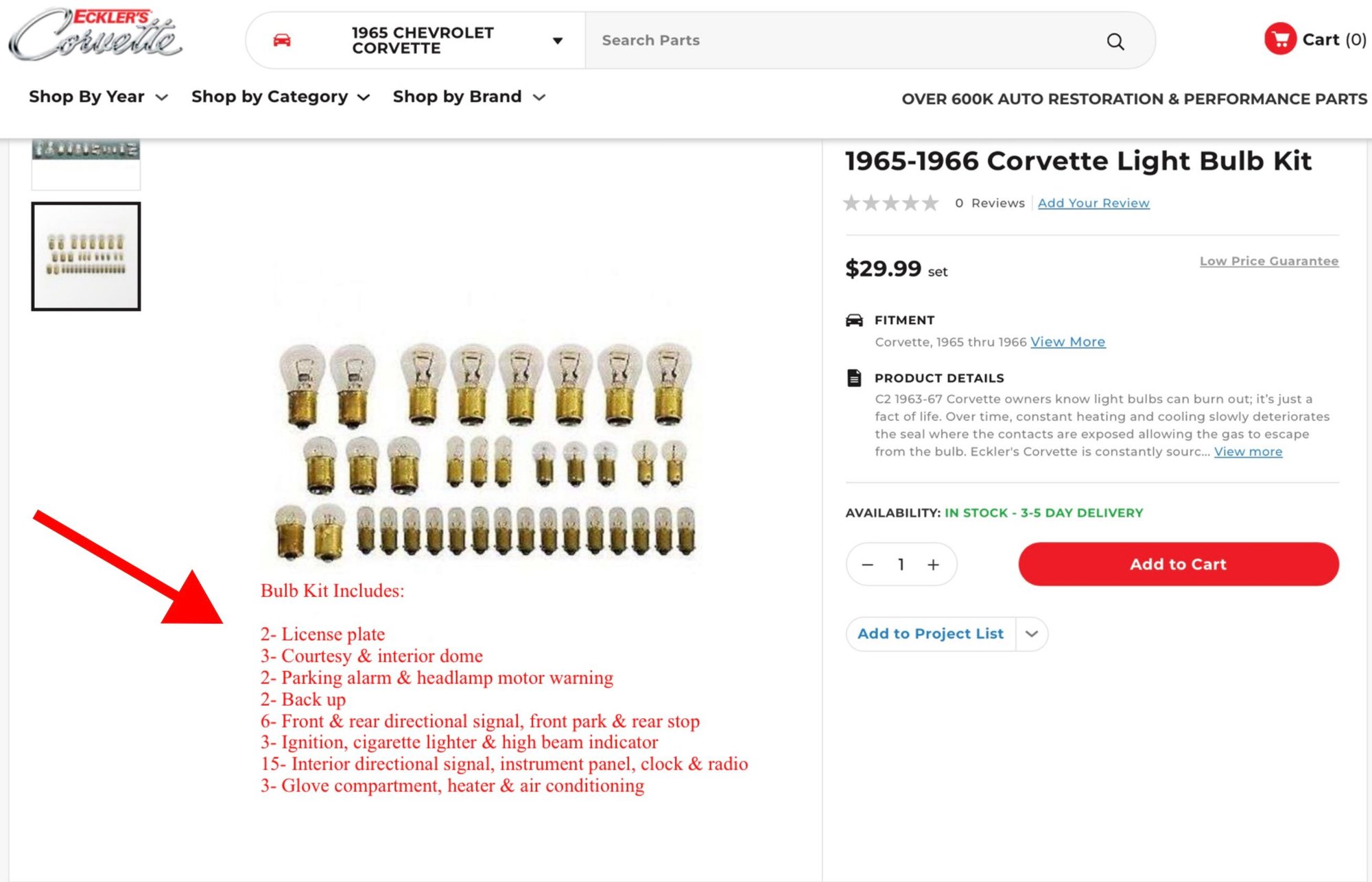

I need some help folks, and I know many of you have done this in the past. My ‘65 L76 is getting some work/upgrades done. While the instrument cluster is out, I want to convert all bulbs to LED. Please look at the photo below (36 Bulbs are listed).
Does anyone have a list of the 36 LED bulbs I need for a complete conversion? I will most likely use SuperBrightLEDs.com I simply want a “BreakDown” of which LED Bulbs to order, and how many.

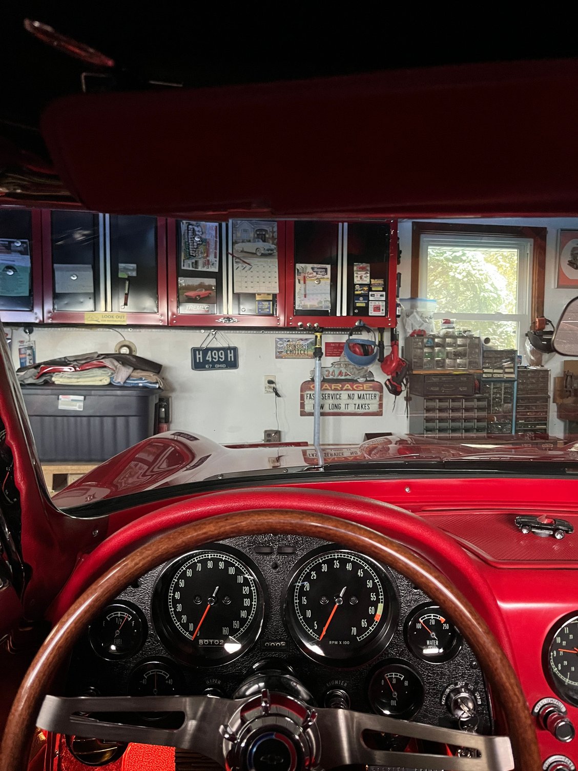

I changed the gauge and interior
You can see the differnt bulbs
The finished dash....sweet

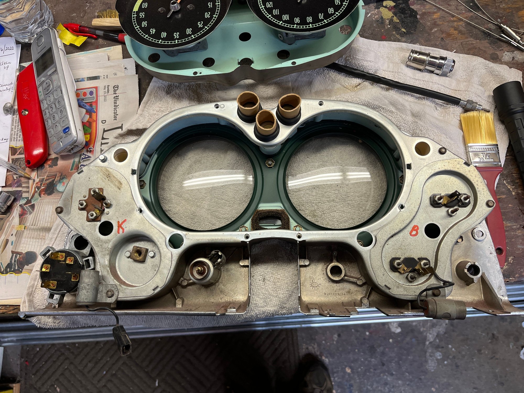

lighting to LED, bright as you can get. I ordered. From e-bay NOS bulbs for the turn signals, the brake and head lamp indicator lights. Brake indicator is a special flashing type bulb that is not made in LED format. These 4 bulbs do not need to be super bright. My LED bulbs do work with the dimmer function. You will need bulbs that are smaller in length for the cigarette lighter and ignition switch lighting. No current production bulbs are made in USA that I could sorce.....I do not trust China bulbs to last! As for the LED-s buy the best brand with good reviews. Most of the bulbs require the dash moved out from its mounting to give room to swap the bulbs, Test everything before final bolt in of the cluster, make sure all the gauges work properly. I did the best I could do finding good parts and clean up and testing. Everything is working properly for now.....(-: Big-K
