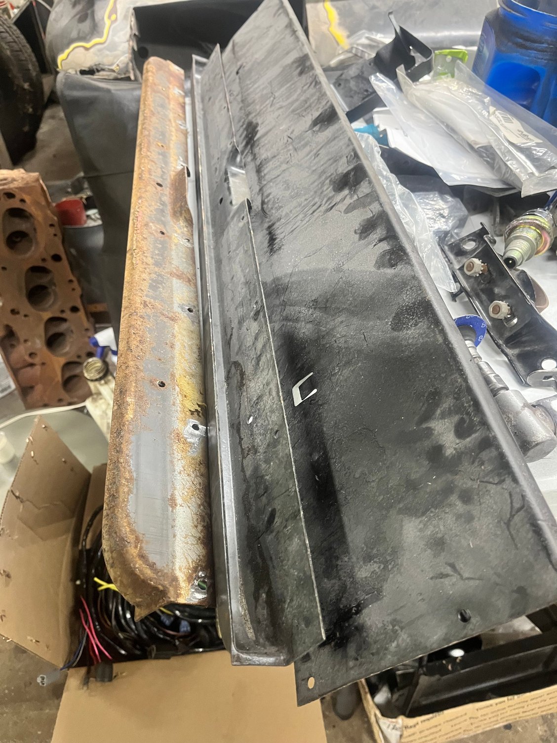

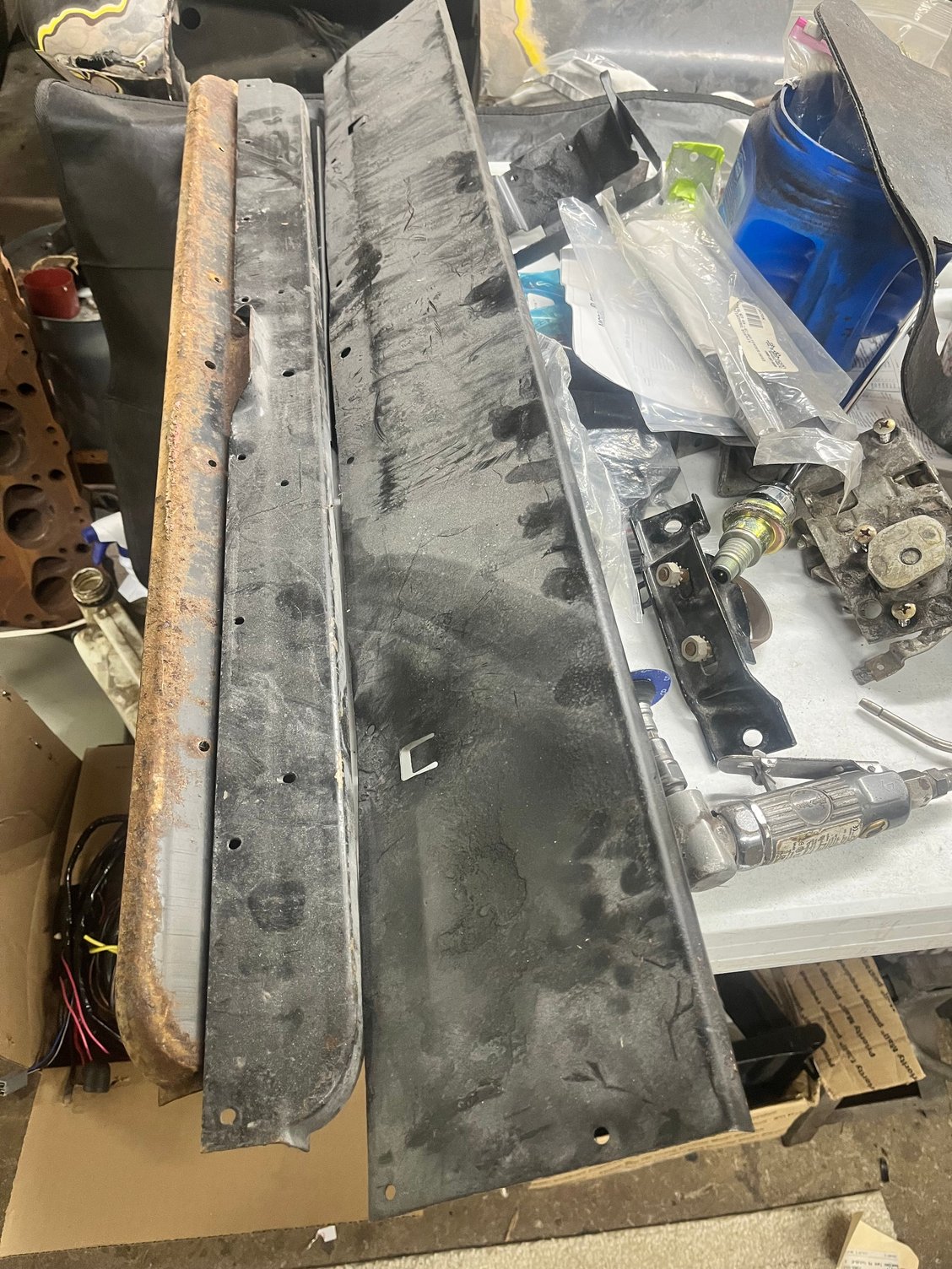

Are you missing both pieces? 63 Coupe had a short piece about 2 inches high from one end to the other riveted to the floor and then a second larger piece about 6 inches high that went all the way across also above it.

The lower piece has not been reproduced. The upper piece is available but you need the lower piece to go with it if he’s missing it, I know where there is one hanging in someone’s garage.

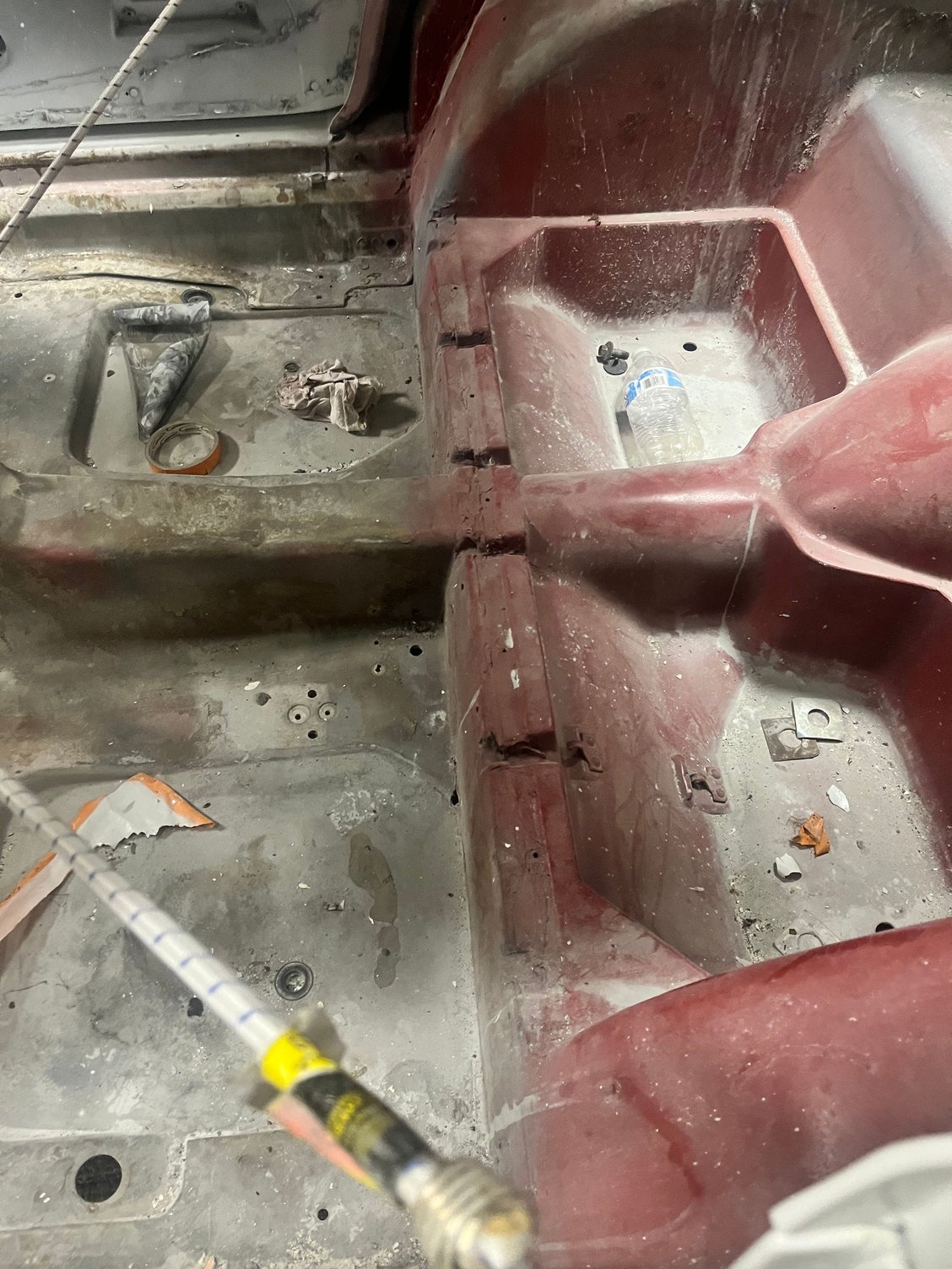

Here is a picture of the two pieces that you need for a 63 and a picture of where it goes.
To Luggage stop

When I got my car, a '67', the luggage stop was there but not secured properly. Also, it looked beat up pretty bad. I got another one from a Corvette Vendor. What I did, was while the car was on my lift (kwik Lift), I put a level across the fiberglass area where the L/stop goes. I jacked that area up from underneath to where there was no sag in the fiberglass floor pan area. I then drilled and installed bolts with heads that were really shallow, can't remember the name of the bolts but back then John 'Z' had recommended them for that particular area. You just can't buck rivets in that area properly with the body on the frame. I placed the bolts from the outside under the car and secured them with self locking nuts and washers inside. Since there under the carpet, there out of sight. Using the factory manual, I tried to use the existing holes but also added a few pop rivets in the end. It made a big difference in the ride quality.

I used weld bolts and nuts in place of the rivets. I added 3 layers of glass since my car got a different backend and I was worried about the thickness and not enough rivet head to hold forever.
