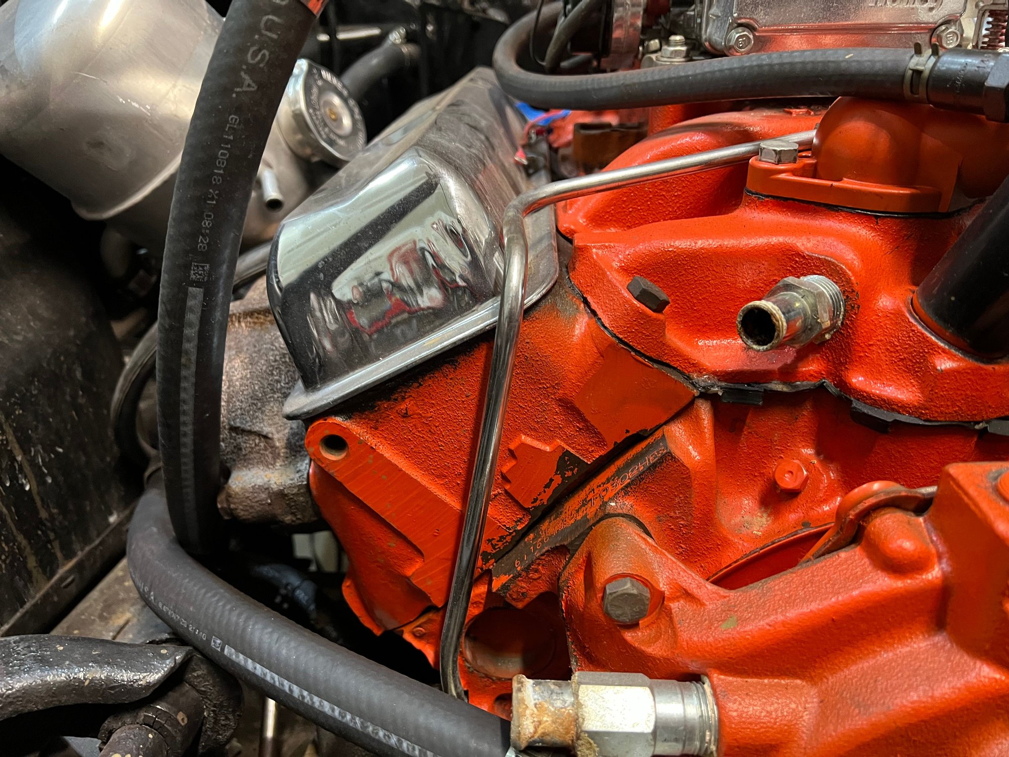

When I bought my 1966, I realized it was going to be a project for my dad and I to work on. There's plenty to do, but I got into a discussion with a co-worker about what type of heads I had on the engine. I had verified that the block and the tranny are numbers matching, but knew that the carb had been replaced. Well, from the pictures below, these are the head markings on the heads that I have. They don't match and without taking the valve covers off, I am assuming that neither one is stock - but I could be wrong there.
Passenger Side Head
Driver Side Head

The heads on your engine are 69 on up heads.
the 461 heads came in both 2.02 valve and 1.94. I don't see 1K

The end symbols on your existing heads are definitely different. I don't know what either symbol represents but I'd hazard a guess they are smog heads.
$1000 is too much to pay for double hump heads. Something in the range of $250 - $400 feels more appropriate. For $1000 you can buy a brand new set of heads which will outperform the old double hump variety and they come with a warranty.

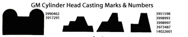

Here's some numbers that you can research without pulling a valve cover.
Ray

Those are late model heads on the car. I think I have a set of 66 dbl hump heads all redone.

Given the end symbols and accessory drive bolt holes, I think it's more likely those heads were cast in 1974.
