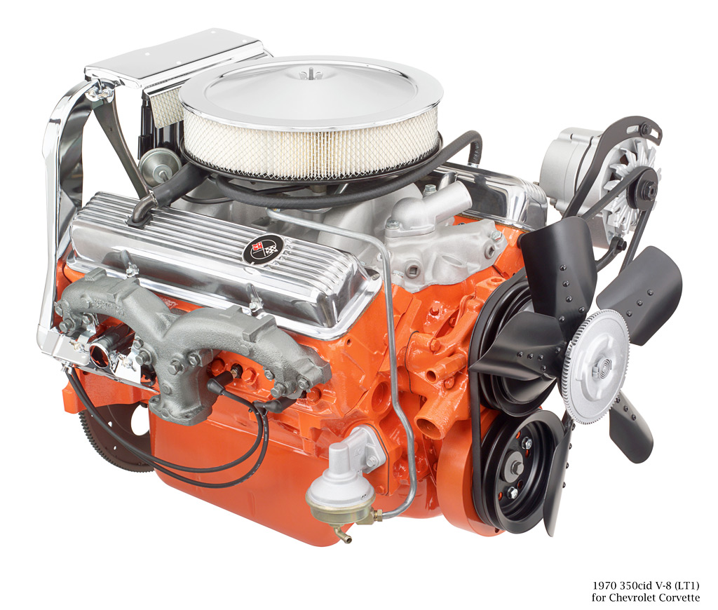

just dress the engine to look like a LT-1

Mike, as Keith mentioned, the 'early' LT-1 engines used those finned covers you see in his post. From 68-on, the rear draft tube opening went away on Chevy smallblocks so the valve covers
had openings in them instead, one side typically for the PCV valve, the other valve cover vented to allow filtered air into the crankcase. I've used them on a number of later year smallblocks in order
to have the 'finned look'.

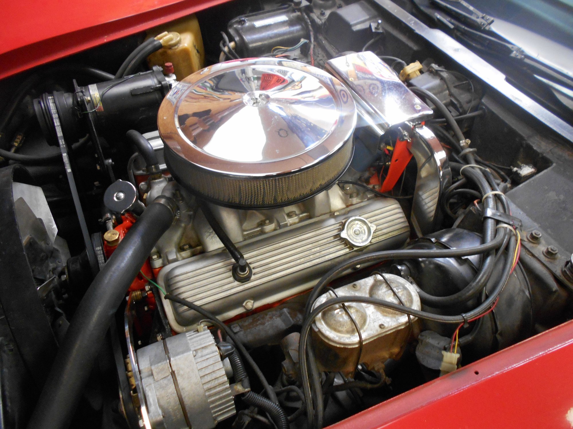

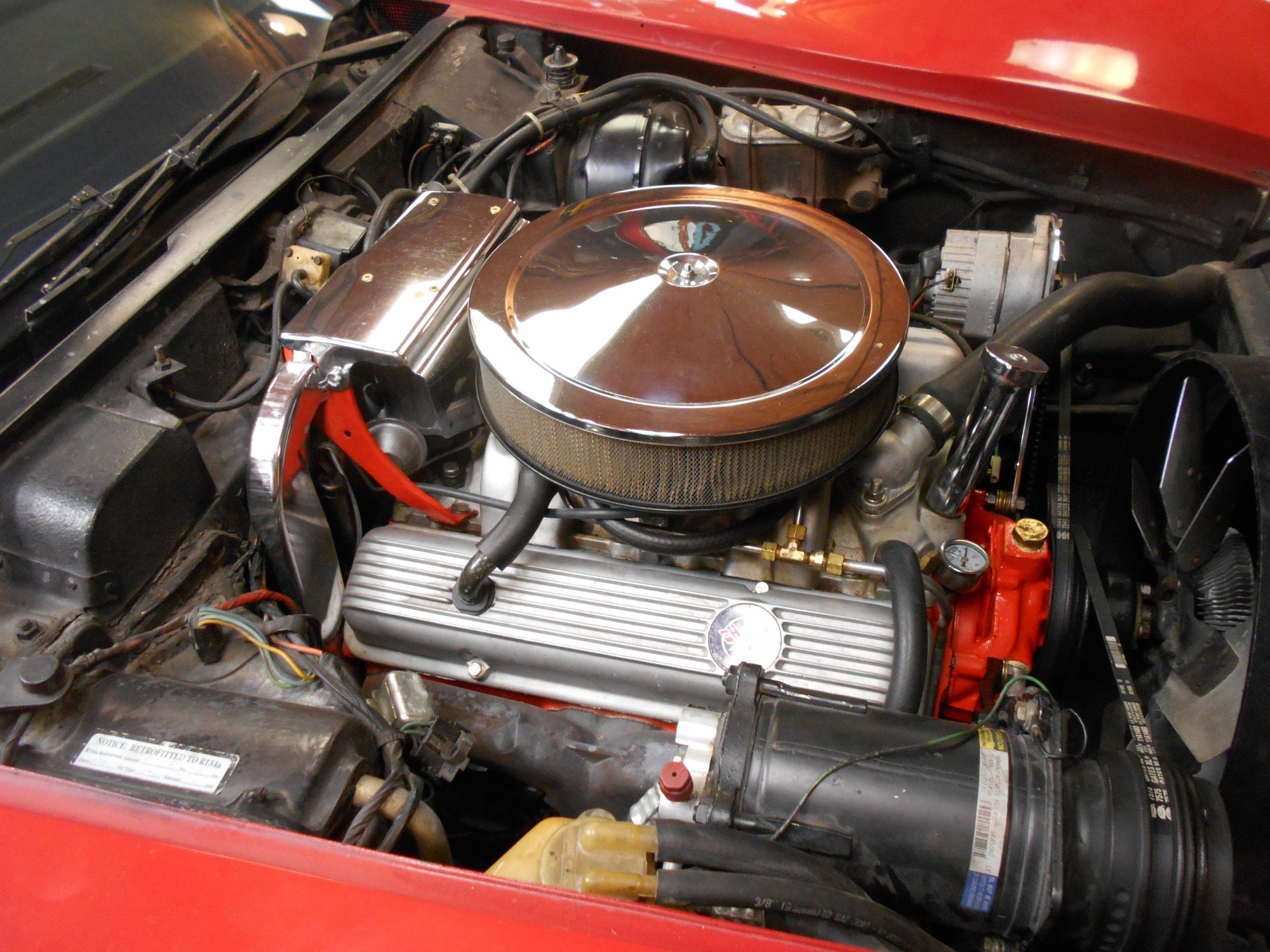

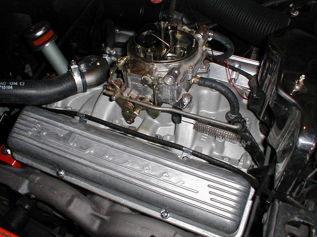

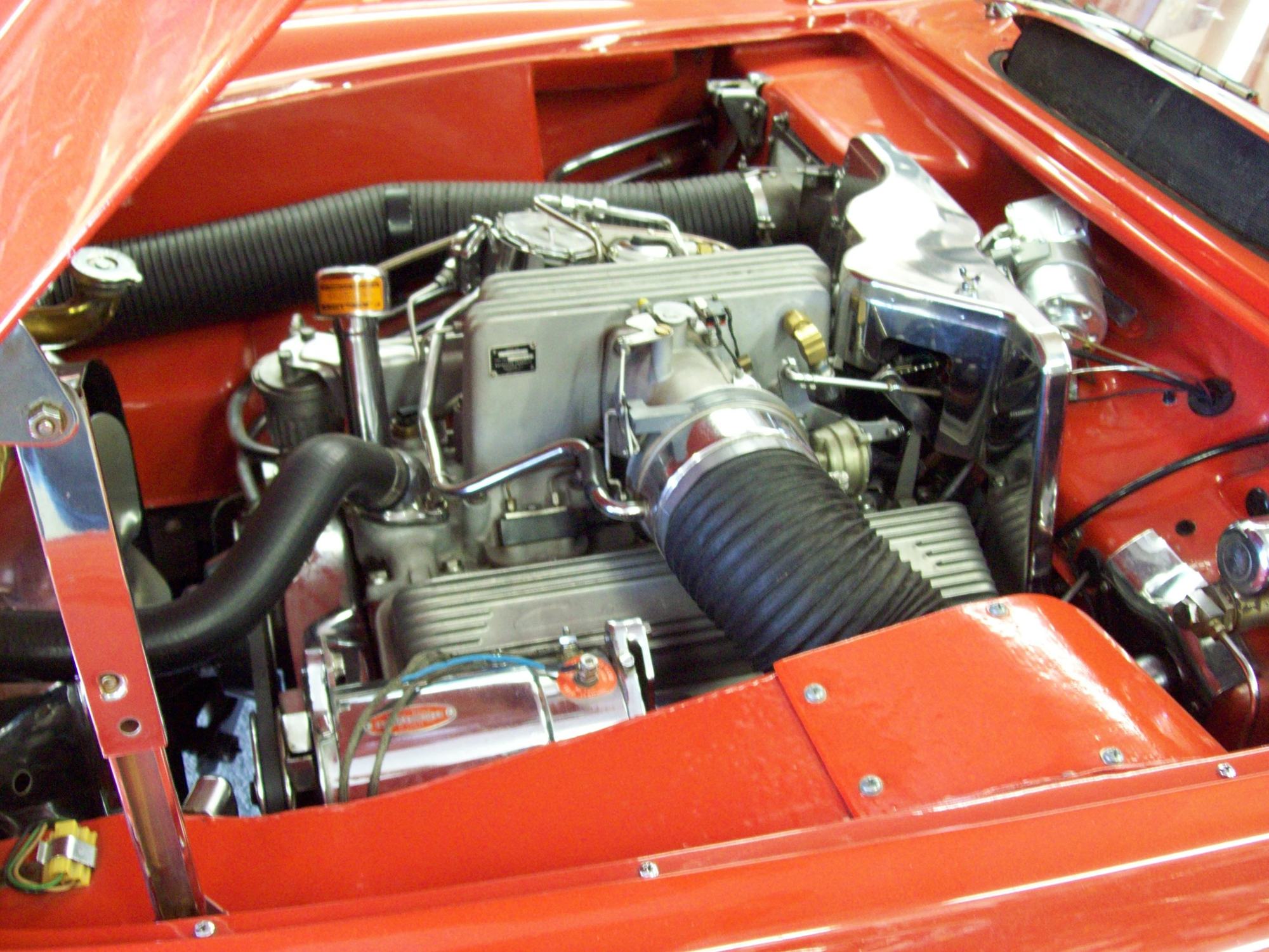

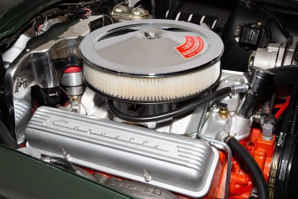

On "period" 56-67 cars, I am a HUGE FAN of the early style, NO HOLE, finned covers. Thus, I go to great lengths to modify, as needed, a later engine which does not have the hole in the rear of the block for crankcase ventilation.
First, I choose an intake manifold that has the hole up front for an oil fill tube-----------------preferably, a GM manifold with the Winters logo. Then I come up with a way to open up a hole in the rear (of the block or manifold) for a PCV setup.
On later period engines, without the hole in the rear, I use the 69-later style finned covers with a factory style PCV system.
For me personally, NONE, repeat, NONE of the aftermarket covers are as attractive as the original GM finned covers.
To bad GM never made them for big blocks!!!
All the below are later engines with GM finned covers. Early covers DO NOT HAVE ANY HOLES!
Small block 400 with a hole in the rear of the block and plumbing to the left rear vacuum port on an FI unit.
Early manifold with oil fill tube and hole in the rear for a PCV valve (baffle was fabricated to underside of manifold).
A 73 model with a 73 400 engine and an LT1 manifold with oil fill tube and factory style PCV system.
