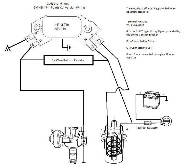

When you say HEI, that translates to two different types of HEI.
1/ The big fat HEI distributor, everything is inside. (Coil, Pickup, Module) Just add 12 Volts.
2/ HEI remote coil type. Small cap distributor or existing Chevy distributor.
Here is a diagram using points with HEI module, and remote coil or HEI remote coil.
Here is a diagram using a trigger with HEI module, and remote HEI coil.
