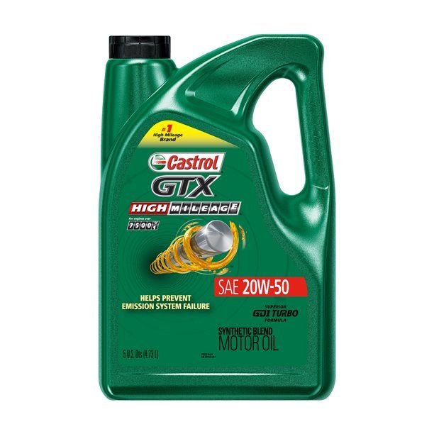

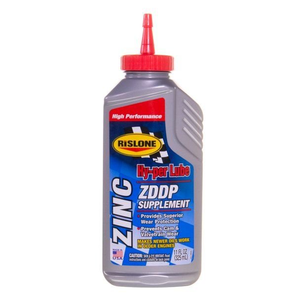

I think that's a great choice for the engine you mentioned. I also mess with old British cars and engines - Triumph & Jaguar mostly. Triumphs are OHV with flat bottom lifters, and Jaguars are DOHC with flat cam followers. After much research, I use Castrol GTX 20w50 High Mileage with a Rislone ZDDP additive. The synthetic blend makes it nice and slippery, 20w50 was originally specified, High Mileage gives the oil seals some juice, and the ZDDP addresses the flat lifters/followers.
Not that anyone asked, just contributing. BTW - I use full synthetic Mobil 1 in modern, non-vintage engines.
