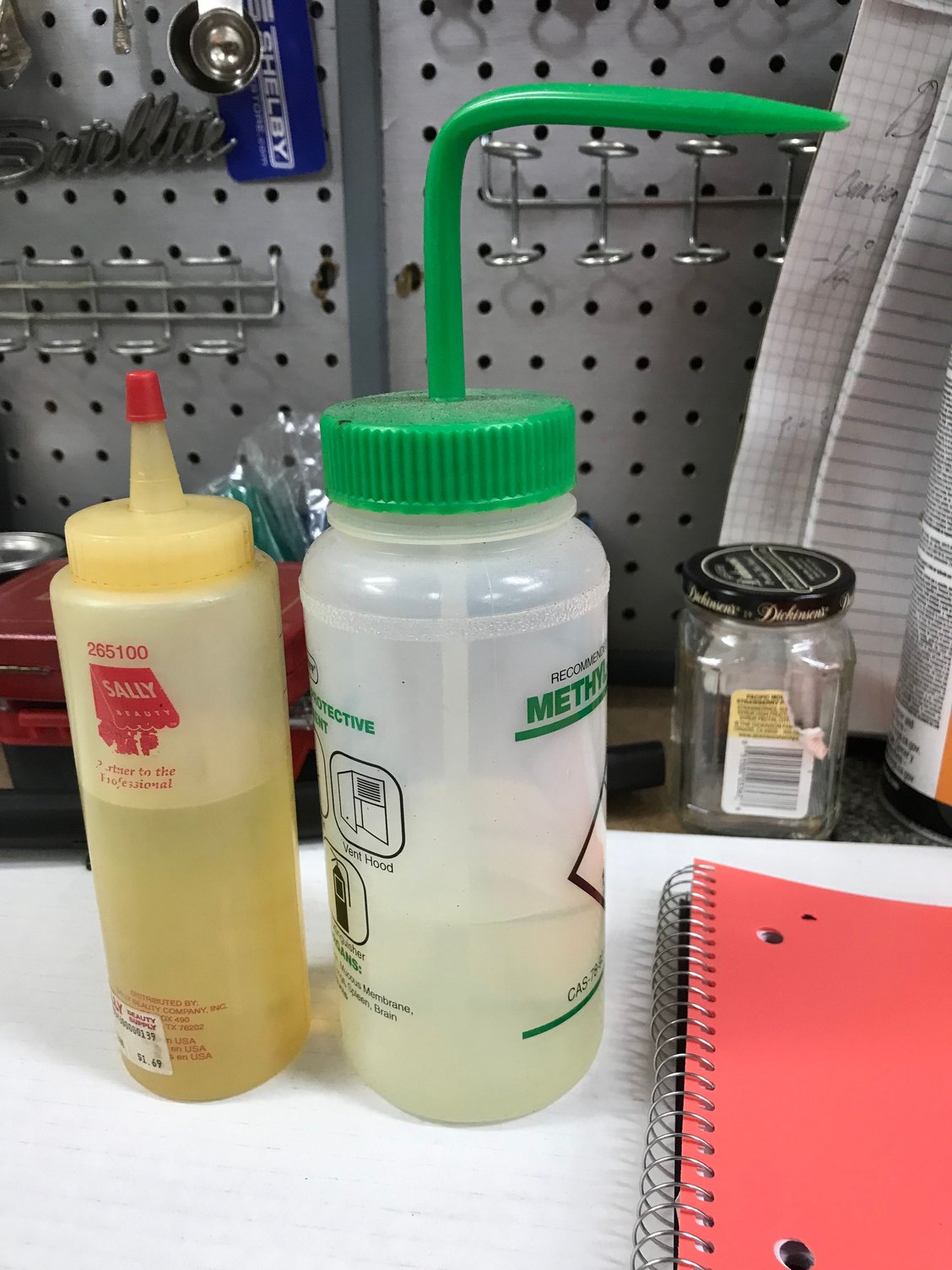

Get one of these and fill with lawnmower can gas and squirt some in the center carb bowl vent and a little in the carb throat. Pump the throttle 3 times and start the engine. I fill the bowl in my car until it begins to drip out of the boosters but if you squirt a little down the throat that probably is not necessary.
