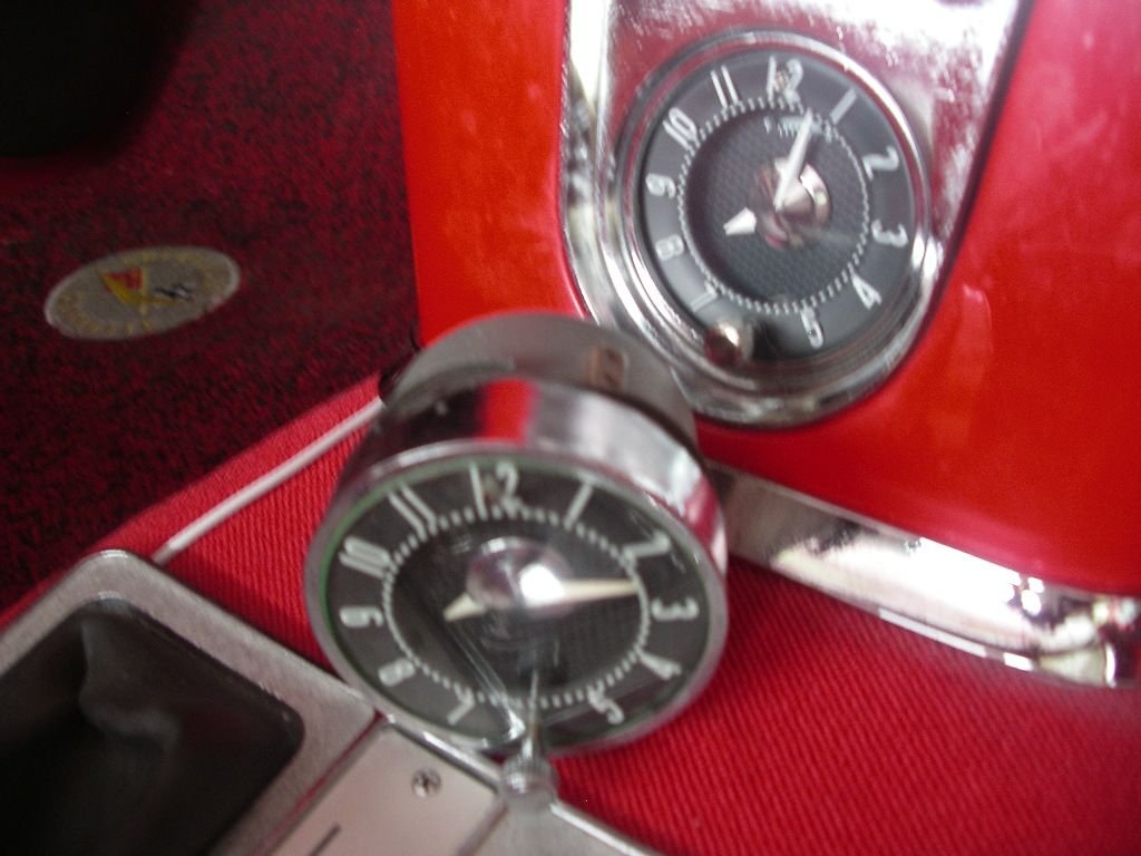

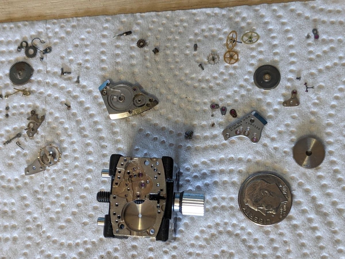

Clocks in old cars are something that shouldn't work....hard to explain
I wear a wrist watch from the 1940s, it's a fine instrument, and keeps on ticking. Lots of jewels in it. They're a lot of fun to work on.
The 62 Corvette clock (this is actually from 61, I think) is quite a different beast. This is mine, I almost got it to work, but not quite.
