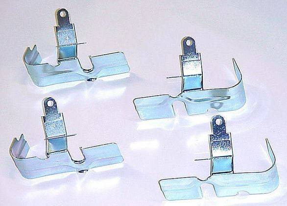

Originally Posted by CorvetteMikeB
The factory heat shields are nowhere to be found. I have a 350 Blueprint engine with vortec heads.
Here is a set currently for sale:
sbc heat shields

And here is the earlier style for ram's horn manifolds:
rams horn heat shields
sbc heat shields
My 350 Blueprint Engine does not have the needed support for these brackets. I ordered some 1,800 degree heat resistant boots from Summit Racing. That should more than do the job of protecting the MSD spark plug boots.
Did you notice the link to the traditional style of heat shields which I posted? If you run conventional rams horn manifolds, they are what you want.
Thanks, Jim. Bought these boot/wire wraps on Summit Racing. Good for heat up to 1,800 degrees. Comes with S.S zip ties for extra security. Metal is a conductor of heat and makes a poor insulator.
