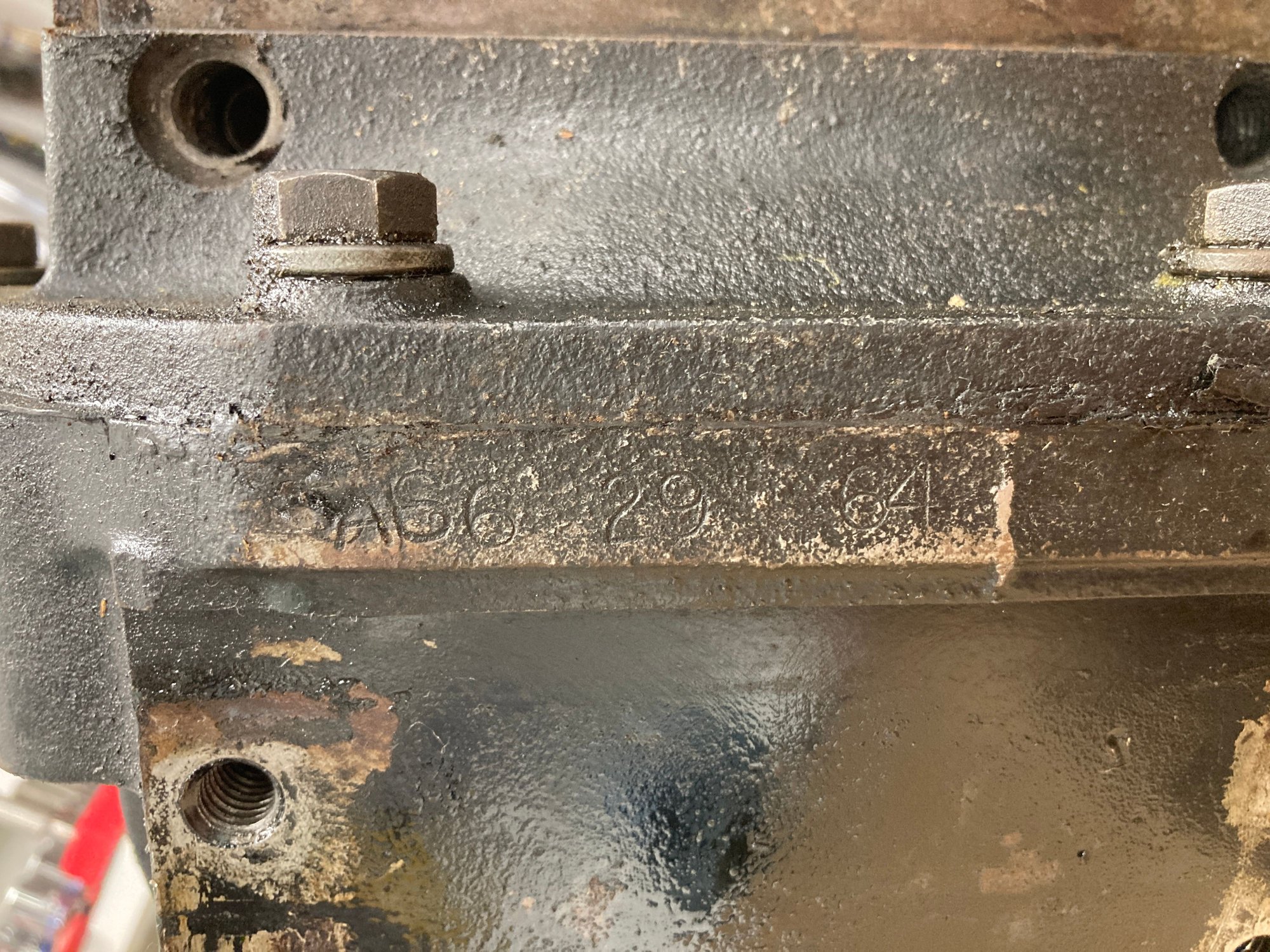

Well, that was a good 3-4 hours of honest hard work. It's been probably twenty years since I did this but was fairly straightforward and I didn't need to refer to the manual. Not bad for mid seventies I guess. I should consider myself fortunate in that I got the crossmember out in about 20-30 minutes. I kept spraying Ace Hardware Lub-E as I worked on prying it loose and it soon popped out. Not sure if I did any prep or pre-lubing last time I assembled it to make it easier this time but will look to see if there's any current recommendations before putting it back in this time.
This is an open 3.70:1 and I'm changing to a same ratio posi that I'll be building myself. I know there are some great resources here on the forum that I'll be touching base with as I go.

Since the diffy isn't original to the car, I'm just going to clean it up & sell it on the forum after I replace the front seal which may have been weeping. It's an open 3.70 for a 64 so if anyone's interested, PM me or wait for it to appear in the classifieds.
