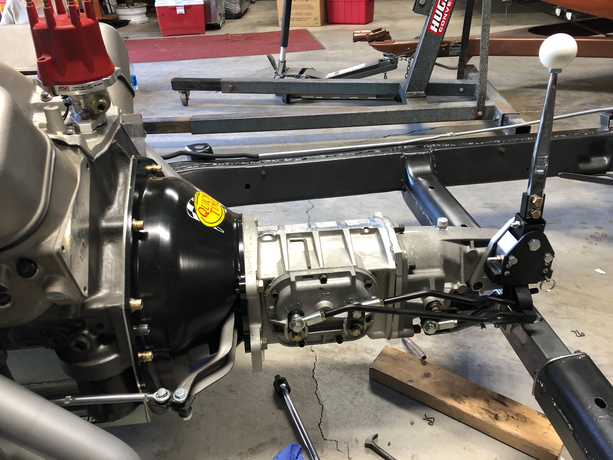

I installed one on a ‘69 Camaro with a 427 in it. Worked fine with factory starter and then a gear reduction mini-starter. All 168 tooth flywheels on V8 engines had staggered bolt style starter unless it was bellhousing mount. Planning on racing the car? If not, I’d do a clutch and steel flywheel and run stock bellhousing. That’s the plan on my restomods ‘64 at least. I have a Lakewood on my small block ‘69 Camaro, but it gets beat on more and at a higher rpm than I envision the Corvette.

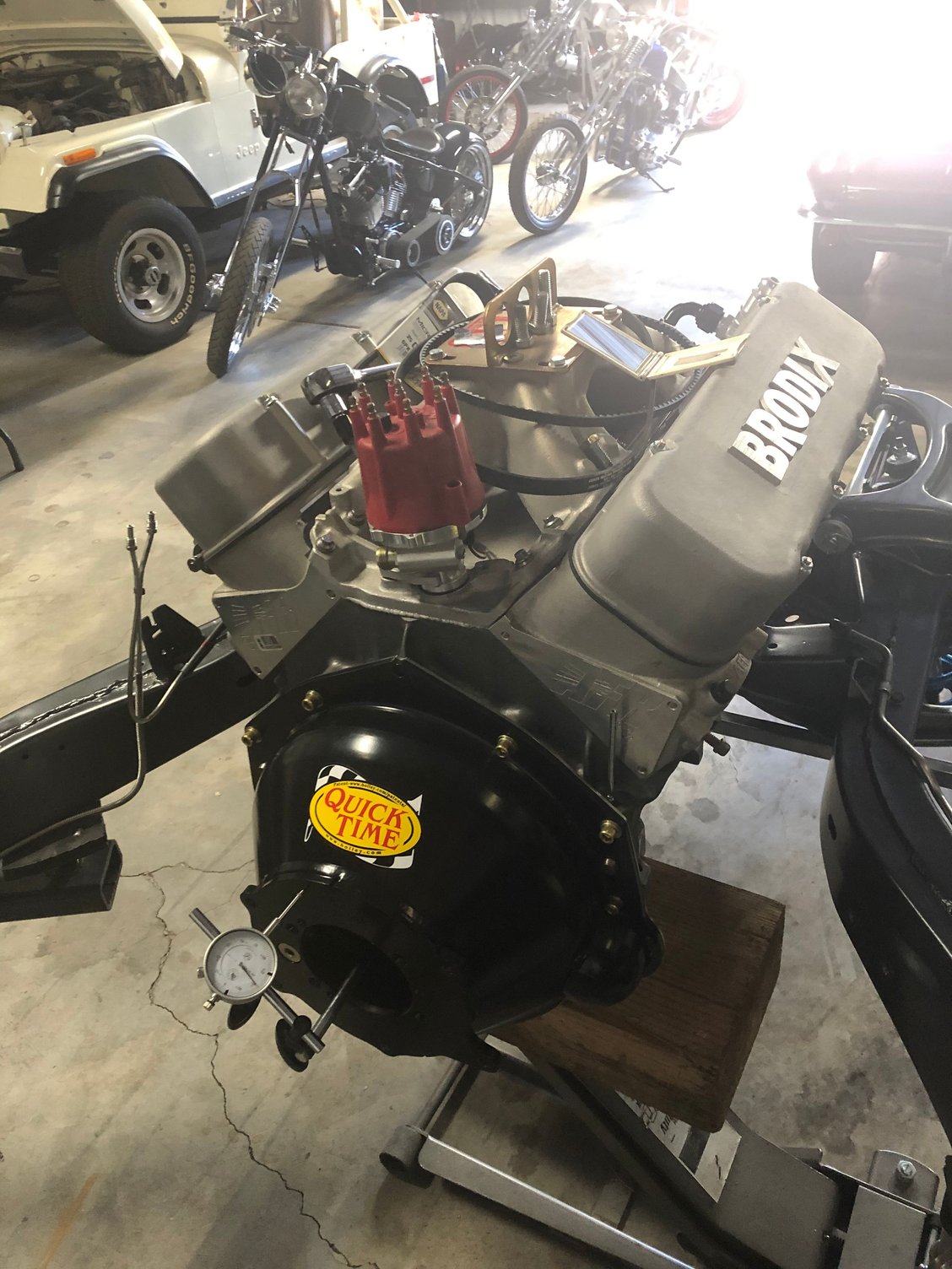

It would be advised, if not already done, to check the bellhousing for excessive "bore runout" and flange squareness.

I agree with always checking the run out but that is one of the nice things about QuickTime - they have a reputation for high quality and typically being centered right out of the box. I have a QT on my Cobra and it checked out fine for my Toploader. Of course if you have to run a pilot bearing to maintain an aftermarket transmission warranty, it’s possible it may need a little fine tuning.

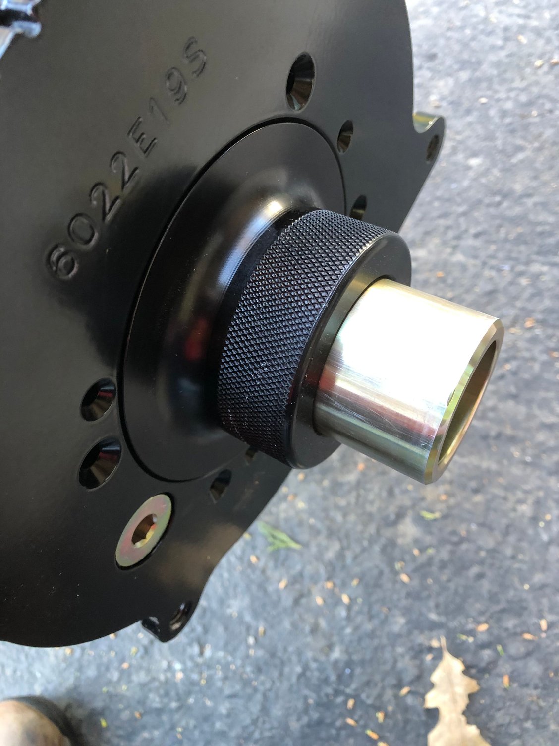

The Quick Time bells are really well made. The run out was fine but it did need an offset dowel to be perfectly centered . This tool is awesome

Is the tool bolted to the crank and then you align the B/H with the offset dowels and lining up the black portion to center it ?
Yep. The tolerance is so tight it is either go or no go.
