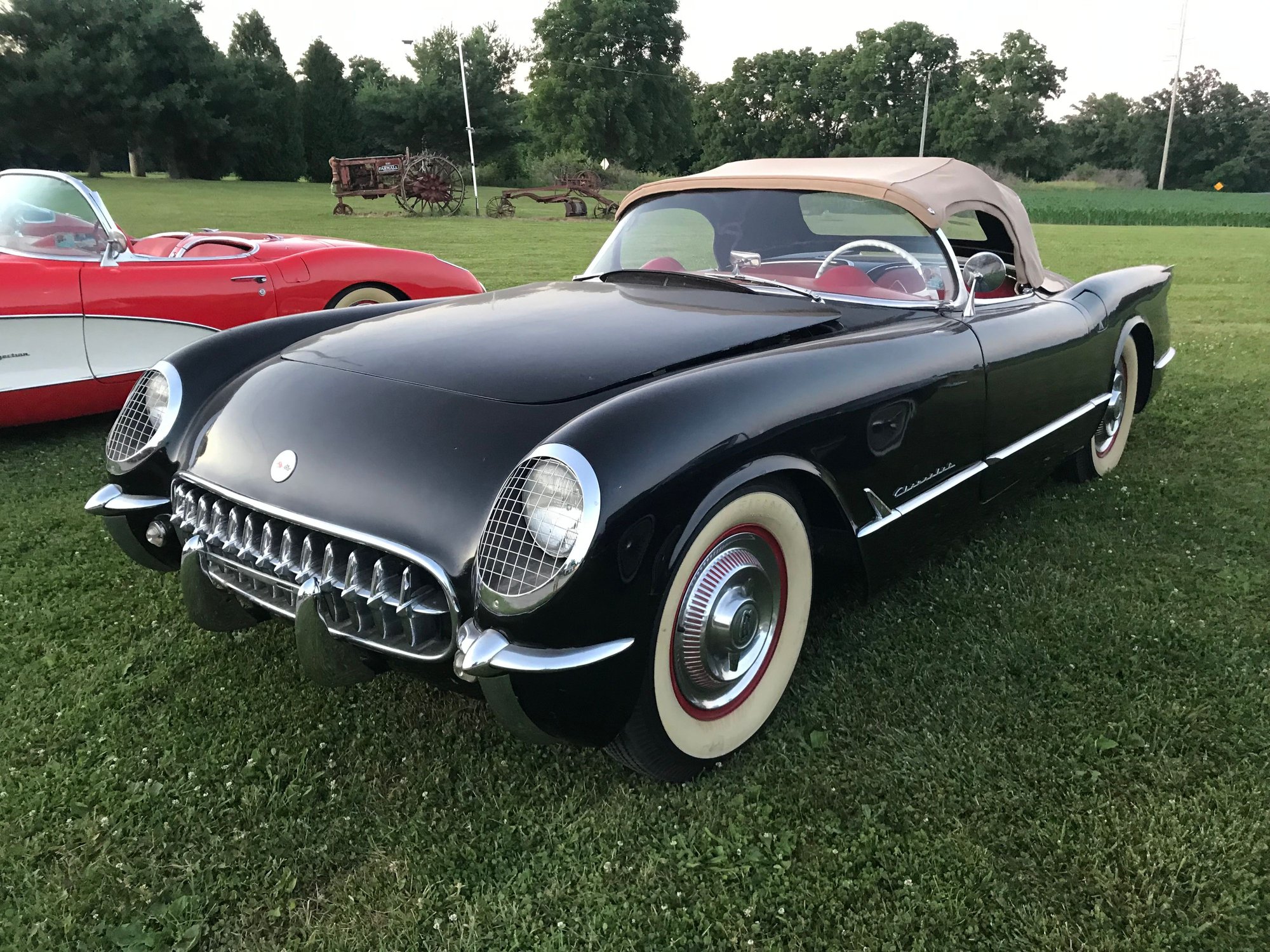

So “the wife” saw a ‘54 and “somehow” we ended up with one. Never thought I would be lucky enough to have one old corvette much less two. Always been a C2 coupe guy, but the 54 is very sexy.
The car needs just a small bit of help, starting with why does the drag link rub on the generator? Anyone have an idea where to start?
