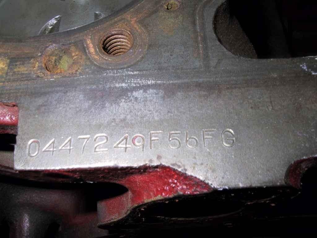

Mapman, it depends on how you interpret this statement. Some stamp pads, actually all original stamp pads did have some individually stamped characters, but this is because the gang only held 5 characters at a time. You will see in the photo an original '56 stamp from a '56 that I restored years ago that the first five numbers are straight as an arrow, the sixth and seventh characters, in this case 49 were stamped individually. Additionally, many times you will find the last letter of the suffix, in this case G is also stamped individually. So it depends on your interpretation of the JG statement. I don't believe it was stated this way to imply that ALL letters and numbers were stamped individually, just making it clear that SOME of them were stamped individually. My personal opinion of the OP"s original post and photo is this is in no way an original stamp. I can't say that it isn't an original block based on the information and that it might be an attempt to re-create the stamp after a decked rebuild.

I might also add, take a close look at the fonts of each. As an example, compare the 6 to the OP's photo versus the photo provided and you will see very different fonts. The 6 and 9 have very clear "straight" legs whereas the OP's photos on the 6 curl up and around which is not seen on typical factory original stamps.
Panama 58
I don't know if image below is of an original pad - would need to examine in person. However, NCRS Technical Information Manual for 1956-57 does state: "Some original engine blocks appear to have been stamped individually." (emphasis mine)
I agree, typically you expect to see these stamp pads in a 5-1-1-5 pattern just as your example shows. Five characters in a gang stamp, then an individual stamp, then another individual stamp, and finally a gang stamp of five characters - 5-1-1-5. NCRS Tech Manual details this 5-1-1-5 pattern as typical, so I believe they do mean individual stamps are possible.
Just saying, other possibilities. Seems like owner is not cooperating, so perhaps moot point.
