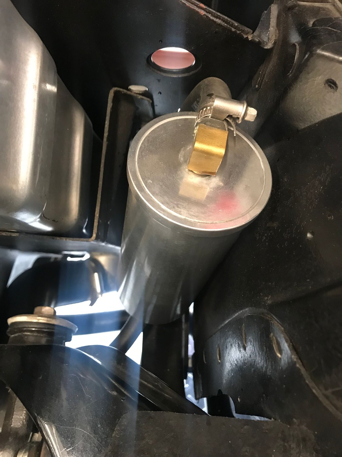

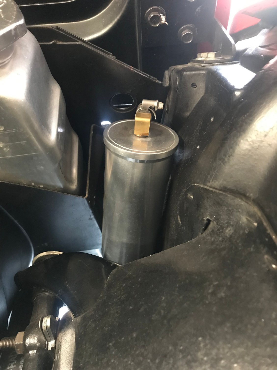

With the former engine in my (67 BB) car (a 396 bored out to a 427) running hot and hotter, I was desperate to help out the cooling system and so installed a recovery tank. I never thought about installing a plastic recovery tank and just looked for a metal one. I found one I was very happy with and installed it in the general area you describe. Even though my new engine runs cool I re-installed the same recovery tank. I will bring the car down off of the lift later this week to work on it and will take a couple of pictures of where and how I installed the recovery tank. It works great, looks good and is unobtrusive. I looked at a bunch of tanks before I found one that fit well in the area I intended to install it. I hope you find a plastic one that fits the bill, but if not . . . C.J.
I was finally able to get around to adding a few pictures so that you can see where it is and how it is mounted. Hope this helps.
Here is a link to the one installed in my car.
https://www.becool.com/product/vente...ut-aluminum-be
