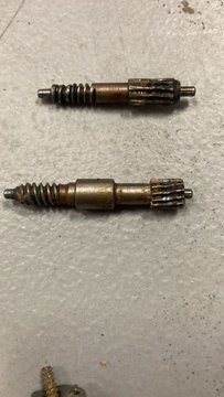

Bud, It looks to me like a cluster removal and gear replacement, cleanup and re-installation. My speedometer worked fine, mileage and Odometer indicators did not work.....
The Clock: Remove the right side radio panel then release the 2 clips behind the clock........I sent my 65 out for a quartz movement (Disconnected Battery). Other's will assist!

that's not a job you want to repeat in a few months. I would take the cluster a known rebuilder and have them go though it and have the speedo and tach calibrated after the speedo rebuild. you can possibly swap out the worn gears but murphy's law says something else will not work after you put the cluster back in
